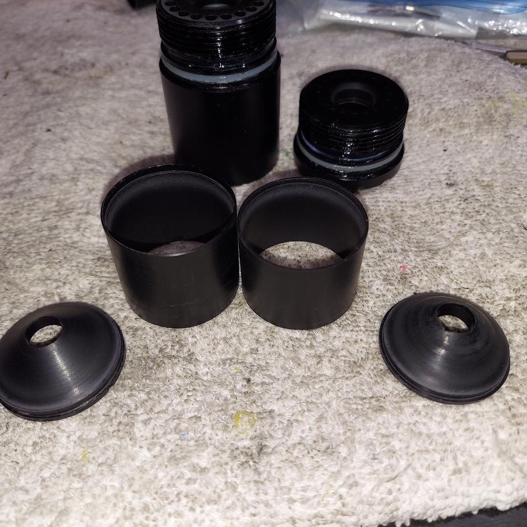

Found the OEM soda straw tube in the LDC a bad design straight away ... Built myself some custom baffles and now soooo much quieter.
I presume this is turned delrin?
I think I'll start with 3D printed parts just to see what is effective and what is not
Being a good or a bad design decision aside, Skout does deserve a credit for robustness, fit and alignment of the moderator
The "soda straw" in the last part of the moderator is just 0,5mm wider than the pellet itself and it doesn't interfere with the pellet flight, otherwise there would be pellet clipping and accuracy would go to hell.
Still open ....
Once the air coming threw last baffle it can expand and exit via center as well radial holes at a much lower amplitude.
Just having center hole as primary exit path would increase the sound signature to a sharper snap, where as now used a low thwhop sound.
And the middle holes?
Between two chambers, did you plug those?
Plugging middle ones would, IMHO, force more air to the shroud and leave less pressure in the front part.
I'm of an opinion that is why they've designed that "soda straw" with such tiny holes on it, so the pressure that moved through holes between chambers wouldn't affect pellet path

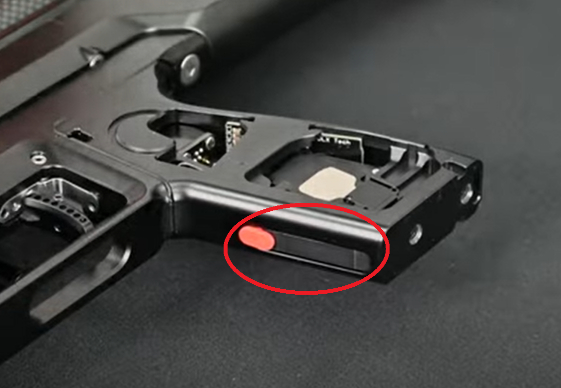

So, I've encountered a first issue...
Battery doesn't charge!
I've tried with two different chargers (one included and a spare from a phone)
Charged yesterday for hours and today for hours, haven't moved from 40% which lady voice states when powering on
Anyone encountered this before?
I'll have to register the product first to get help from Skout, just asking if anyone had this issue already and what the solution was?
One thing I didn't know, I can't power on the rifle if hand grip is not placed back
Maybe I've figured it out, I hope, I'll see in a couple of hours
It seems that my Epoch is missing battery holding tab:
So, when I remove the grip, there is nothing to keep the battery pressed against the terminals so it can't charge
Blue LED lights up regardless of the battery being inserted or not.
That probably explains why I can't power it on without grip, no contact
Upside to this (if it really was the issue and now identified) is that battery can be changed, maybe it some kind of a standard format which can be easily acquired, I'll check that later.

As too the soda straw tube in the LDC .... As pellet passes threw it, air ahead or pellets gets pushed out of the way and with the close proximity of pellet to tube there is instability created in doing so.
The shroud is sealed and it will only absorb some air volume if passages are open allowing it to happen. I have not altered any of the radial holes within the LDC sub parts.
Yesterday I've used 60% of the battery in a matter of a few hours. Granted, I was testing the rifle and shot a lot but still, I've expected it to last longer.
I wonder if a poor connection is impacting your battery life, although I don’t see how…I’ve only charged once in 4 months and 500-600 shots in .30 cal
Yes, IME with RC models, poor connection can impact battery life.
I'm no electrician but from what I can remember being told a long time ago, poor connection uses more current.
