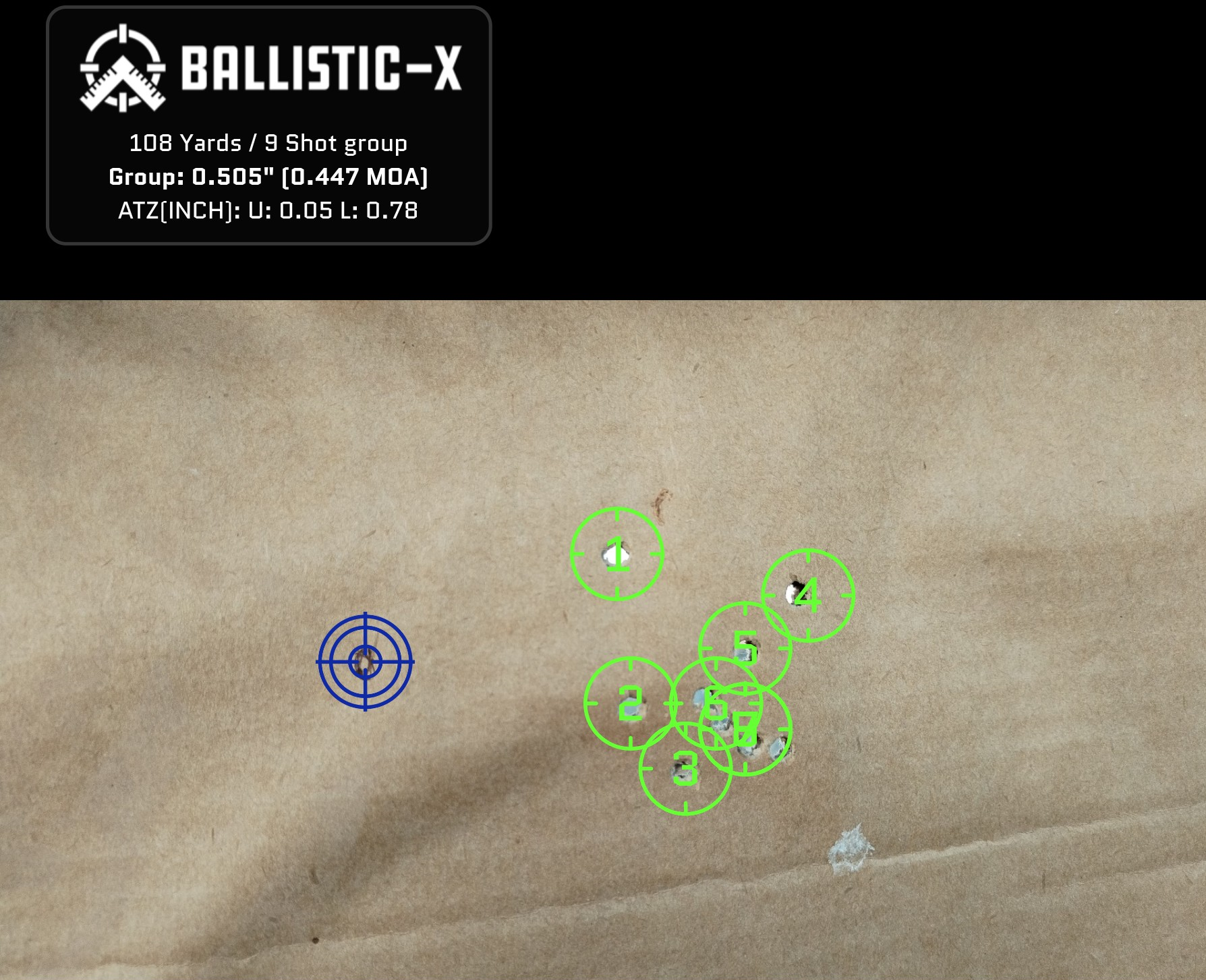

shooter from Saudi Arabia:
FX M3
windy day, (about 25 km/h)
Using ATP King 40gr
Speed was 990 fps
Distance 108 meters
Setting:
I used the the 8.5 hammer
Reg pressure 165
Power block
With the 800mm barrel superior heavy

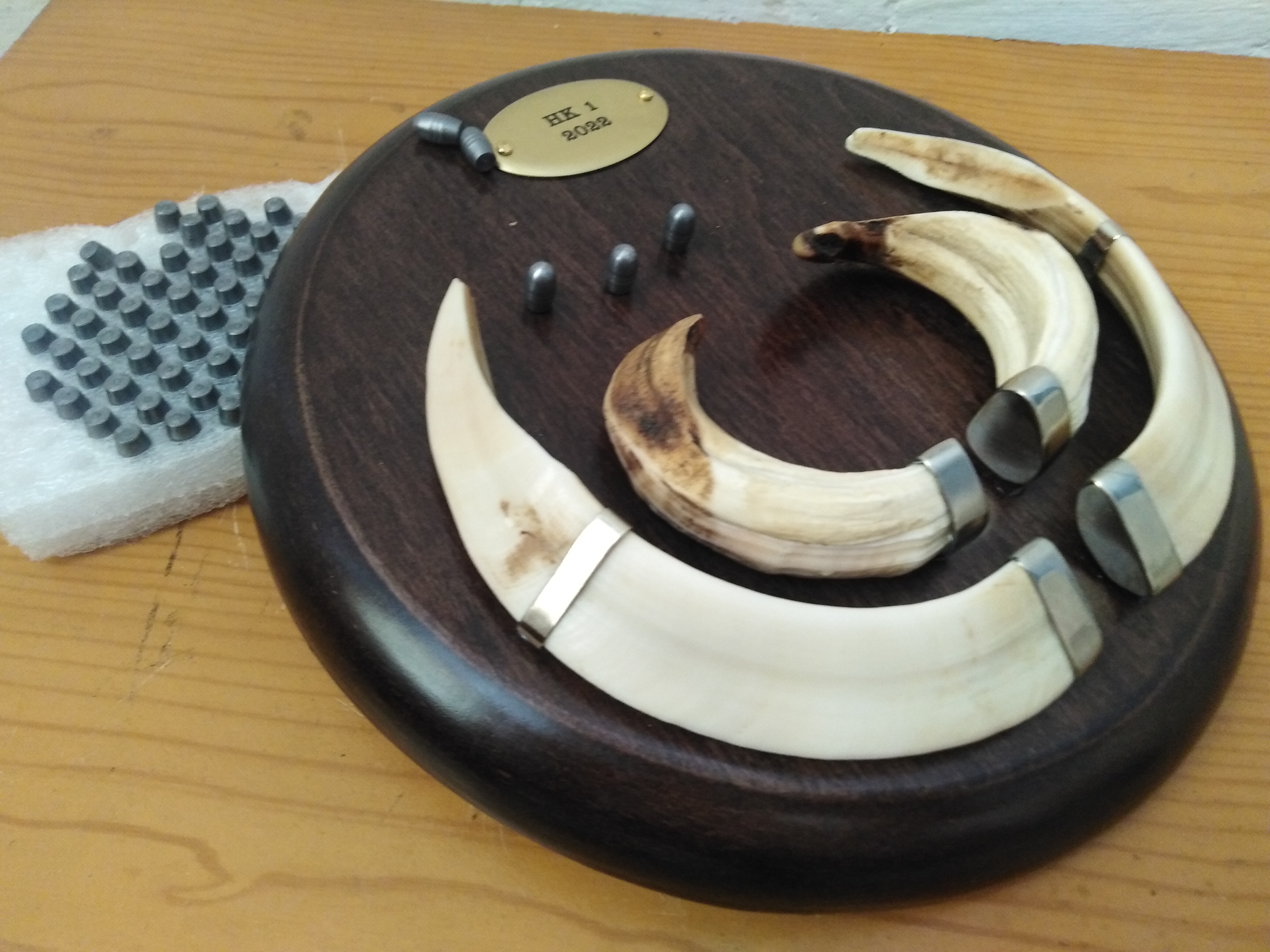

.25 ATP Slugs for Huben K1 is 50gr , Length - 10.8 mm 0.43", BC G1 0.17 (or BC 0.21 for ATP Smooth ), diameter - 6.45 mm .254 . Recommended muzzle velocity from our users 300 m/s 980 fps
Oure customer used his Huben K1 and this .25 ATP slugs at MV 300m/s on hunting wild boars weighing up to 100 kg:
