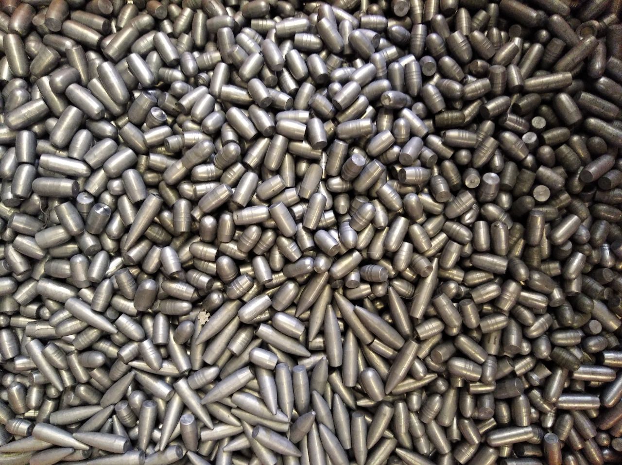

Just so I don't mess around like meracdo, I'm adding a photo of my "lead trash can" and this is only the top layer, it is already quite high and heavy.

Altaros, after seeing your lead scrap pile, and knowing you use a lathe to make slugs, it occurred to me that experimenting with slugs like you have done by using a wide variety of shapes, weights, and diameters would definitely help in finding the optimal combinations to work best for long range.

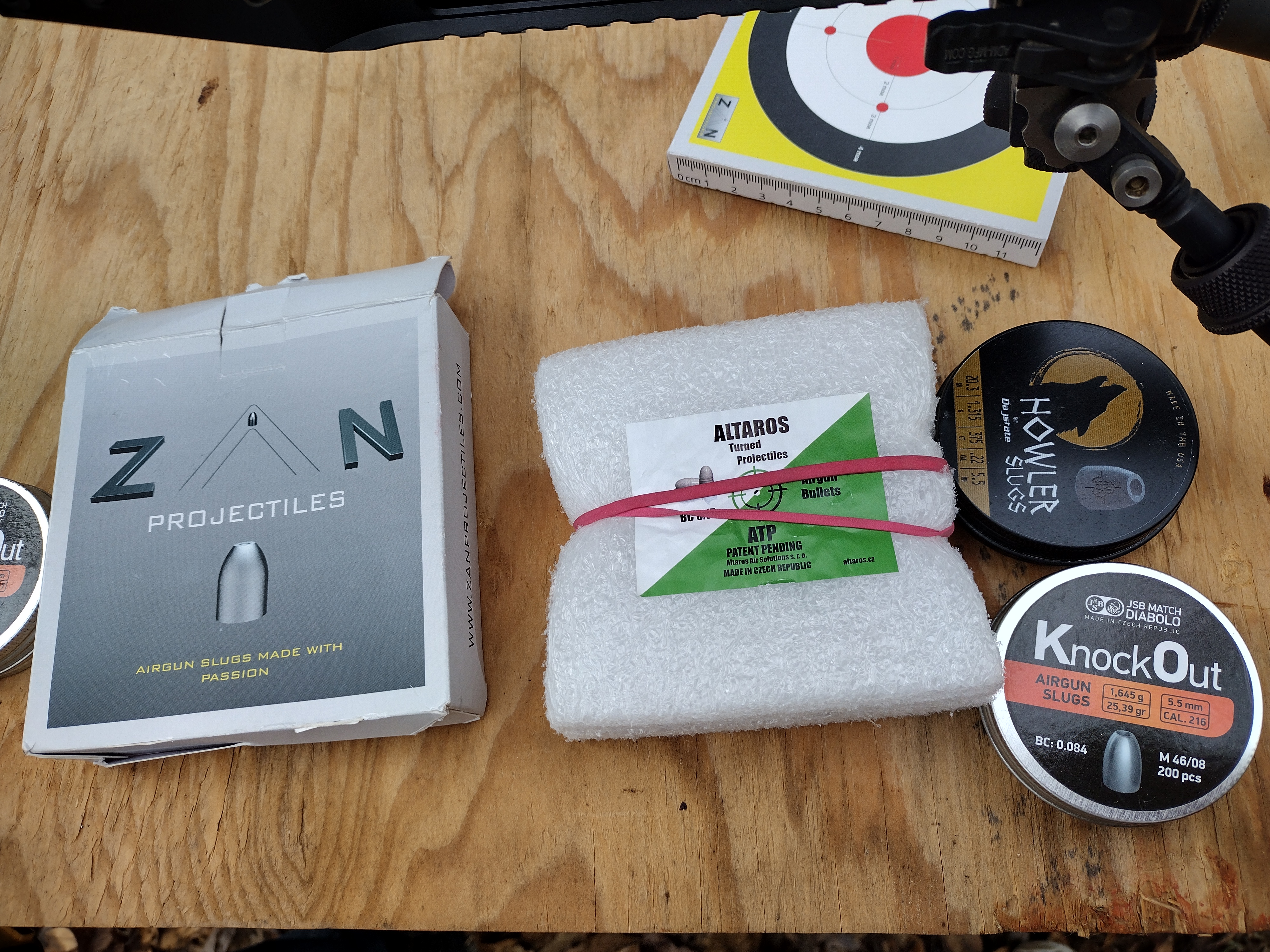

Well we shot these today ... out of a Prophet tuned for HP and a low power AGT Uragan Compact (also custom tuned). We also shot with the same airguns the Zan, Knock Out JSBs, and the Daystate Howlers. I'll post a vid up when I get to it.
Before the test, see Altaros tips on speeds and barrel cleanliness.

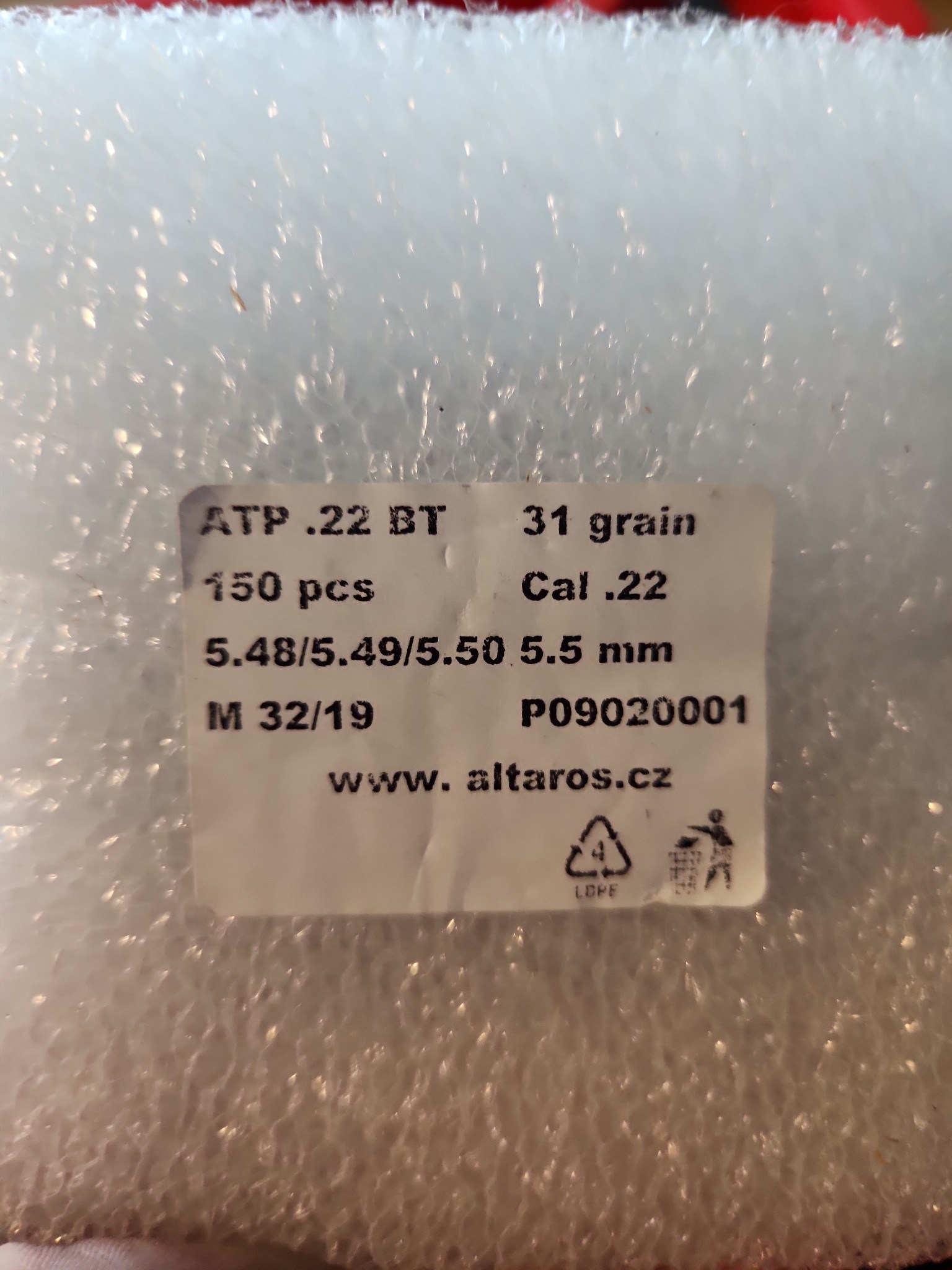

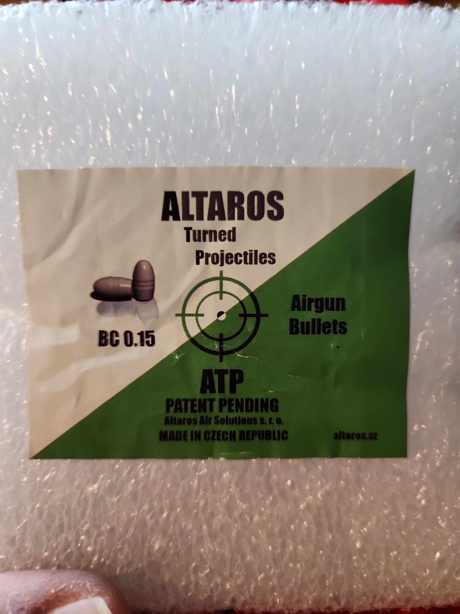

considering that I am on a family vacation abroad for the first time after 5 years since the birth of my daughter, so until I return, I will not get bogged down in a deeper discussion and will only tell the facts.
1) I would like to know from whom the used ATP slugs were obtained, because according to the old label and the text label alone, it is a production from 2020 9 months, i.e. more than 2 years old, and at the same time it is a test package, which is already more like a year he doesn't sell.
The reason why I say this is that this package contains slug sizes of 50 each, size 5.48, 5.49 and 5.50 mm.
The Prophet rifle uses a LW barrel, which according to the manufacturer has a tolerance of +- 0.02mm on the inner diameter. If 5.48 and 5.49mm slugs are inserted into this barrel, which will have a larger inner diameter (still within tolerance), simply the wrong slug size, then exactly this will happen. Slugs will whistle in flight as they won't rotate at all due to breaking out of the grooves.
It is necessary to use the correct slugs for the barrel, both in terms of maximum and minimum sizet. This is not my excuse or fabrication but a simple fact who knows experienced airgun shooters with slugs, :
The size of slugs 5.48 was functional for only one rifle we owned, the original Vulca with a CZ barrel, with other rifles, including the M24, when using 5.48mm, the described effect occurred and we cannot talk about accuracy at all, which does not mean that they do not work in the correct size of the barre.
in this case, it doesn't matter how the test was performed, because slugs with the wrong diameter were used. It is one of the reasons why we no longer sell slugs smaller than 5.50, since most barrels (not all) start at a suitable slug diameter of 5.50 and larger diameter. For those few customers for whom a smaller slug diameter would be more accurate, it makes no sense to risk using 5.48 slugs in an unsuitable barrel. These customers can use this larger slug with the difference in accuracy being small, but it doesn't work the other way around as the aforementioned video from AtlasAirgun shows.
But what is a colossal nonsense is the way the test was carried out,
For testing when trying to find maximum accuracy, it is essential to have a cleaned barrel and shoot at least 20-30 slugs of the same type, brand and diameter (simply from the same package or batch).
Every benchrest firearms shooter and even experienced airgunerst, such as Tofazu or RusBear, know this information and you can find it on their YouTube channel.
if I use the threading again so it's like testing a new tire, but instead of the clearly indicated pressure to which the tire should be fill, I fill it a low or a to high and then I'm surprised that it doesn't work optimally.
it is inappropriate to test new slugs on precision without cleaning the barrel, but even more nonsense is to always put one type of slug in the magazine and then another type next to the other and nonsense about laboratory conditions will not change that fact.
