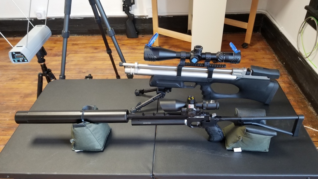

This is mine
Them are some real sick looking PP 750s, I bet they are super light
Kayaker Do you have to single load ? I bet that's a one off rear stock, Never seen one like that.
Mike
Mike, not a single load, bought some new mags from Wes at Air gun archery and fun in Canada to replace the originals. The cheek piece is out of a 2x4 (fir) the rest of the stock I cut strips out of a old sheet of aluminum and had to screw them together because I don't have a tig welder. But I do have a mig welder for mild steel. The frame is attached to the cheek piece and a screw to the pistol grip, can be taken apart fairly easy. I was a welder by trade but retired or it would look a lot different than what it does. If I had all the equipment that I had in my shop I would of given it a whole back end stock in aluminum but just did it in simple form for what I had on hand. It is my pester gun for the back yard but have to get a better scope one of these days lol. So yes one of a kind, glad you like it. Darell
