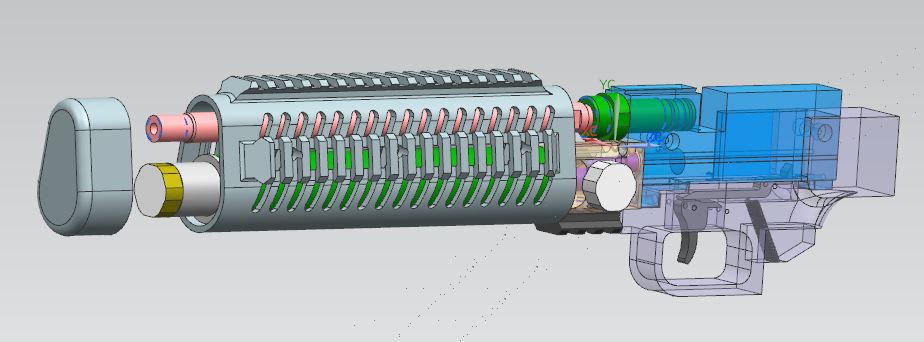

Thank you for the reply! Know anywhere that has something like this for the PP 750 that acts as a barrel band and has pic rails as well? This looks really rad!
I'm looking at getting the barrel bands with pic rails from Airgunarcheryfun, I just have to pic up 5 or so of them and thought that this would asthitacly look a lil more pleasing.
Thank you for any advice!
