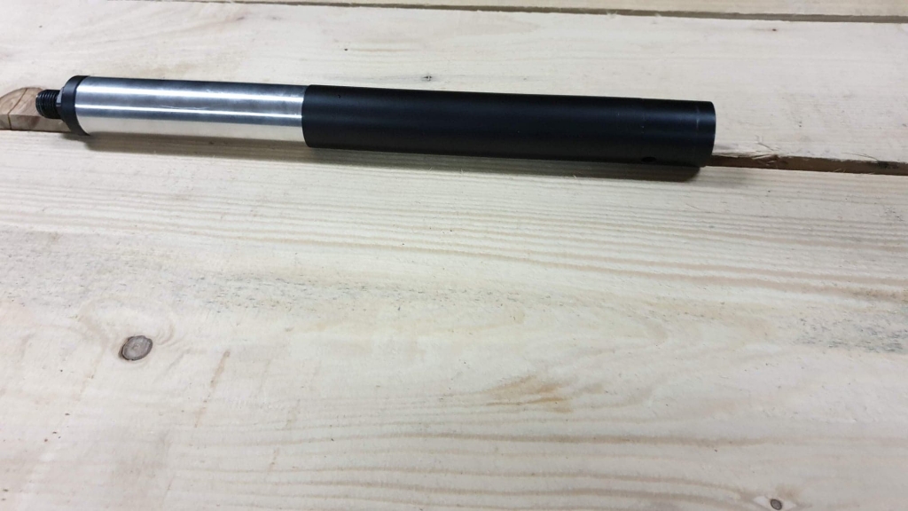

I make some work on it , i'm at this time at 215 m/s with standard barrel and spring, i think i'm near the end with a so shorter barrel, i wait a 35cm barrel and i think go to 30 fpe with it

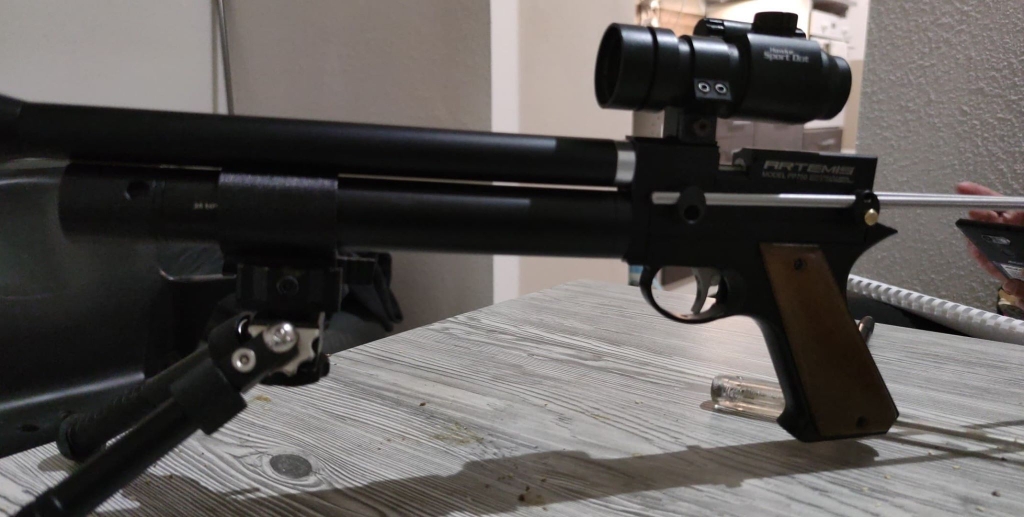

i do same mods than you on my .22 just need to open the hammer retainer near the plenum, added a plenum volume and i'm around 20cc, i turn to 20 fpe at this time, i wait a 35cm barrel to push a bit more in power, like you see i have a tube addon too, i work to make an ar15 adapter to put a foldable stock
