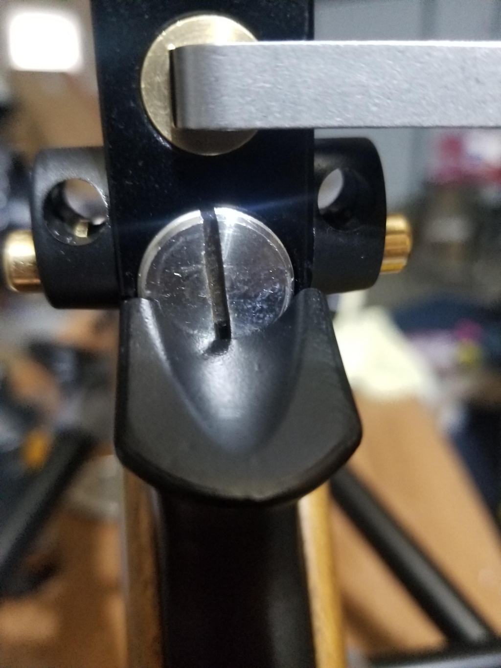

The trigger grub screw that adjusts the final stage break has a sharp point and was digging into the sear blade scarring it. Rounding and polishing that point, wet sanding and polishing the sear and sear blade where it contacts the trigger set screw really smoothed things out.
Also shimming the trigger and sear pivots took out some wobble that was causing the break point to change.

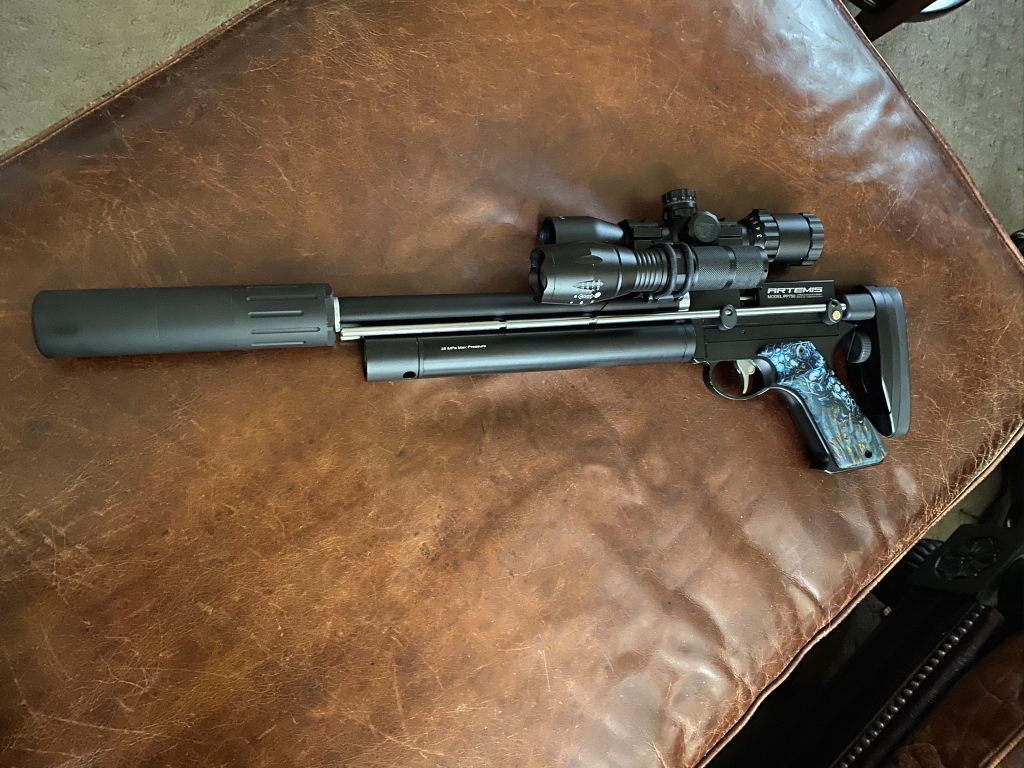

Did a bit of shooting at 25 yards settling on the JSB 8.4 gr pellets at 760 FPS making sub 3/8" five shot groups (even a few 1/4" groups). Huma LDC assisted in groupings as well as swallowing up most of the report, with red LED for some night-work.

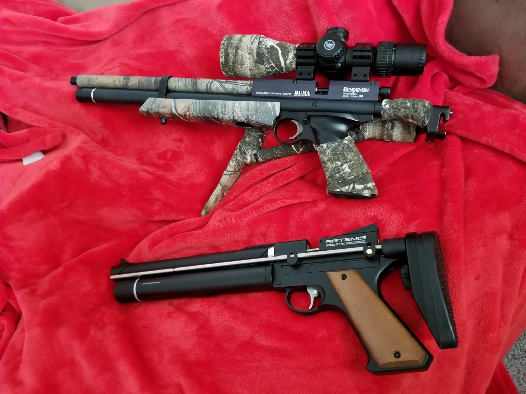

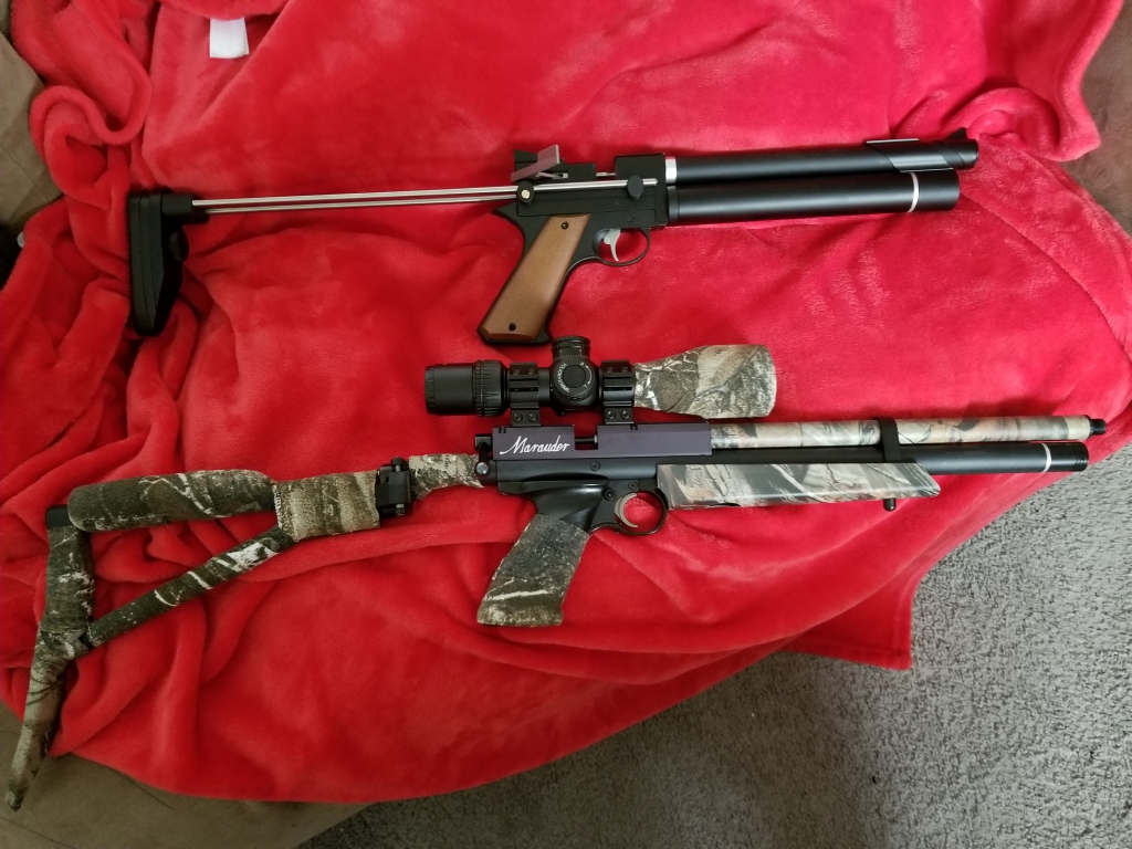

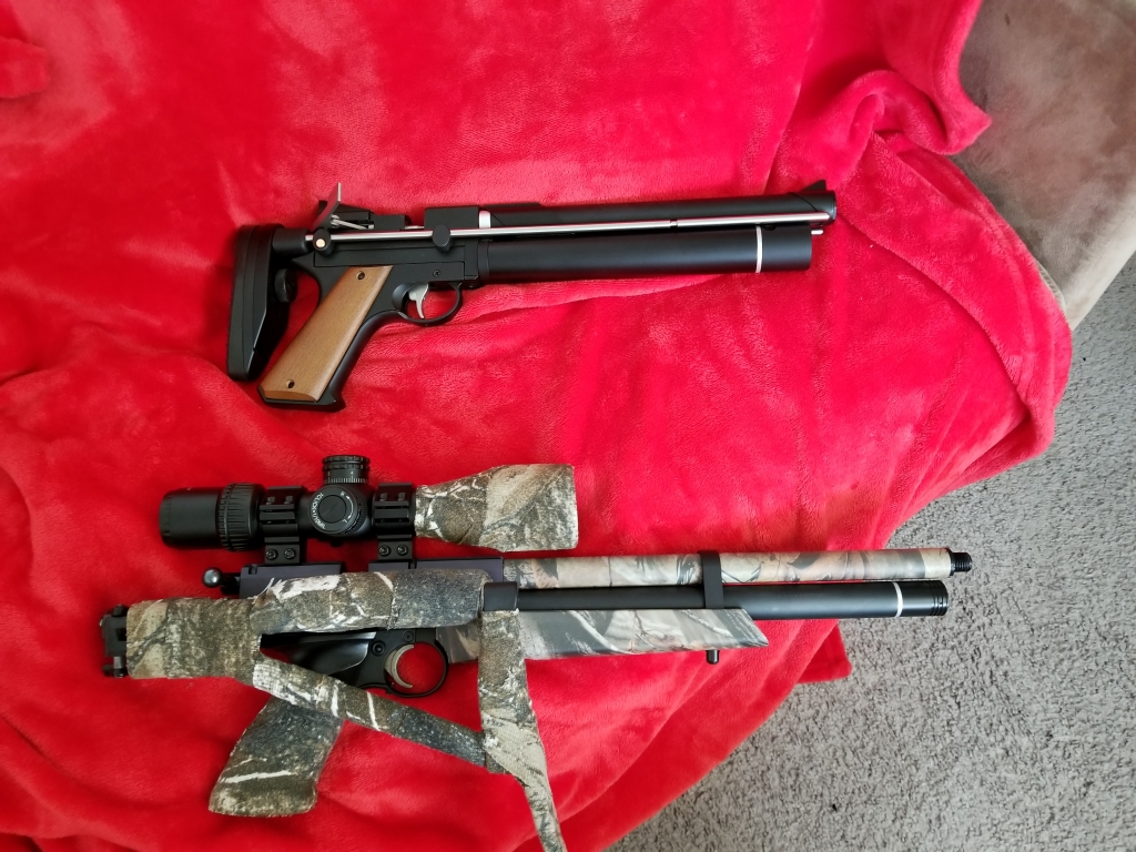

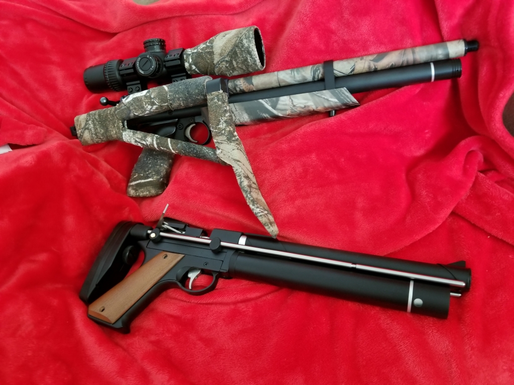

side by side with my Prod. Will put a red dot on it and shoot it later today.

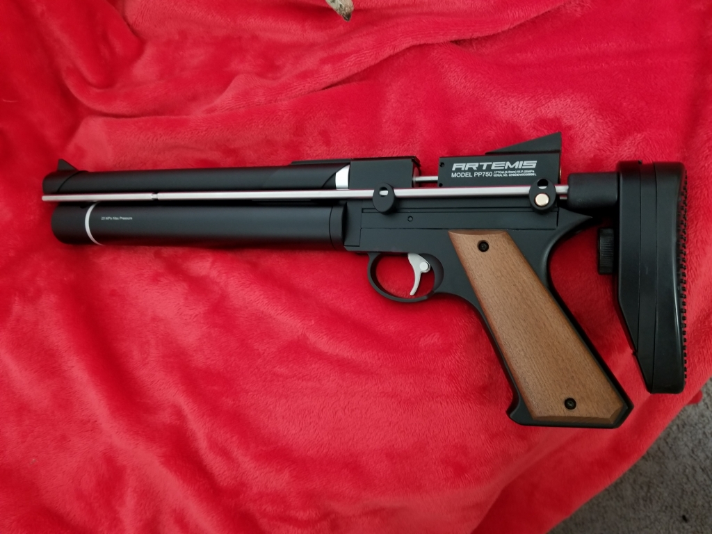

So far the PP750 is more compact. Also the magazine is more compact than the Marauder Pistol mag. Out of the box in 177 it is quieter. The single shot tray is well designed. Just some initial impressions.
Not sure why they swapped it from left side clocking to right.
Would've preferred left cocking as originally designed.

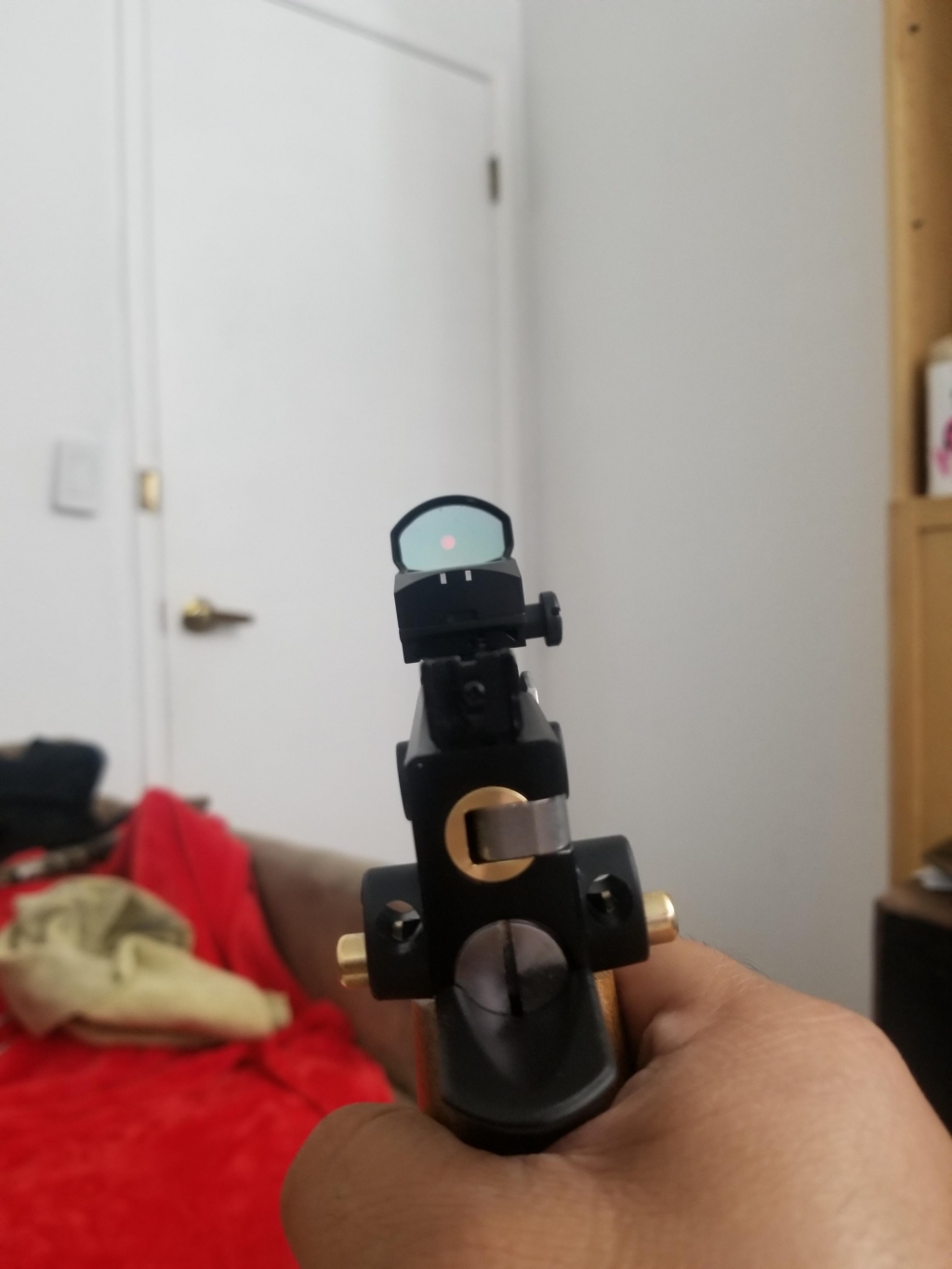

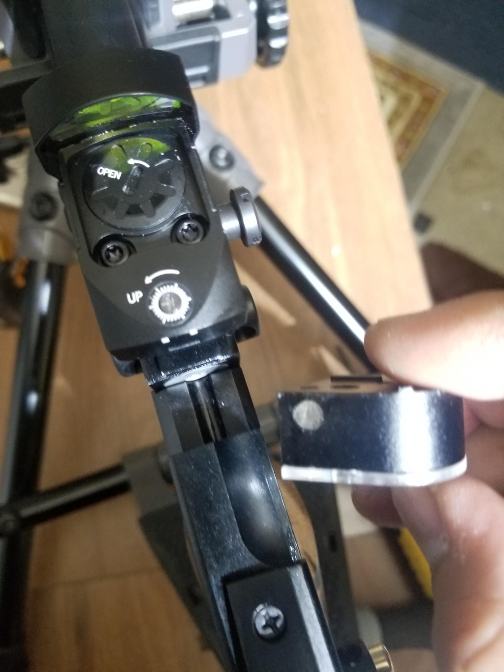

Thanks. I just took off the front rail. Pretty slick idea actually. I just put my venom red dot on and will now see how she shoots.
My silver fill port is oem. I noticed you may have a Gen 2 lol. Who knows?i will chrony this little pistola and see what she is putting out. Some more pics.

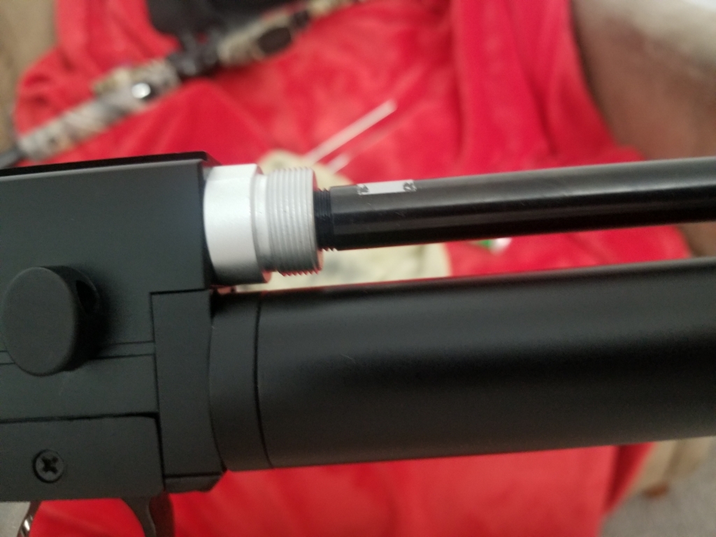

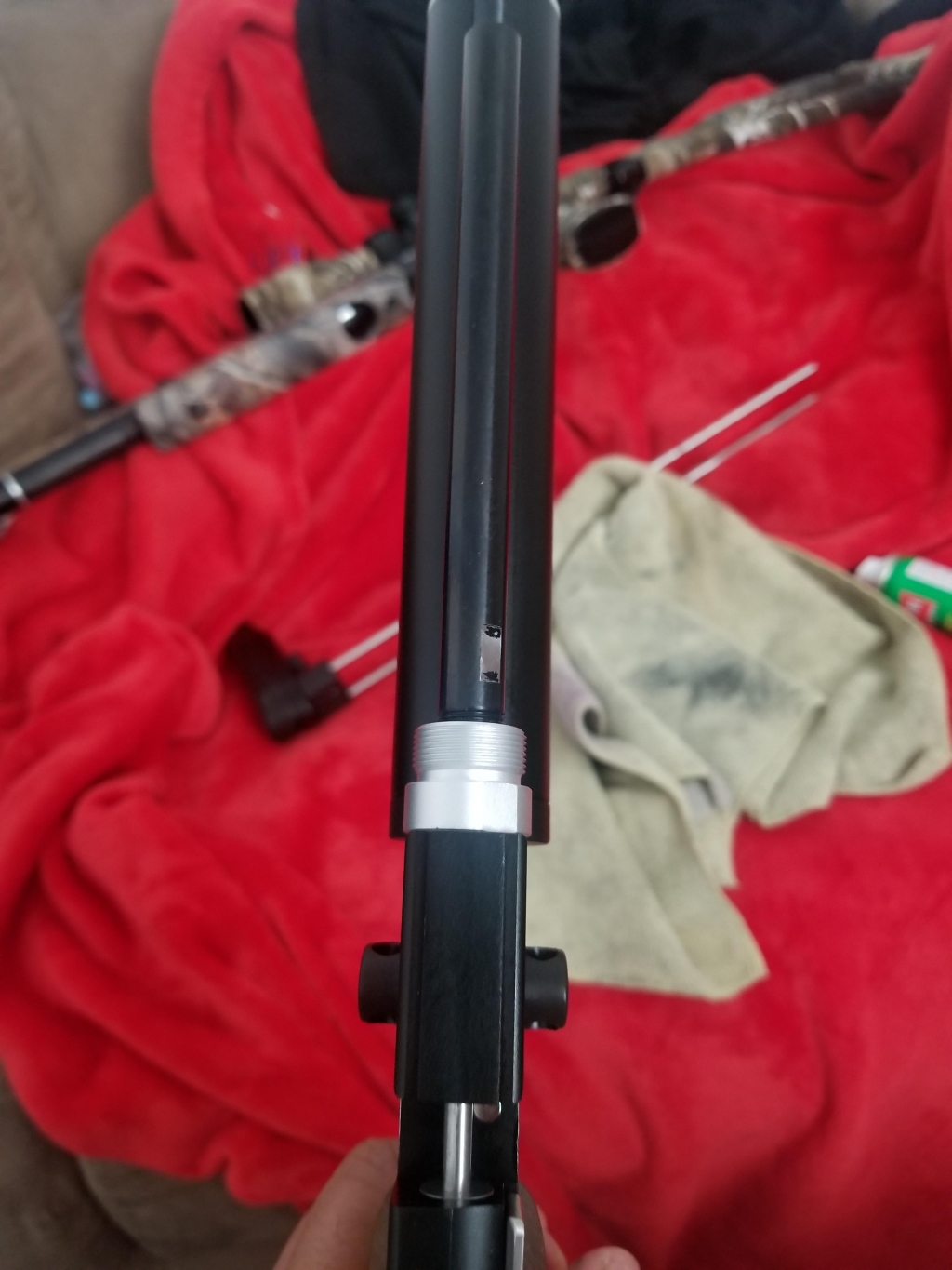

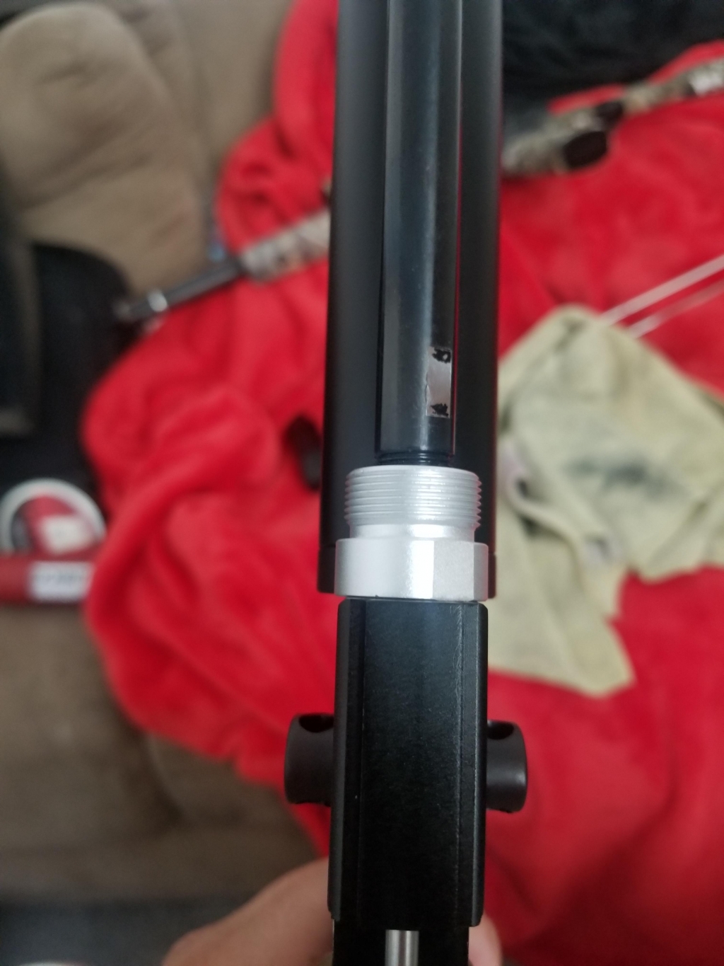

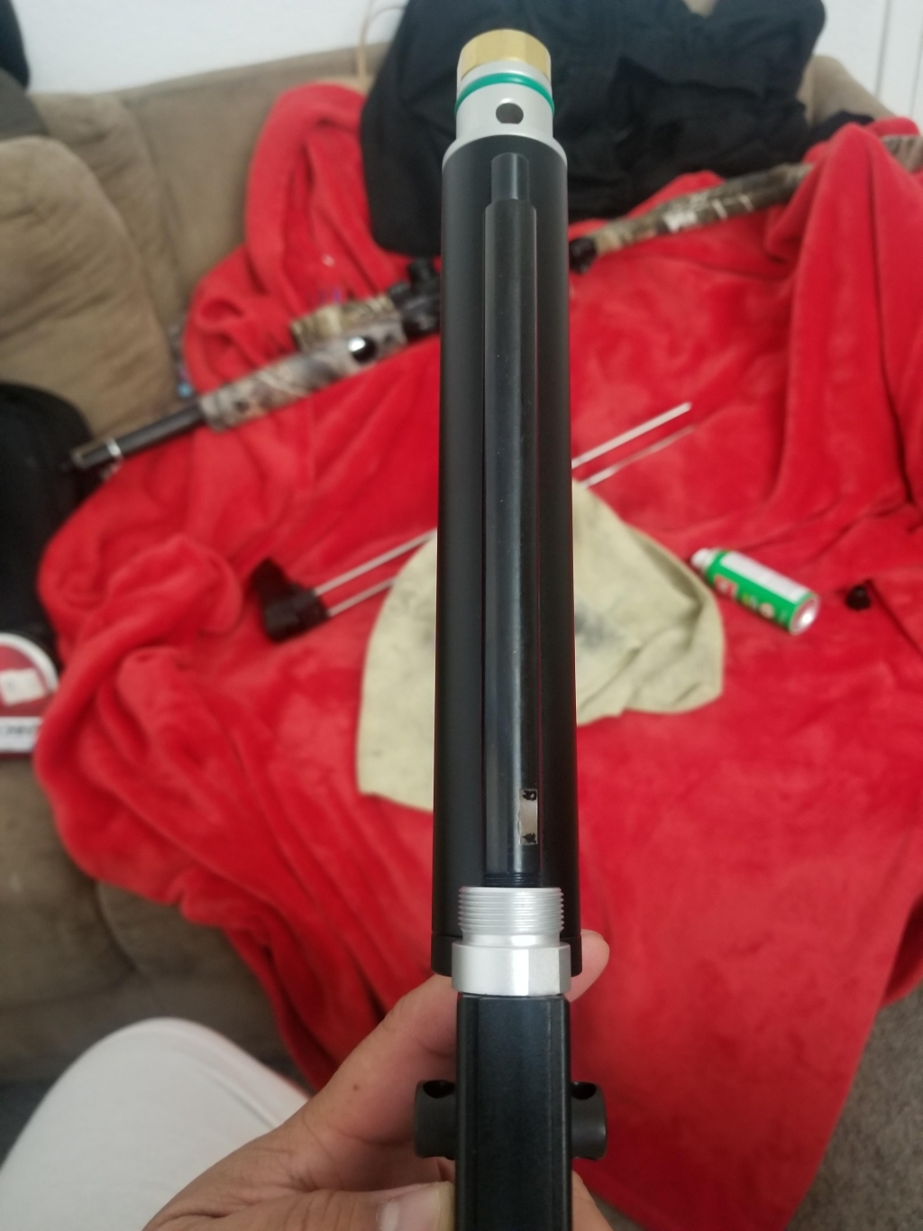

Anyone else have their barrel off to the right sort of uncentered? Just curious....

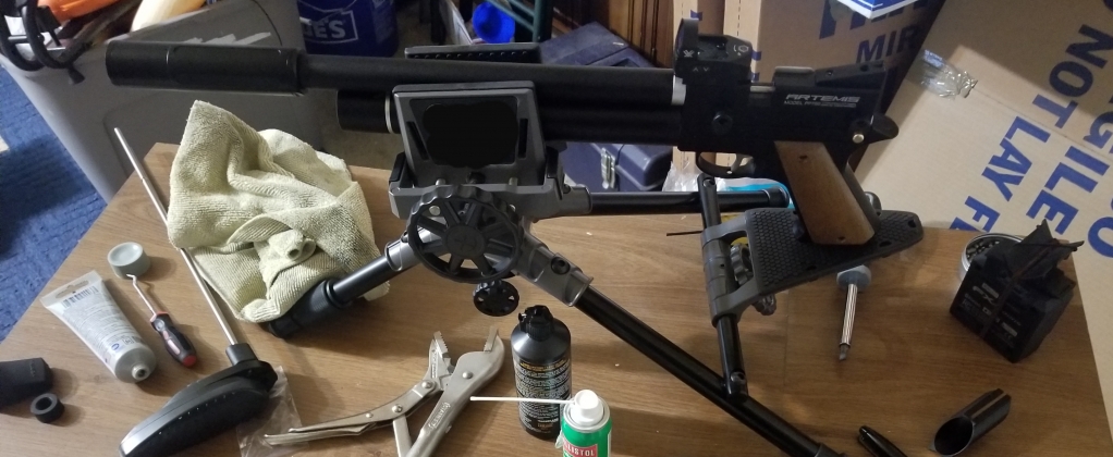

Doing a little tuning this morning and thus far the PP750 been easier to work on than I was expecting.

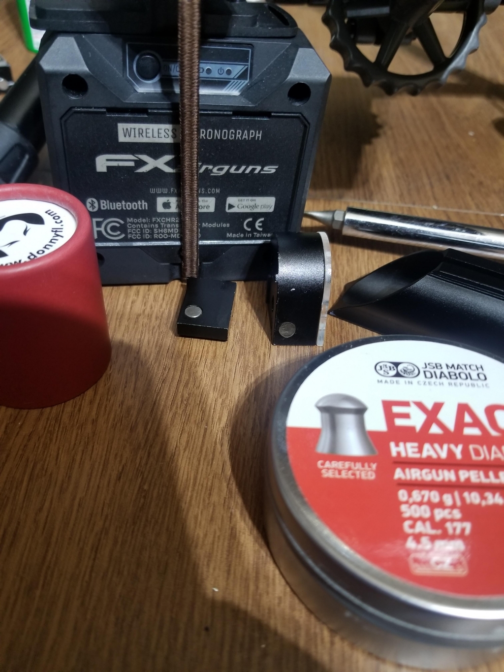

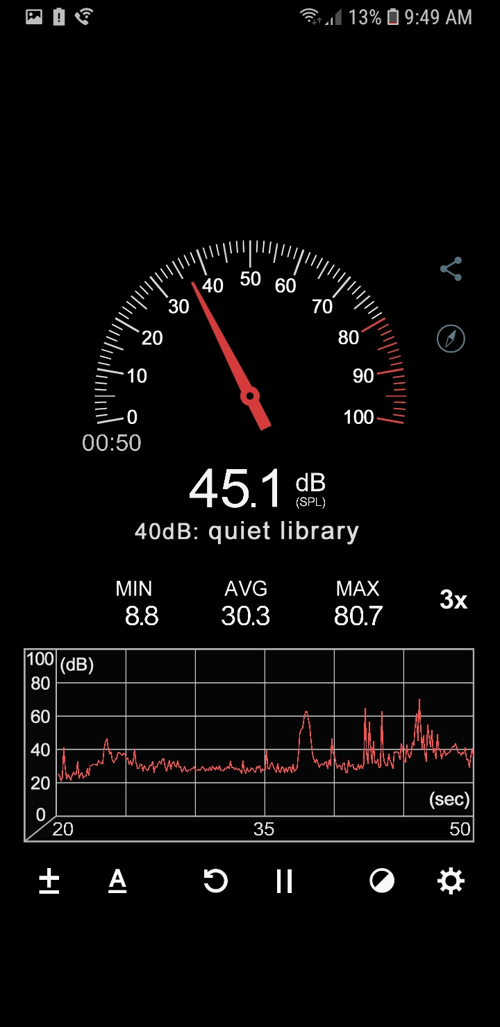

1st off, I took a couple dB sound tests and it was 80 dB with no ldc and 69 dB with a donnyfl Tanto ldc. BTW, I found out the Gauntlet adapter through donnyfl works perfectly fine on it. I know some were wondering if it works with baffle spacing etc, so I took a gamble to confirm. Confirmed.
Hammer spring adjustment was easily accessible at the rear. A little surprised by the handle built around it. It limits how far you can back it out somewhat.
A really slick surprise was the magnets on the single shot tray and magazine and the magnetic function while placing the sst in.

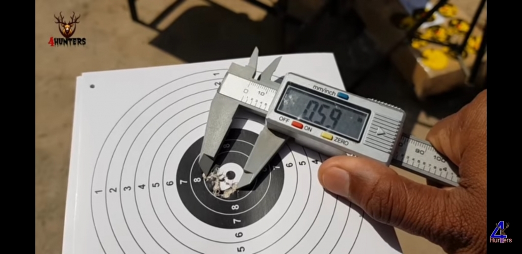

I don't plan to shoot my pp750 passed 50 yards but If any are interested what the 22 cal does at 50....
Here you go.
Taken from the Urdu spoken pp750 review below. (also, if anyone can figure out what the differences are if any between the pp750 with a silver fill port VS the black ones like the one used in the video please let us know...)
https://youtu.be/dy91umjaCto?t=827
I got one of Donny's Gauntlet adapters after reading a post that it would fit. Screws in fine, but I put a thick o-ring behind it as I noticed it wasn't quite deep enough to be flush with the baffle spacers. Just a little bit of tension as I tightened down the adapter. I agree the PP750 is not very loud stock, but with a Tatsu on it's very quiet.
