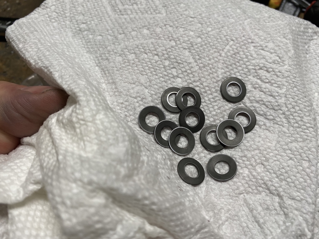

I pulled the regulator out and there are 12 washers stacked as follows: )))((()))(((
I'd like to know what configurations would increase the pressure a bit - this is a bit of a new tuning area for me.
Edit:
Adding that I re-arranged the washers to a ))(())(())(( configuration, which according to some sites I've read, should have cut the spring rate in half - so you'd think I would've had a lot less pressure at the valve. Oddly the stock hammer spring setting still gave me the same fps (within 10 - 20 fps). I've noticed adjusting the hammer spring doesn't really do anything except blow more air - it makes me think that the spring is too strong and we're already on the 2nd hump of the reg curve.

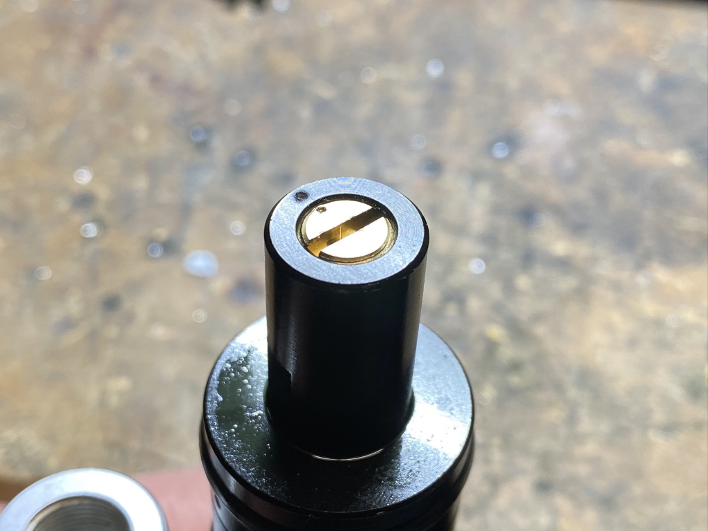

Brass flat blade adjusts regulator pressure by reducing or increasing the little plastic seal against small air passage. Clockwise increases pressure on seal against spring stack which lowers the output pressure. Counter clockwise reduces spring tension against seal, increasing output pressure.

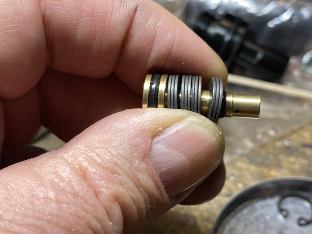

A small amount of cw or ccw makes a big difference. If you are out of range setting changes will appear to have no effect. Mine was made even more difficult with a rogue silicon bead in the washer stack, I couldn't get it to settle down at all. Once removed, belville washers edges polished, mirror polished the cylinder walls the regulator piston orings contact the reg is very consistent with no creep and fine tune adjustable.
Take you time, 1 quarter CW turns in at a time, repressure, chrono, repeat until you get an velocity drop... your in range for adjusting the reg. Full turns are way too big, you will pass the whole range. I punched a dimple on the brass and regulator body to index adjustments, otherwise hard to track.

Yep, you got it, backed out brass screw would let the air free flow passing the seal, making the same pressure on both sides, max pressure. The washer stack adds to the output side pressure in closing the seal.

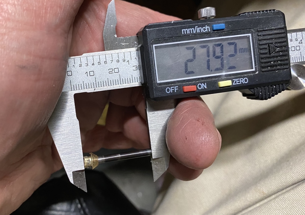

As far as a leaking out at 70 bar the brass poppet on brass seat seal needs quite a bit of pressure to maintain a seal. You could mate them with some lapping compound and a drill or lathe to make a better seal, but 70 bar is a very low pressure to be operating at. It would certainly make a hand pump fill difficult to impossible.

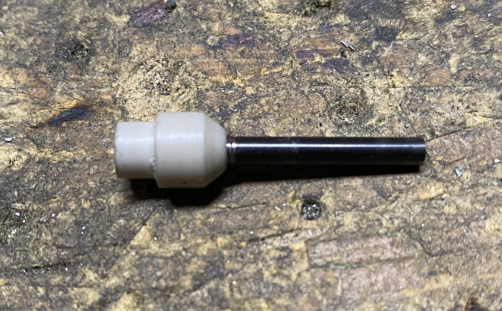

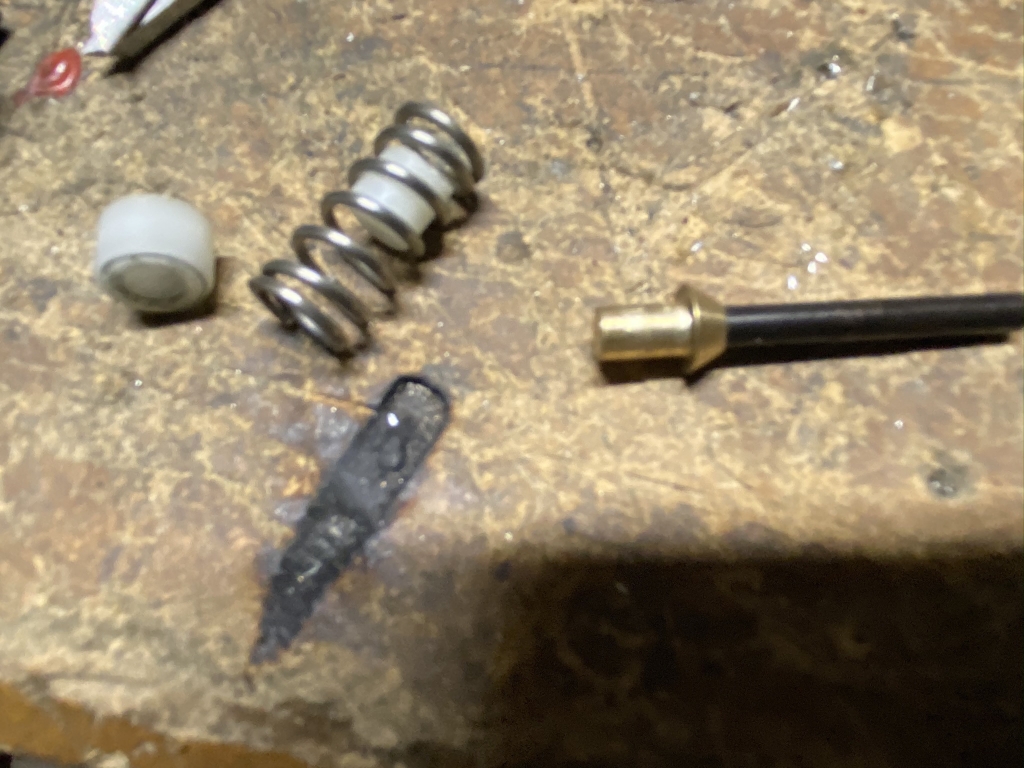

You should inspect your brass poppet for a crack. The poppet wall is 0.1mm thick where the shaft is and mine let go, replaced with much stronger PEEK poppet, lapped to brass seal. I used a lathe, but anyone could make it with a hand drill.

The plastic PEEK poppet/spring seat was machined from rod stock, not a pre-manufactured part. The plastic spring seat became unneccesary since the PEEK poppet was shaped to serve both purposes.
Because the belleville washer stacks would vary from gun to gun turns would also be different. If you have a sensitive hand you could back it out CCW a couple turns, then carefully start turning in CW until you feel tension (seal coming into compression). Chrono, de-gas, do another quarter turn CW, chrono... Take your time, it's worth hitting the right set point for the velocity and pellet that works best. You will end up with an air efficient tune with low extreme spread.
