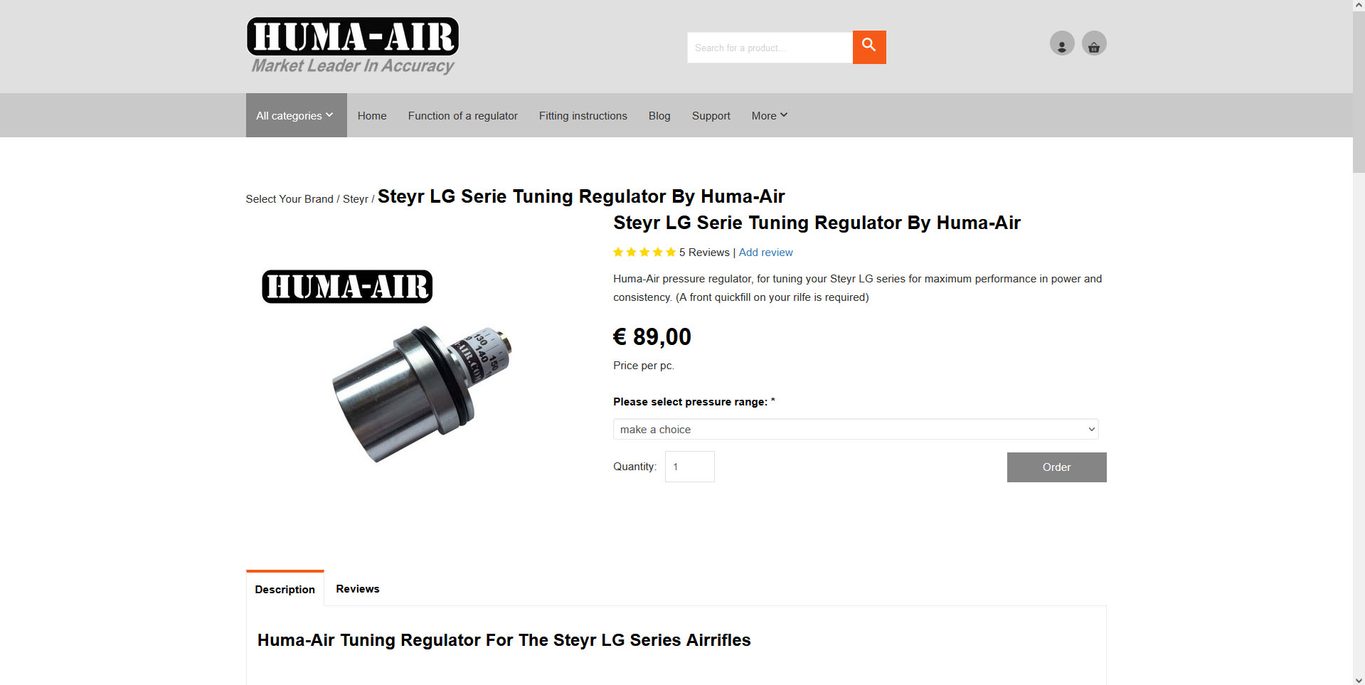

If you are looking to replace the reg yourself it looks like Huma makes them for the Steyr LG series rifles.
