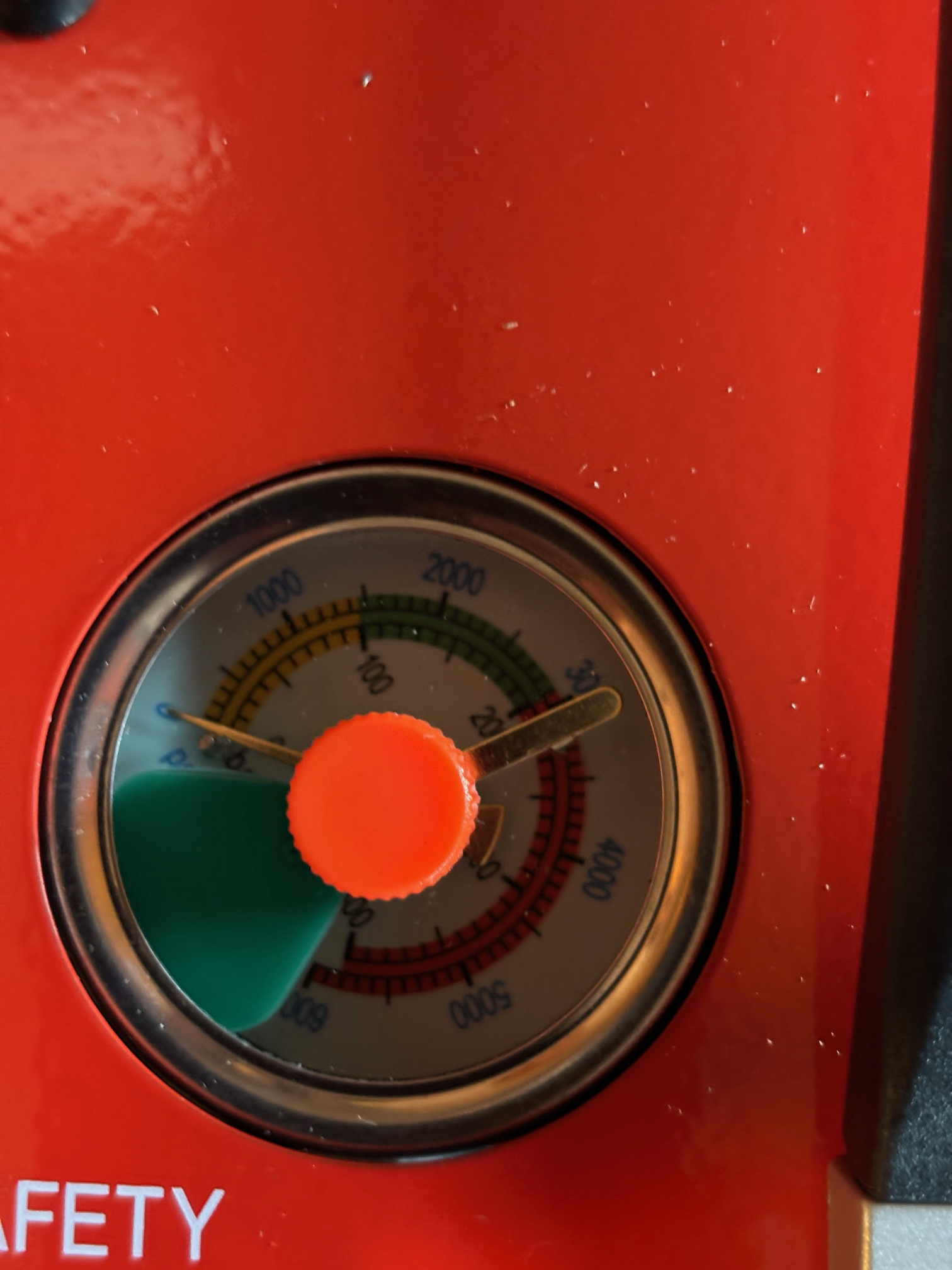

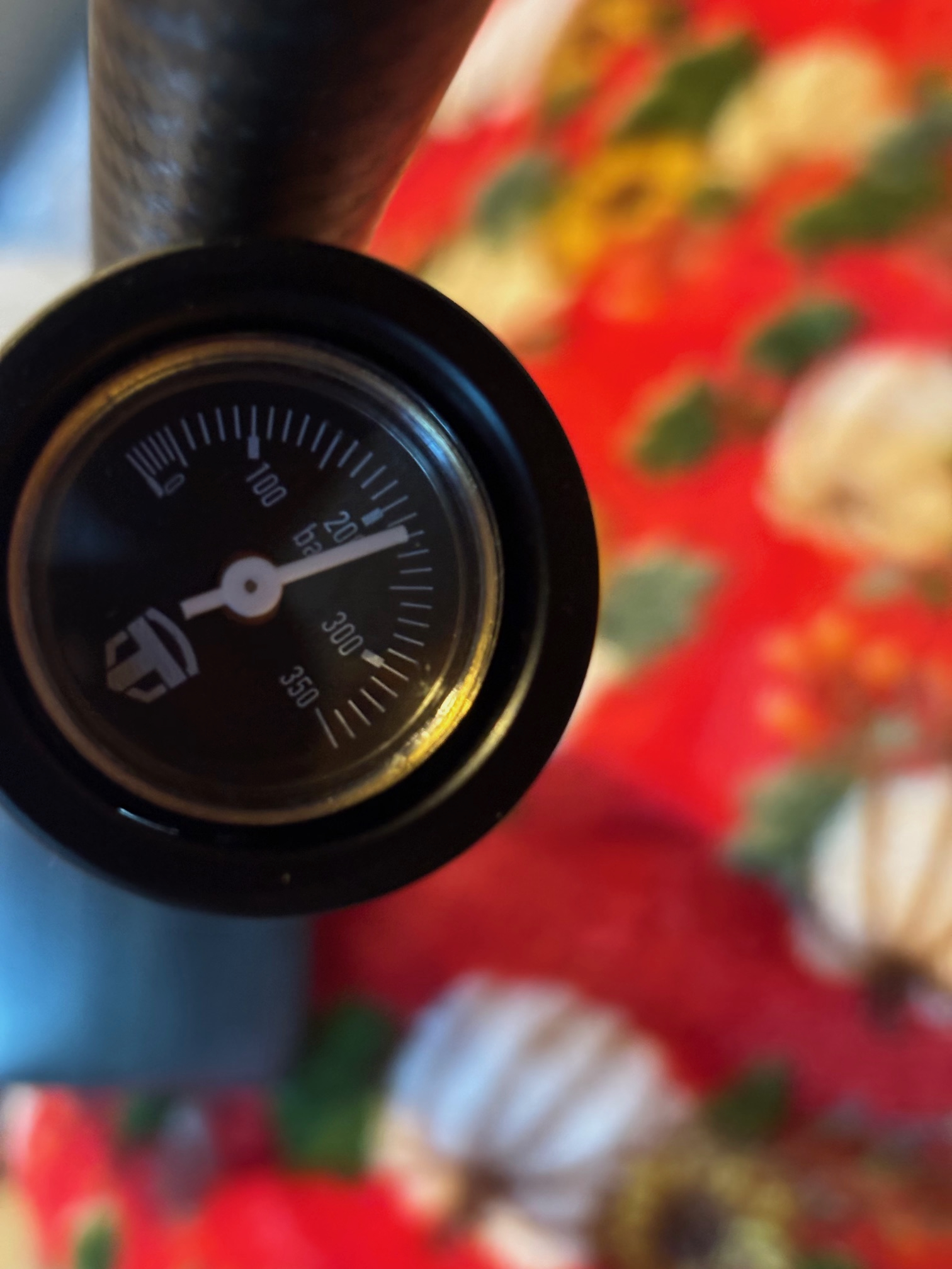

The "stop" filling needle is pretty course on the compressor. The needle on the Taipan is quite thin. I set the compressor stop on what I believe to read 250 bar. When the stop is reached the Taipan is just a smidge over 200 bar. Which one do I believe? I read some posts here on the forum, one fellow said don't believe either one.

I took a picture of both he GXCS3-I (red background) and the Taipan Veteran 2 Standard gauges.
You can see I set the Compressor gauge "stop" needle just a bit beyond 300 BAR. When finished filling the rifle reads about 220 BAR.
I'll probably call UtahAirguns on Monday. I don't want to just watch the gun gauge until it gets to 250 if that means ignoring the compressor gauge as it moves towards 350 BAR?

As I looked at the close up photos I realized (duh) I was reading the compressor gauge wrong! Bot of these gauges are actually 220 BAR.
Problem solved.
