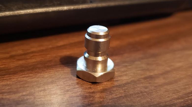

How do I check to see how much pressure is remaining in the tank though?? ( lol - told ya - likely dumb question ) I'm thinking - but haven't tried yet - figured I'd do this first - ask - that all I do is put the "plug" that came with the tank into the foster fitting and then just crack it and let the pressure build behind it. That should be the pressure remaining in the tank itself - right??
Yes, you need a dead head plug if you your tank doesn't have a second gauge that always shows the tank pressure. Sounds like your tank came with one. Just put the plug in the fitting and slowly open up the valve just like you fill your gun. The gauge will show the remaining pressure in the tank. Then bleed it off just like you do after you fill your gun.

One of these things . . . . it just plugs into the line and doesn't let air pass - it's a "dead end".
FWIW, I personally try not to dead-head too often just to check pressure. It can waste more air than you may think, especially if you have a long hose. Basically you are filling the entire internal volume of any valve bodies, couplings, connectors, hose, etc., to max pressure and then just having to bleed it all off. Best to only do that if you really need to.
