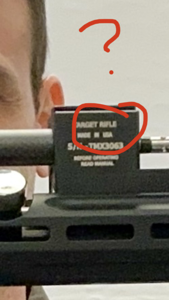

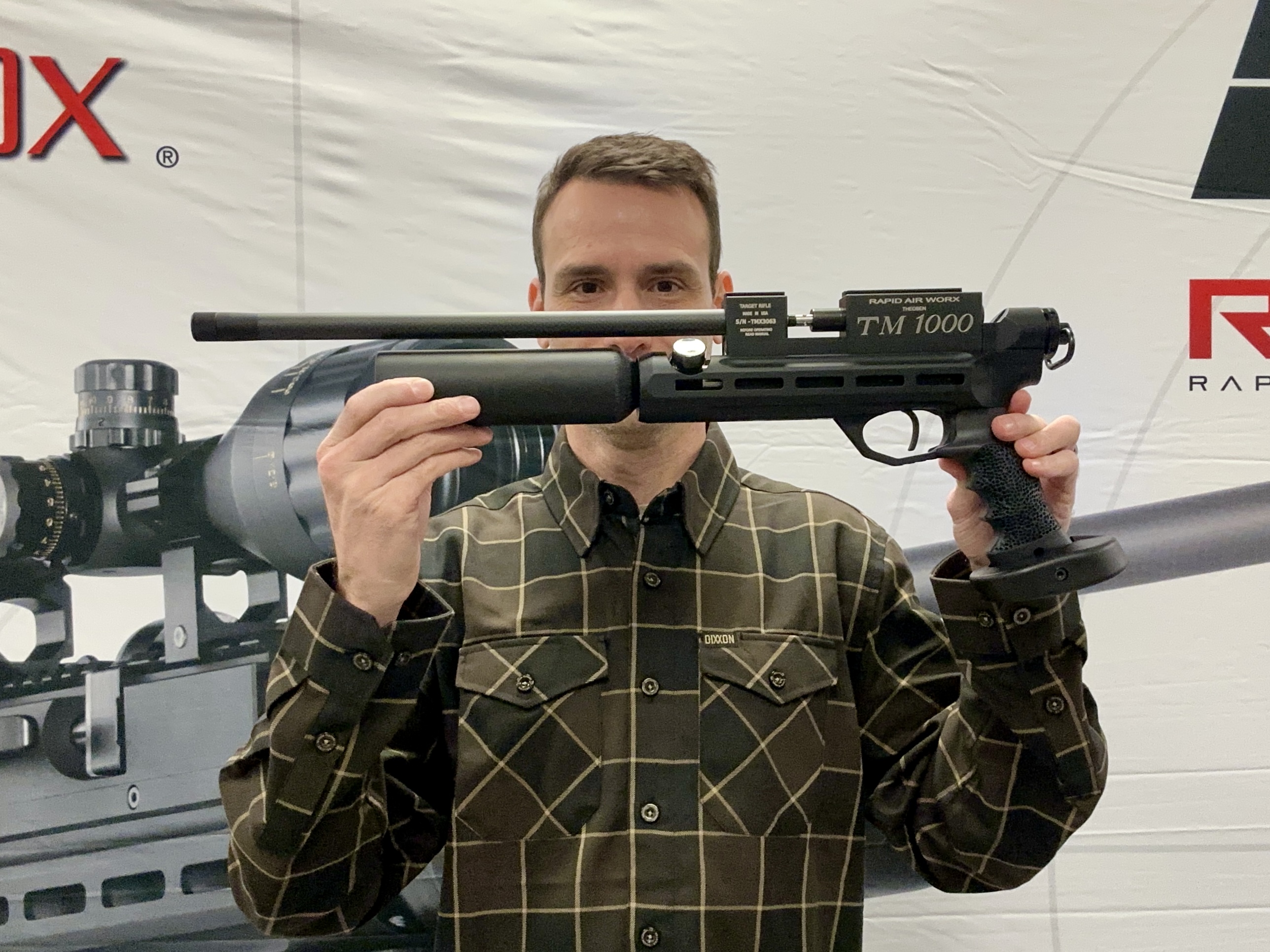

I had the same reaction, especially with the bottle on the end. makes the Talon P look pocketable. Is this something that’s designed to technically just fit in the pistol class while retaining as much as possible of the features of a rifle? can it be shot one-handed? The information on the receiver seems to indicate that it is a rifle, or maybe that’s just a quaint way of referring to the rifling in the barrel. Take a look at the grip… The drilling looks like it was done by hand for the texture so maybe this is a rifle mod
Reactions: JaceSpace1369
Am I really the only one looking at this thing incredulously, and thinking "that's a pistol? 🥴"?
No offense meant, but how can you shoot that thing consistently without a rest? Looks heavier than some of my rifles. 🤷‍♂️
It has a dual purpose - at 20 ftlbs it’s a hunter but tuned down to <12!ftlbs it’s HFT legal… shooting off sticks except for forced position lanes. Now I have to pick the perfect scope for it!
Mine is in .20 caliber and has a carbon fiber bottle
So this uh pistol is designed for a specific class, Field Target, but can be tuned up for hunting. That is a big ASE pistol, though I see it is made for Field Target.I would get another stock for it for hunting. Just my take.Then again I could get the Mini, truthfully, Choice is such a great thing.:sneaky:
Technically you could turn up the juice and add a stock and use it for HFT but pistol class is sub <12, that said, this variant of the RAW platform is single shot breech loader - no magazines
