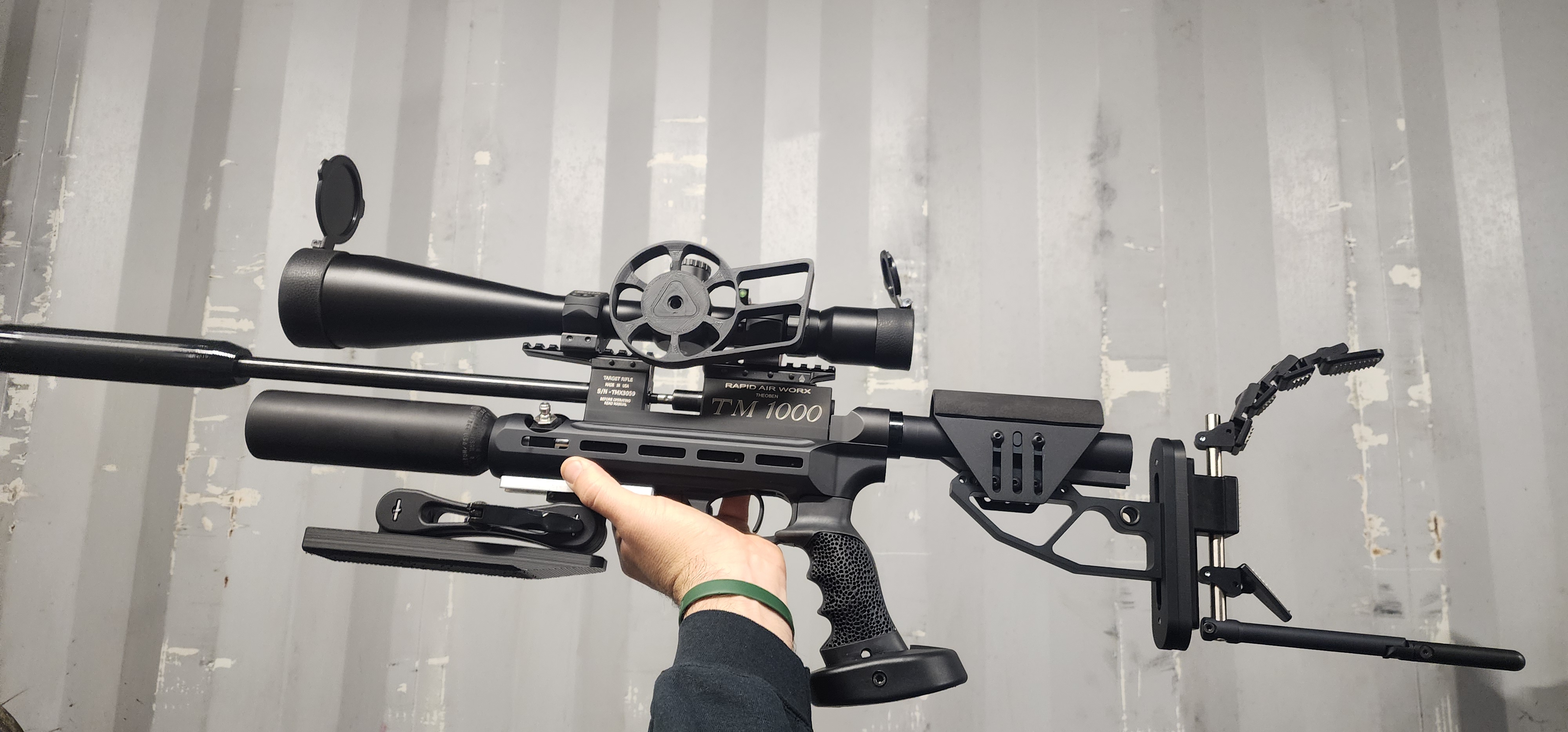

I'm as far from a competitive shooter as you will find. I admit I'm a horrible shot, especially at 72 Y/O. But with that scope I just might be competitive. The scope is so huge and lashed to a very capable pistol it seems like cheating. I'm sure I'm alone in this opinion, but competitive pistol shooting in my mind should have scope limits, at least a scope weight limit,😂 maybe no scope. I found this pic so disturbing I went and read the AAFTA rules until I fell asleep.
Come and shoot a match in AAFTA Pistol or EFT Pistol before you start suggesting how we could make it better! You might just discover how hard it really is.
Am I really the only one looking at this thing incredulously, and thinking "that's a pistol? 🥴"?
No offense meant, but how can you shoot that thing consistently without a rest? Looks heavier than some of my rifles. 🤷‍♂️
No you're not, I couldn't agree with you more. Check out the picture on this string with with the Hubble on it. 😂🤣

Here is what it looks like in rifle/ carbine configuration.
Thanks for sharing this!
It's a bad ass purpose built gun.
As a pistol in ft, I nearly cleaned the ft course in SoCal this past weekend, I only missed some standing shots. Was able to shoot match high score with it too.
I've built two and am working on a third setup now. These are excellent FT pistols, and can be easily swapped to a WFTF PCP rifle.
I'm currently working on a full power tune that can easily be swapped to 12fpe for pistol as well.
Is your butt stock off the shelf or is made up of individual parts? Please give more information on your butt stock.
