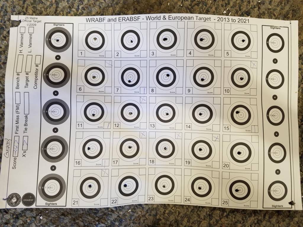

I shot a "very respectable" 247 in my 1st (& only) 25 meter competition using a $10 bag in back & a $50 bipod. Depends more on the shooter's capabilities than expensive rests IMHO.
