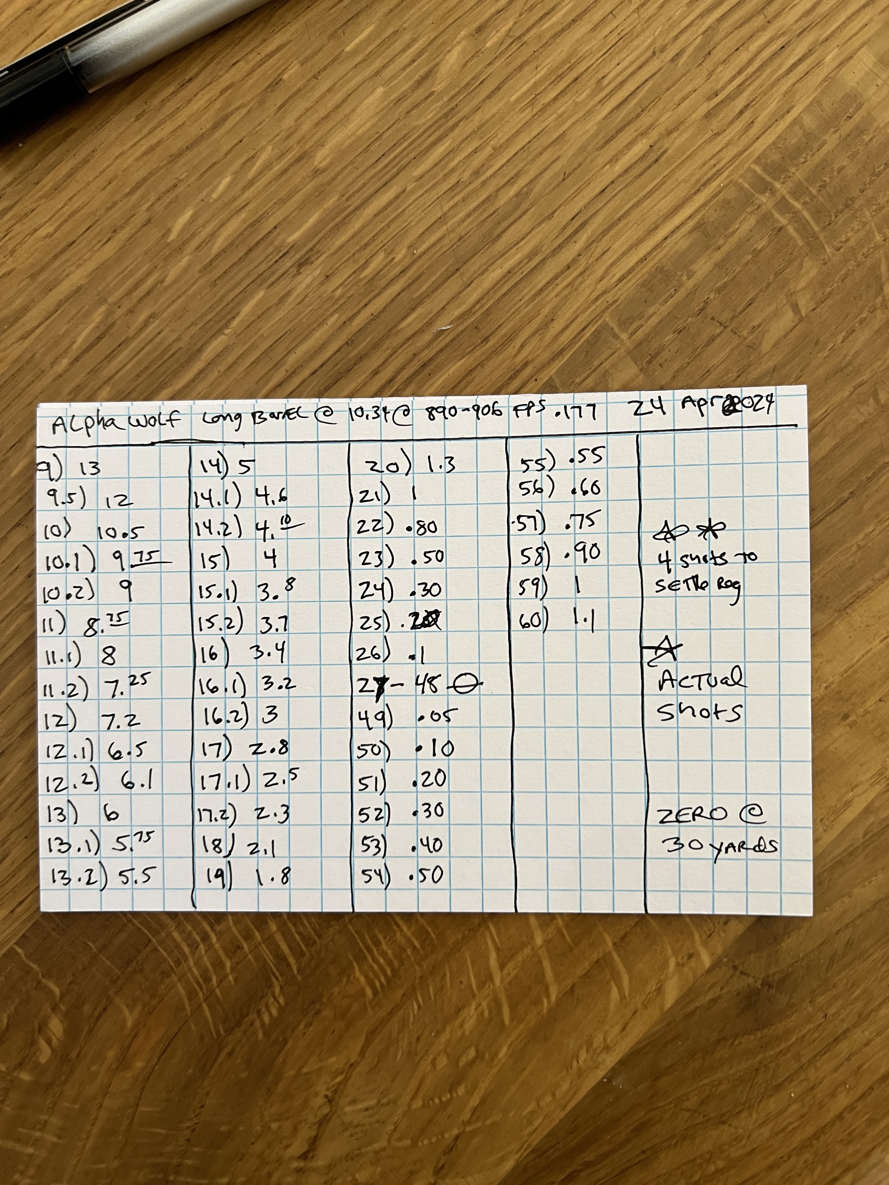

If you haven’t heard this yet, it’s good information. Because my Ghost Carbine had a leak issue I sent it back to AOA and in the meantime I broke out my Alphawolf; which promptly developed a Chrono issue - probably due to me. So I sent AOA my 13” alphawolf barrel too, and promptly installed a 28” barrel with chrono on the Alphawolf. Keep in mind that the factory settings for a 28” barrel don’t support an HFT legal speed/pellet combo sooo I took a wild arse guess and in factory mode I told it I was using a 13” barrel and a 8.4 pellet and desired a speed of around 890 fps. I left the regulator at 127 bar and As luck would have it, those settings caused the 28” barrel to push a JSB 10.34’s at 890fps after just 4 shots 🤩
And….. look at this trajectory:
Houston we have lift off!
@SDstephan
If you haven’t heard this yet, it’s good information. Because my Ghost Carbine had a leak issue I sent it back to AOA and in the meantime I broke out my Alphawolf; which promptly developed a Chrono issue - probably due to me. So I sent AOA my 13” alphawolf barrel too, and promptly installed a 28” barrel with chrono on the Alphawolf. Keep in mind that the factory settings don’t support an HFT legal speed/pellet combo sooo I took a wild arse guess and in factory mode I told it I was using a 13” barrel and a 8.4 pellet and desired a speed of around 890 fps. I left the regulator at 127 bar and As luck would have it, those settings caused the 28” barrel to push a JSB 10.34’s at 890fps after just 4 shots 🤩
Nice number @cavedweller
I would guess that the gun took the speed desired (890 fps) and did it's adjustments based on the actual, not inputted weight.
I have the 23 inch barrel both for 177 and 25. I never had an issue keeping the power level to sub-20. It was accuracy that was lacking- again it's time I need to spend that I haven't really had. Now that the Thomas is set up I could but there is a match every weekend from here on out....first world problems.
