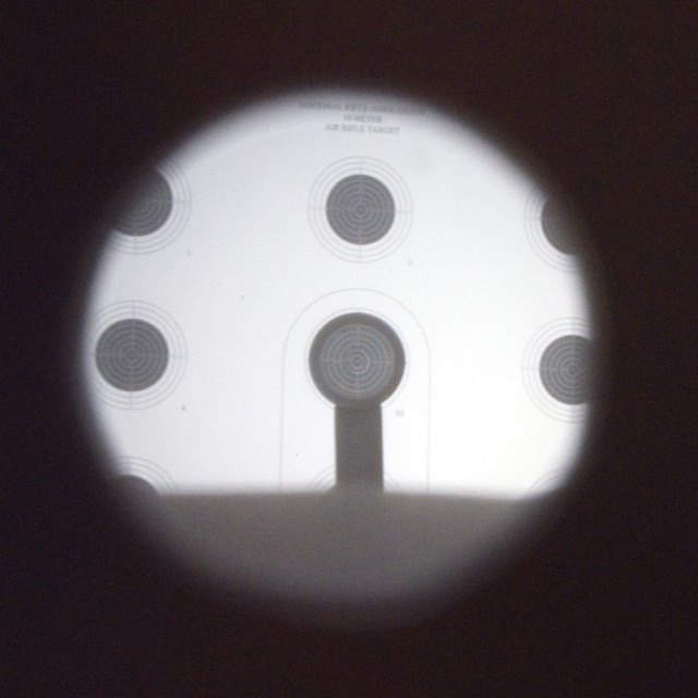

Hello everyone, new to this sight and to this site. Here is what's going on.
I recently purchased a used gun and it arrived with this Diopter sight.
It also came with a front to match. When I look through the rear without focusing my eye I can see this image clear as day.
However as soon as I focus through the sight I loose the lines and the dot is blurred grey (still visible though), now I'm assuming that I should center up the rear dot through the front sight.. if that makes sense? I tried at 5/10/20 yards but still as soon as I look past about 5 ft. it becomes fuzzy. I didn't find any type of "optic" adjustments, just eliv. and wind.
So I was wondering if it's "just the way things are" or if I'm missing something?

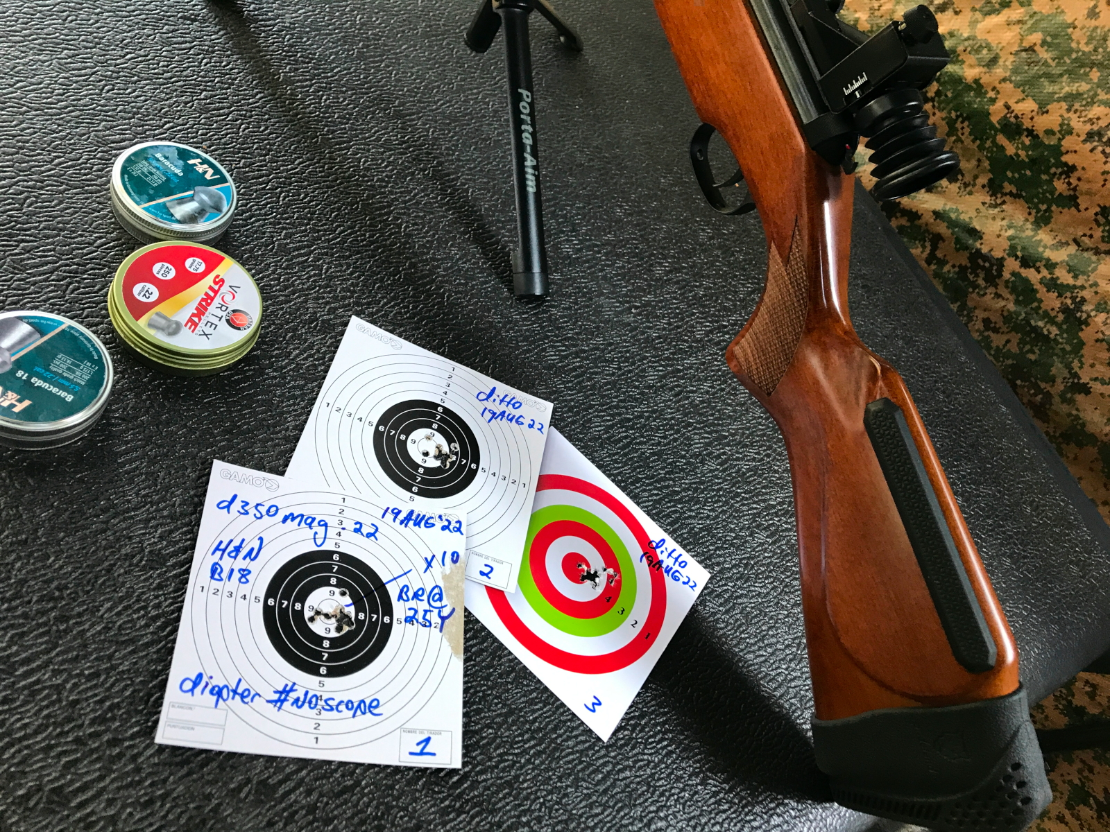

not the best sight-picture of the peep, but best i can do with an iphone. :)

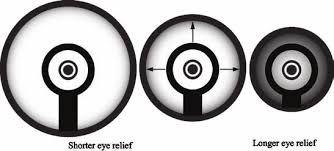

it's the target you want in focus, with the "rings" evenly-spaced, with equal but minimal light around the edges.
From what I understand, the diopter is used mostly for 10M competition shooting.

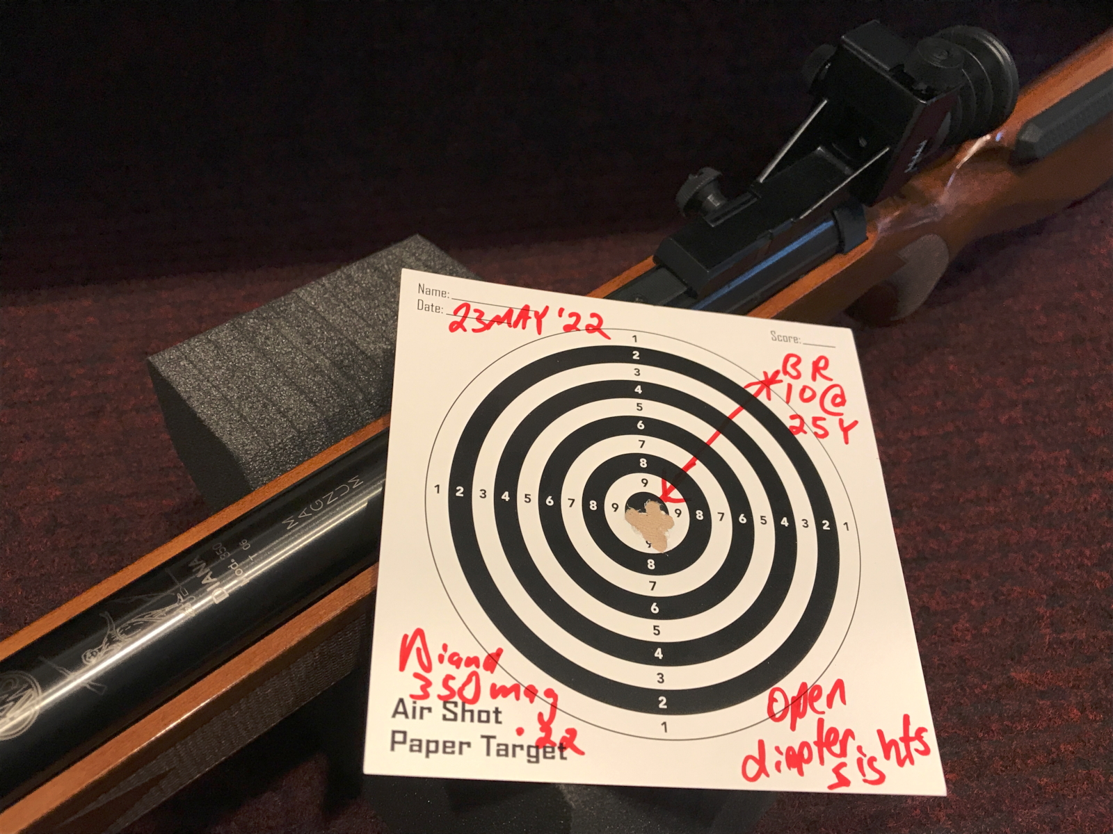

I just shoot paper, 25Y benchrest #backyardplinking. Diopter sights are my favorite and used in about 90% of my shooting now-a-days.
Thank you.The chart in the middle made me realize that I'm not treating this like open sights but more like a scope. I need to get back into "iron mode" LOL.
Also I just played around with it some more and found it helps if I back my eye away from the sight more.

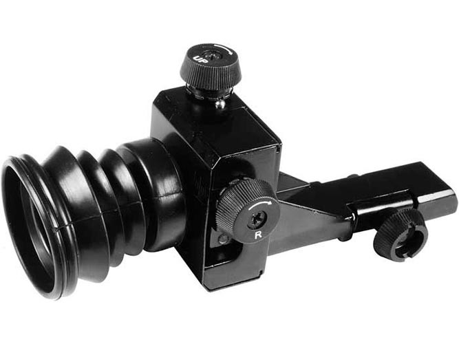

I purchased a diopter rear sight sight for my HW35E.
I have not been able to find any clarification for the markings on the elevation and windage knobs.
Elevation clockwise is marked "H" and counterclockwise is marked "T".
Windage clockwise is marked "R" and counterclockwise is marked "L".
As far as I have been able to determine, "R" is "rechte" or RIGHT, and "L" is "linke" or LEFT.
But I cannot determine what "H" or "T" are supposed to mean.

H is for Hoch (up), and T is for Tief (down).

Thanks pdxFrank!
I had an inkling that T could be "Tiefer", as it was the only German word in the online translator that began with a T when I entered "Lower or down".
But "raise" "up" and "down" all listed German words beginning with H.
