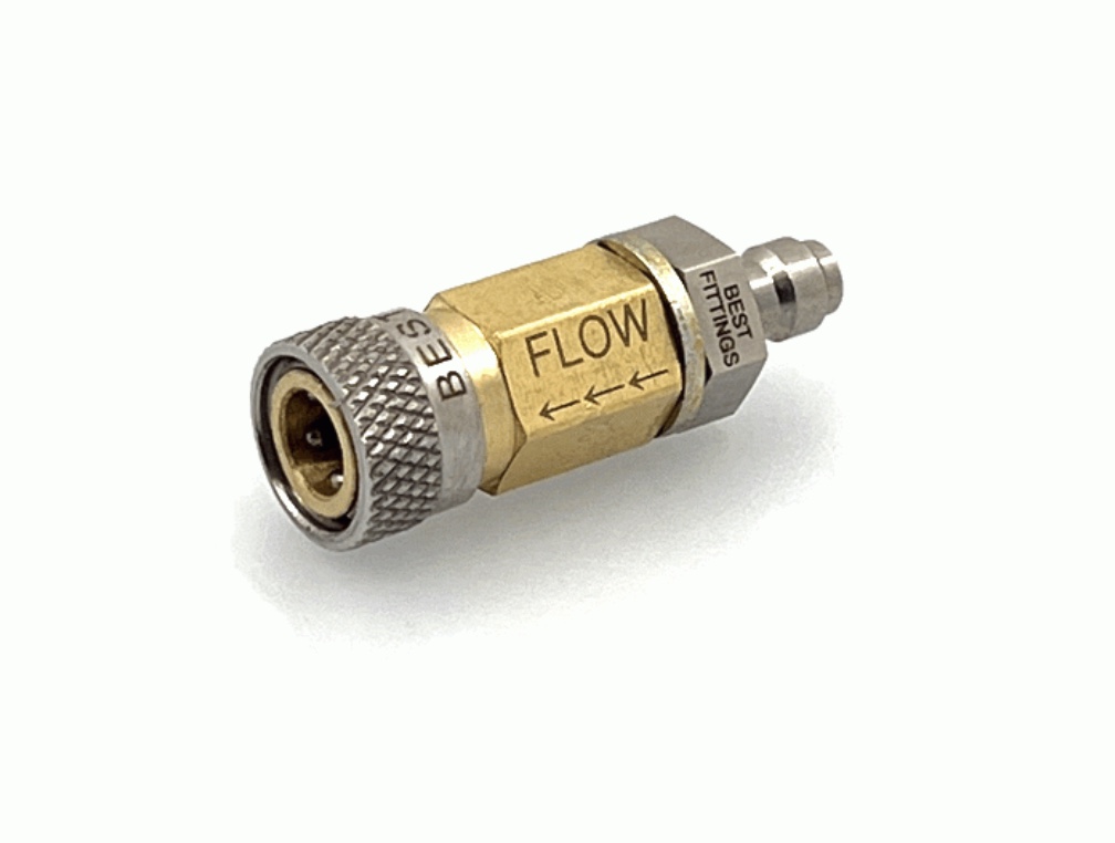

You may need to allow your compressor to build more pressure than is in the tank before you open the valve on the tank. Best Fittings makes a one way valve just for filling tanks with a smaller compressor, it prevents the pressure in the tank from back flowing to the compressor.
