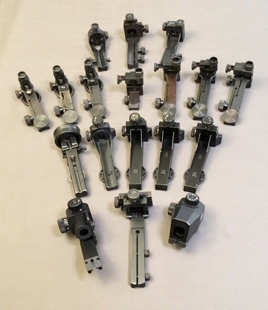

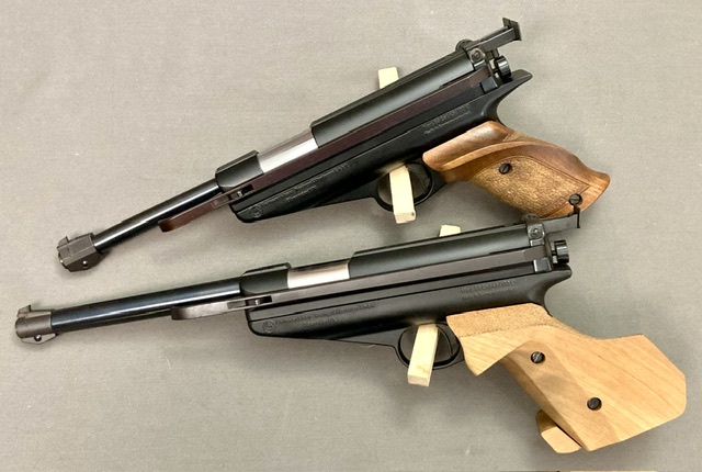

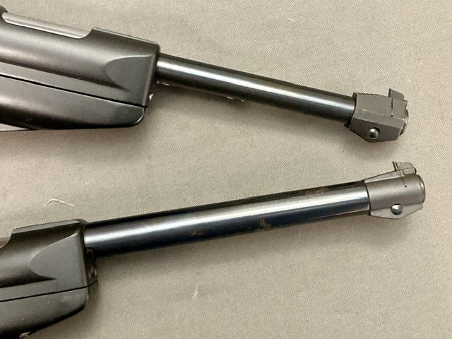

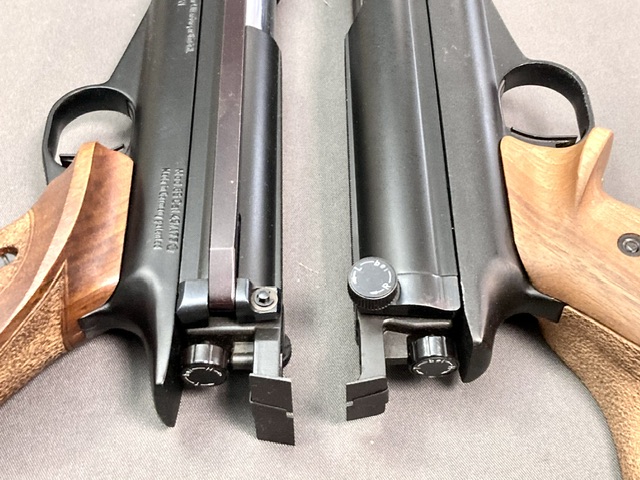

My photo above is of aperture sights used on match rifles - sorry for the confusion! ISSF or NRA-sanctioned pistol matches permit only traditional open "post and notch" sights. The guns in these pics are old (FWB 65 springers), but sights haven't changed much. Besides fine height and windage adjustments, the shooter can tweak the front post and rear notch widths.
