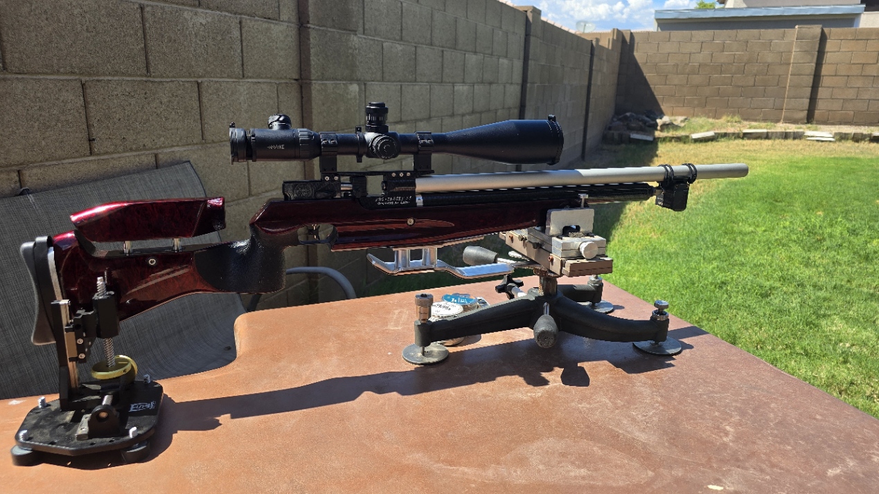

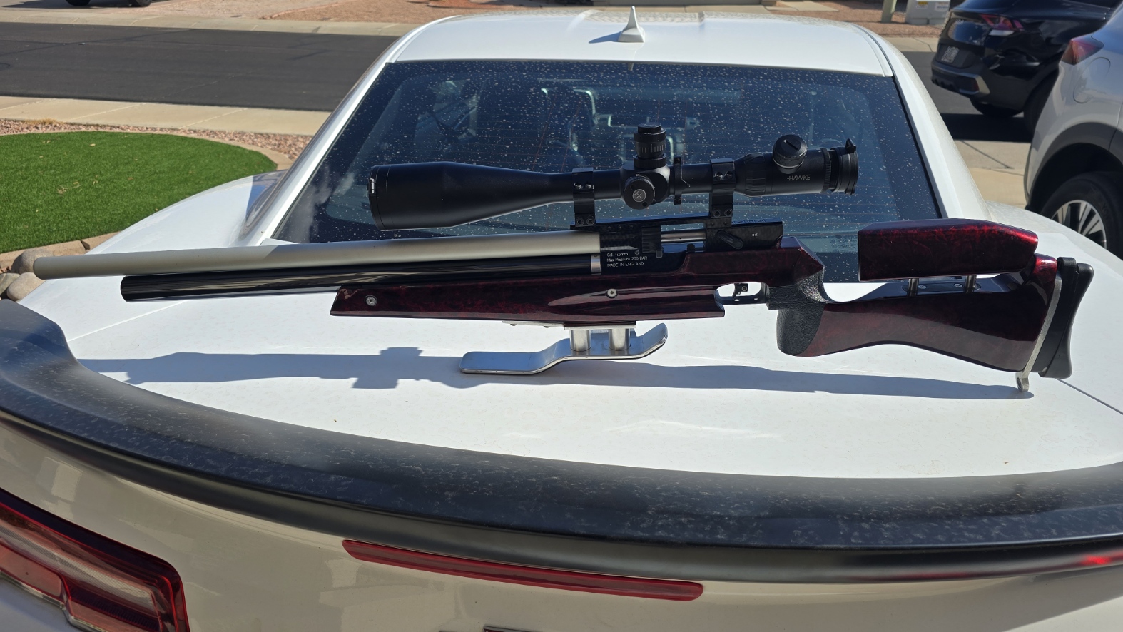

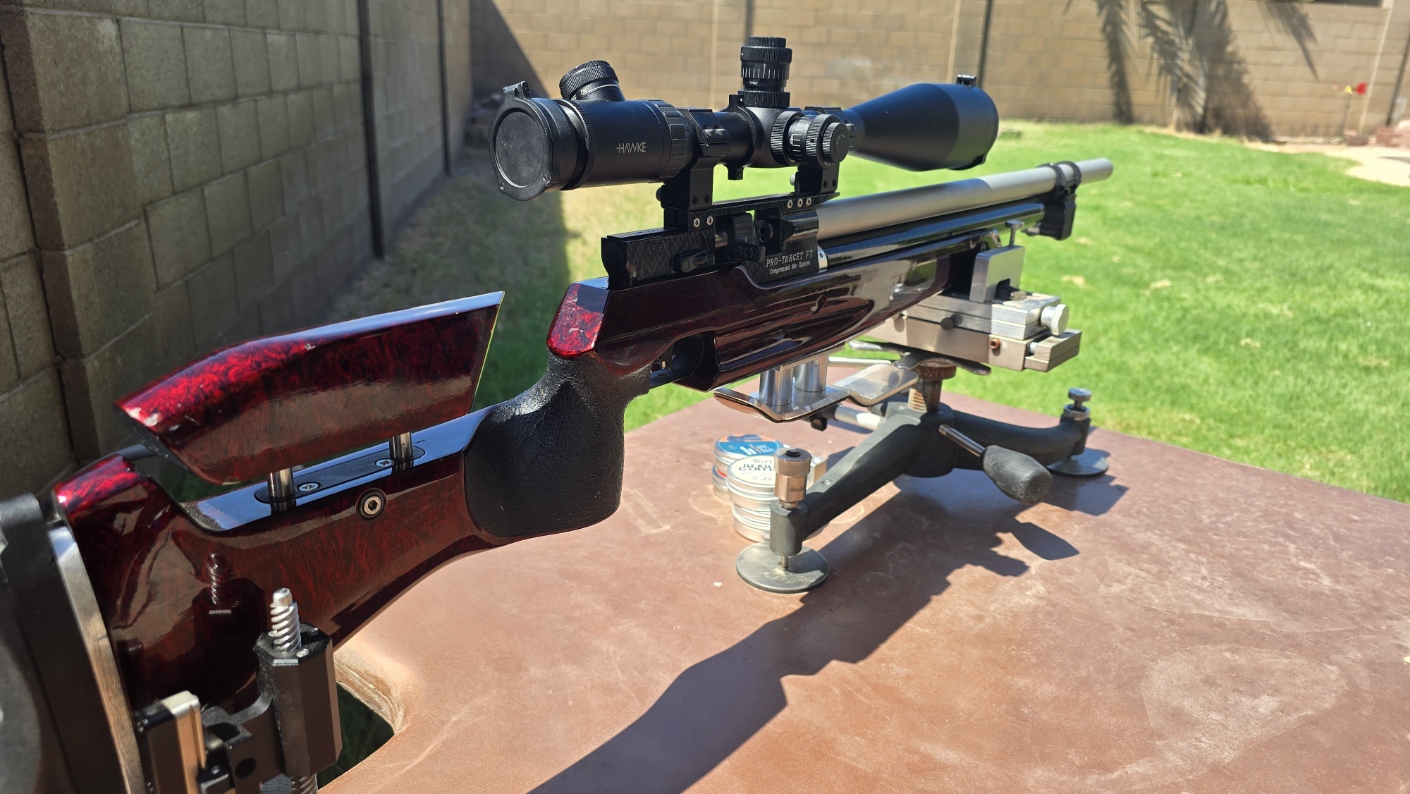

Air Arms new to me, Air Arms Pro Target
So I got it out today.
I still need to change the fill valve to a foster style but have that on order.
I have not shot it because the old fill valve is leaky but I had a temp solution which is use a foster fitting without a check valve and use my tank with the hose tethered to the gun but close the tank valve therefore acting as a check valve.
I have also mounted up my Hawke 10-50x60 ED on it. Much better scope.
Parts are on order for the foster fill valve, but it was nice to shoot it even though it was 116 out there and I was in full sun.
I did mostly some testing and see the shot count and look at the ES for he gun.
But did do a little accuracy testing as well.
Hard to do when the gun is only set for 12 ft lbs and the wind was gusting at 11mph.
But I think all said this is going to be a fine gun for the collection.
Hard to believe this is a 25-26 year old gun.

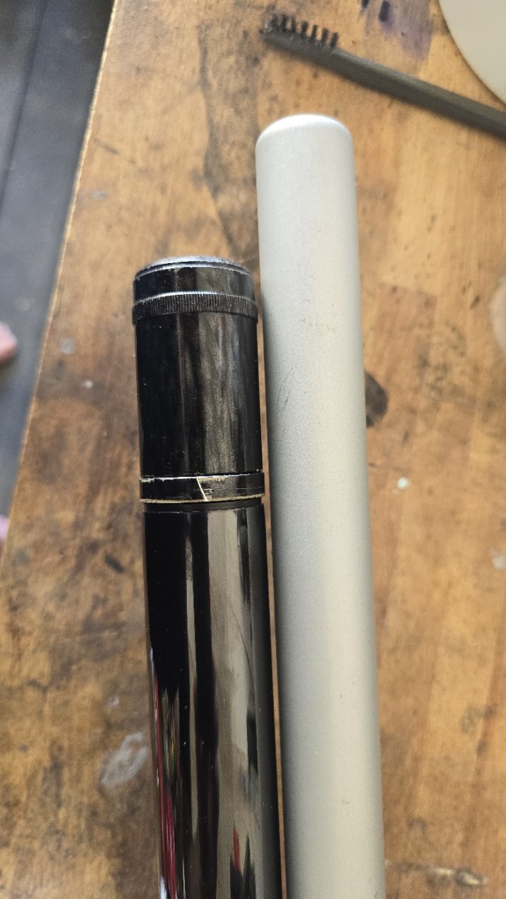

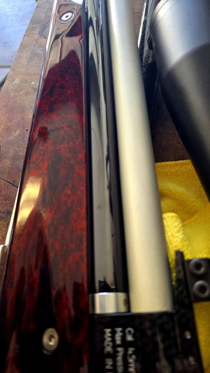

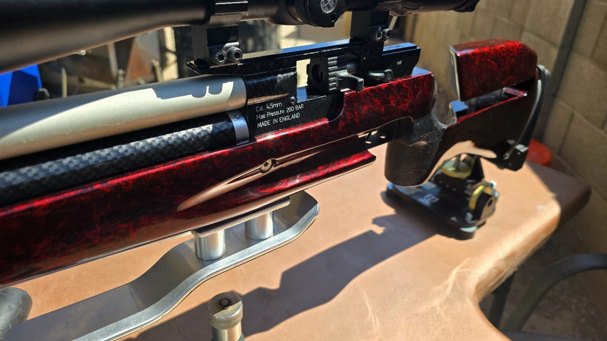

So got a new tube for mine today.
I got the 288cc blued tube from pyramid.
Gorgeous bluing.
Had my fill valve show up early and the post office did not ring the doorbell so they left notice for me to pick it up monday. Arggh.
Otherwise I would be shooting it tonight.
Got the Huma moved over to the new cylinder, and all reinstalled all I need now is the fill valve and I can start dialing this in again.
I will post up some pictures in a little bit.
Reactions: BSJ

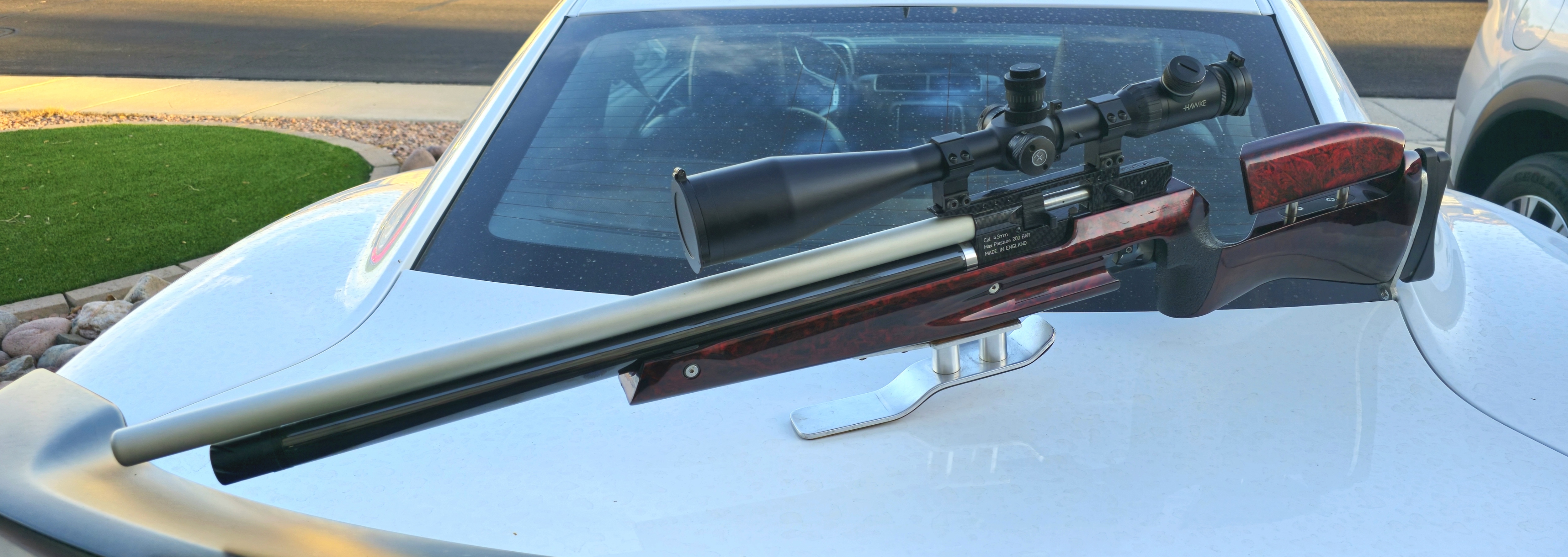

So got it filled and after about 20 mins of letting the steel cylinder cool. (they do get hot filling from 0 bar to 200 bar even when filling slowly)
It was time to shoot and see if it was all worth it.

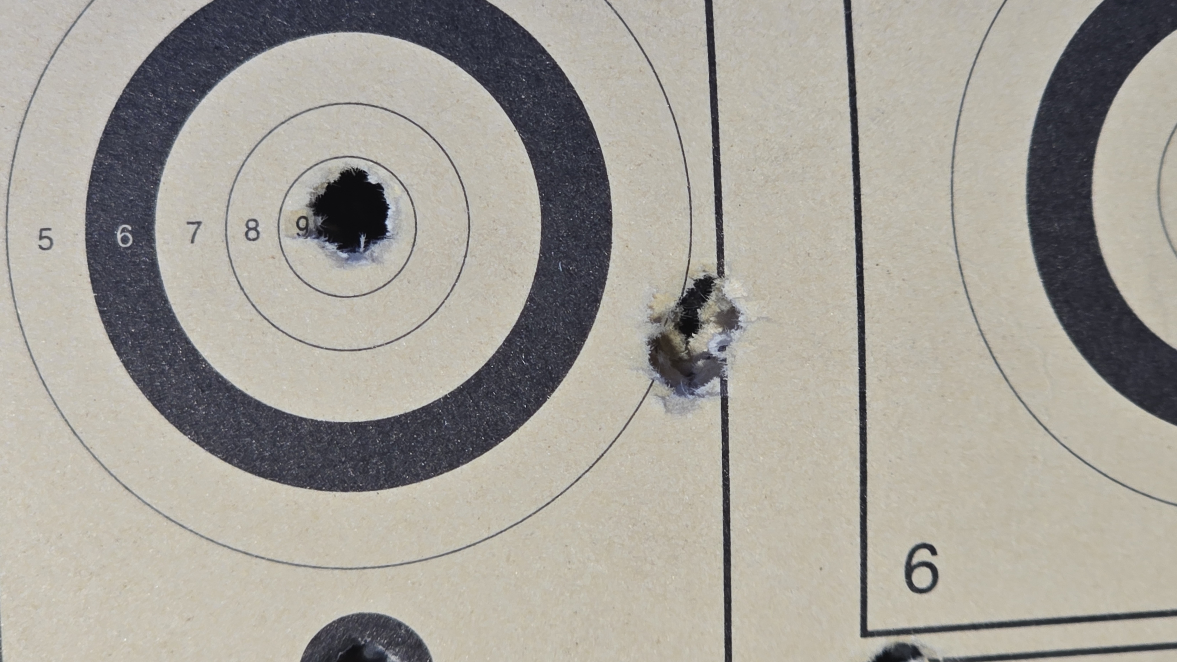

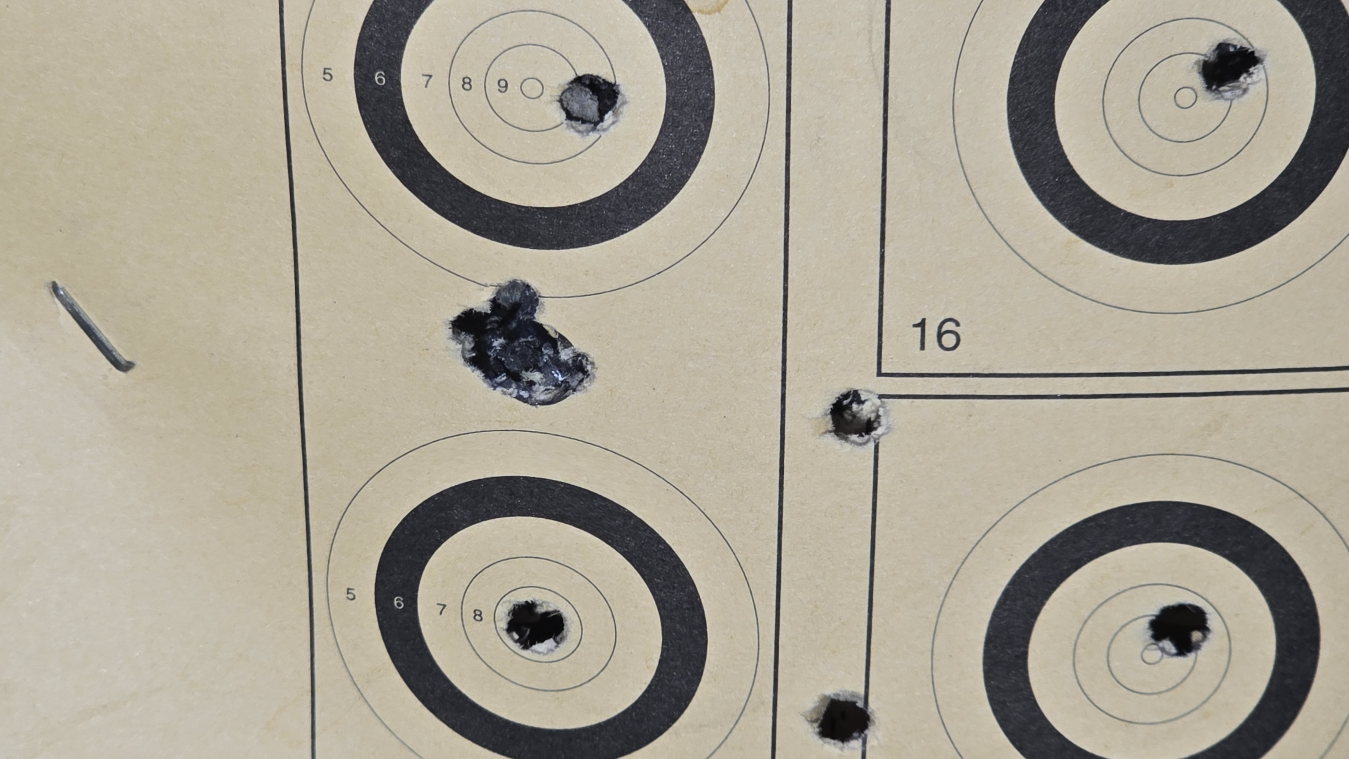

I shot a 3 shot group and zeroed the scope and shot this on the first try. Ignore the shots tot he side that was a friend that was over shooting this weekend shooting with my Crown.
Pleased with what it was doing on the first 4 shot since installing the cylinder and fill valve, I thought lets try a group and see if we can get some serious grouping.
Before I share that I want to say it is monsoon season in Phoenix and while we do not have any storms tonight we do have some mild gusting winds.
Yeah this gun was worth all the wait and the guessing while it was away getting resealed.
This is 30 shots with the new JTS .177 8,.7 gr pellets straight from the tin.
I think this will work.
Should get even better with some practice and calmer wind conditions.
This is at 22 yards.
Ignore the shots above and to the right, The middle sighter is the one that has 30 shots in there other than 1 flyer
they would all likely be 10 ring shots. Not bad for the first real outing!!

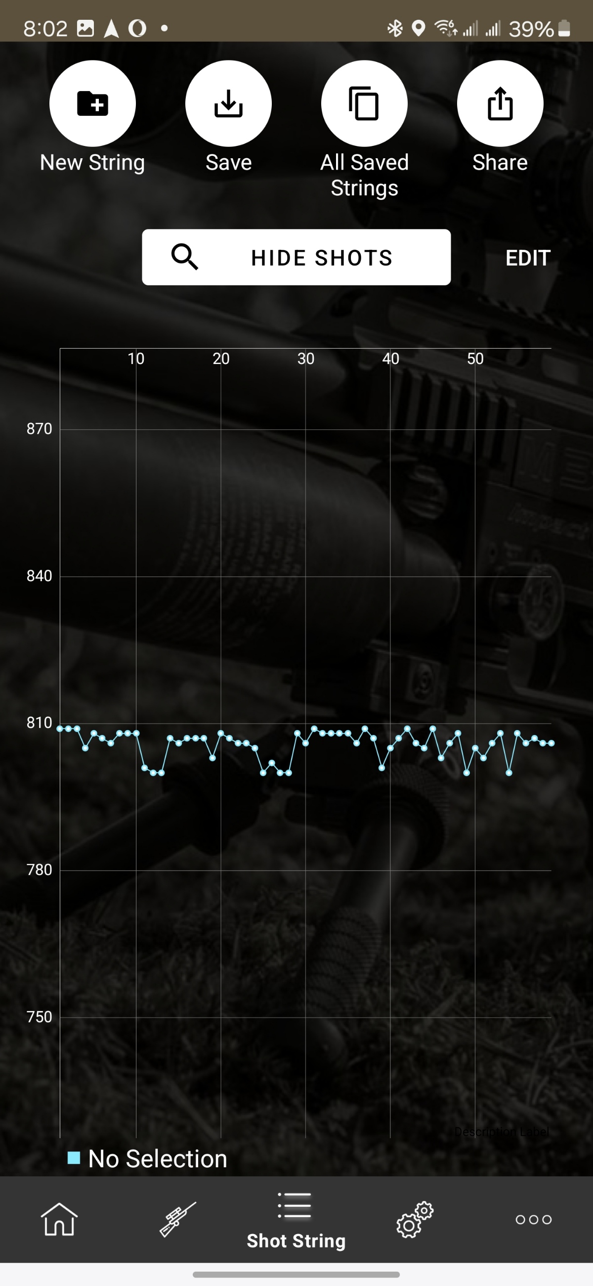

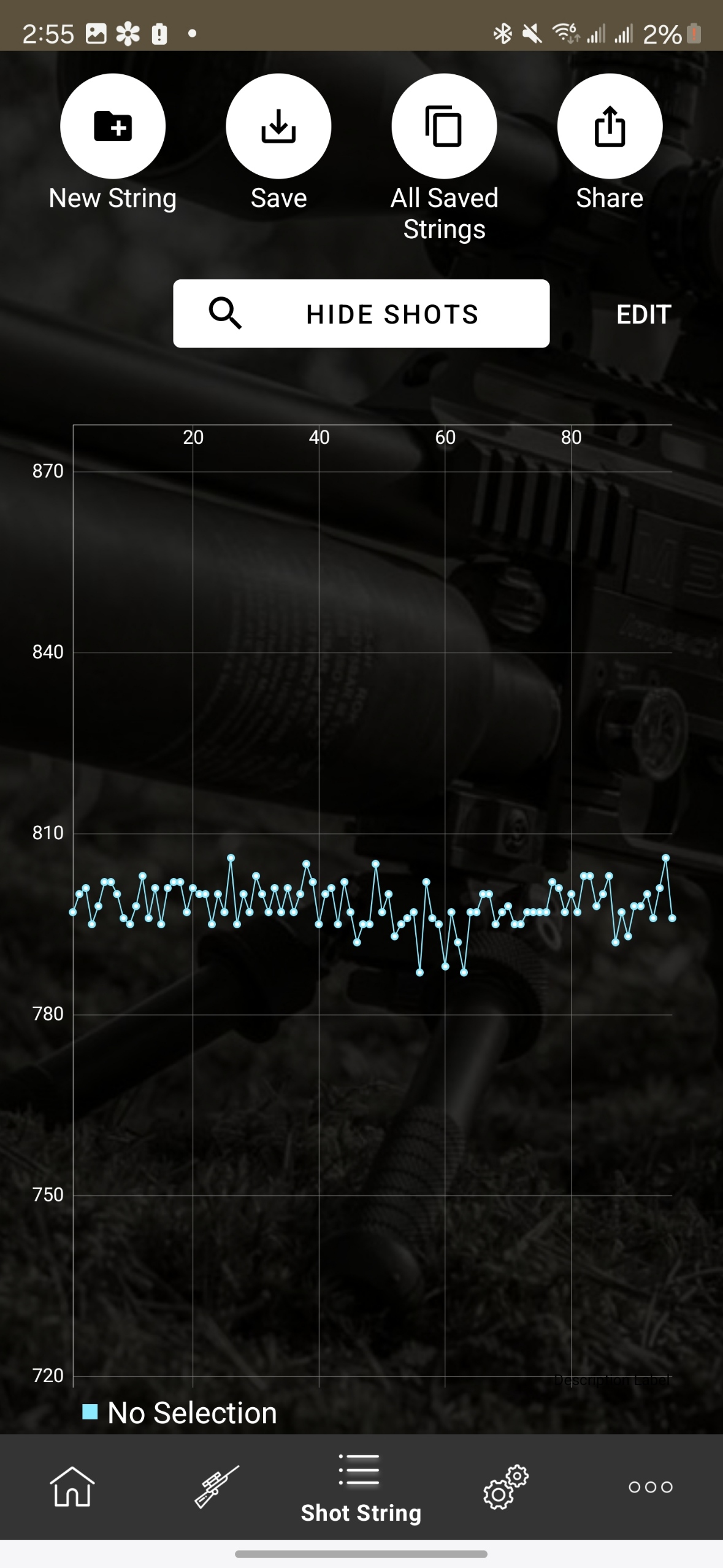

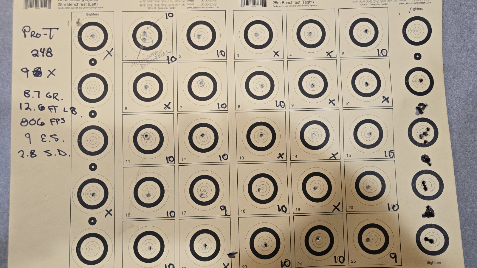

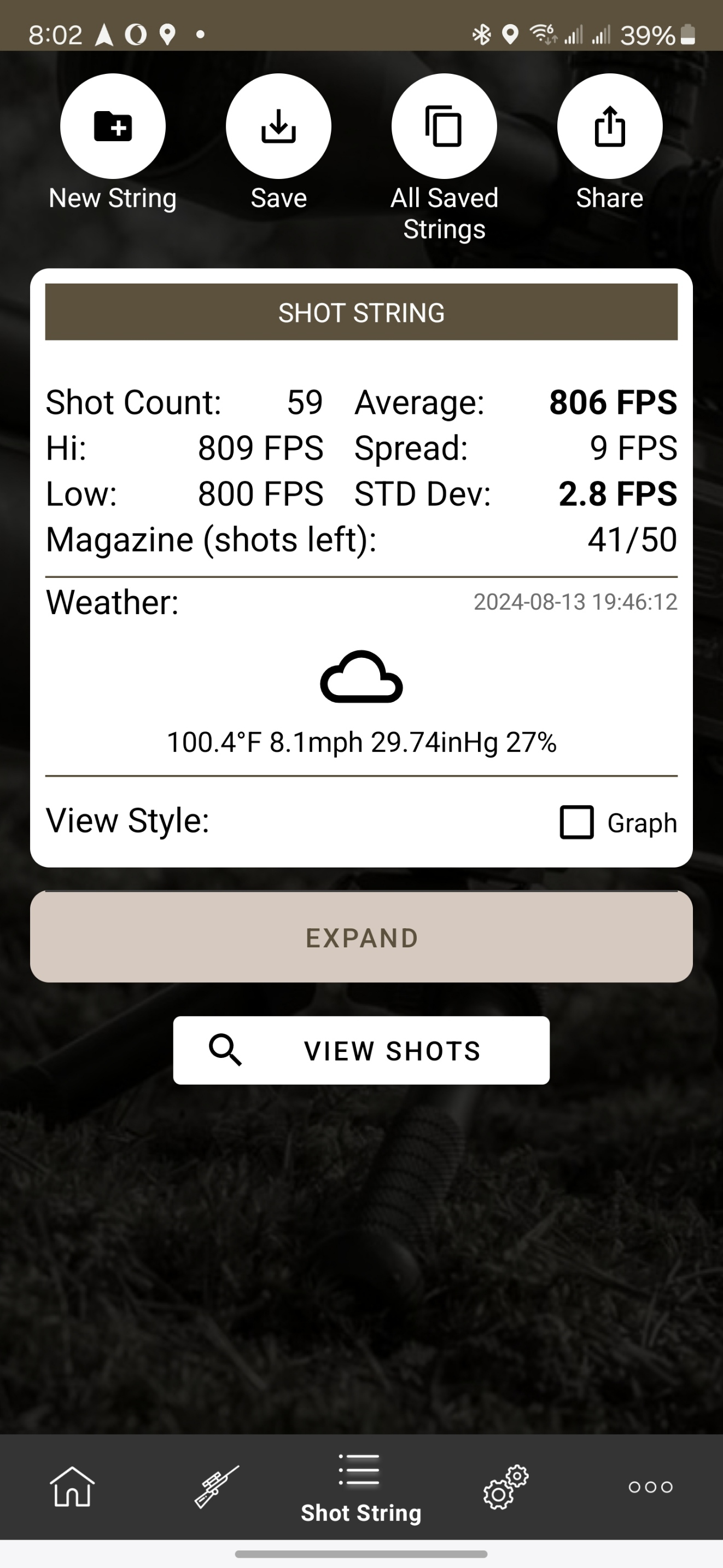

So I got my FX pocket chrono out and did a little testing and shoot my first card with this gun.
I will say I am pleased.
With 8.7 JTS, she is shooting right at 806 fps average for a 12.6 ft lb level.
A half turn of the hammer and she is under 12.
So how did she do??
Fantastic!
using plugging for 22 cal. it worked out to a 248 9X out of 250 possible.
This is with 8mph winds gusting like last night.
Chrono results also very encouraging ES of 9 fps, and SD of 2.8.
Also shot about 75 shots tonight overall (not all were done on the chrono) and air dropped from 200 bar down to 150.
So should be in the 120-130 shot count range for a fill.
Now need to get some practice and improve on this card.
The gun can do 250 cards, I am sure of that, I just need to readjust from shooting my Crown at 33 ft lbs. to shooting this at 38% of the energy.
The wind can definitely move these pellets around more.

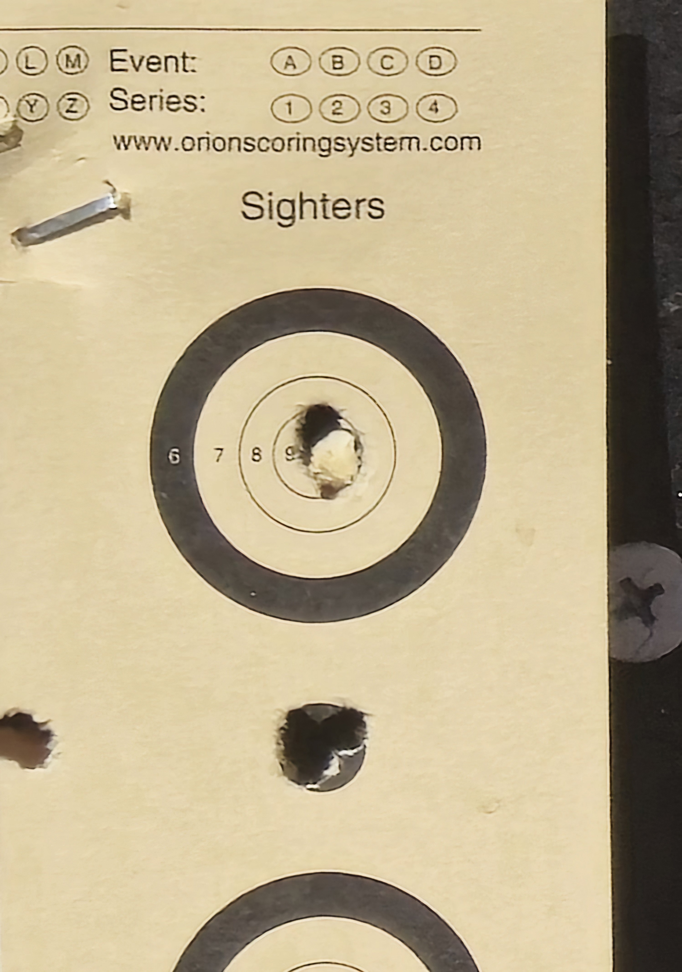

For those that do not know.
Plugging is making your shot hole the size of a 22 cal hole.
The Orion scoring system is based on this for 25 meter competition.
2 of my shots were on the 9 ring and missed the 10 by a small amount but they are 177 cal and when you enlarge them to 22 they easily were 10 rings shots.
Wanted to clarify that before someone calls BS on the declared score.
