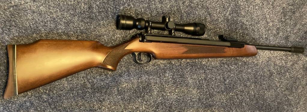

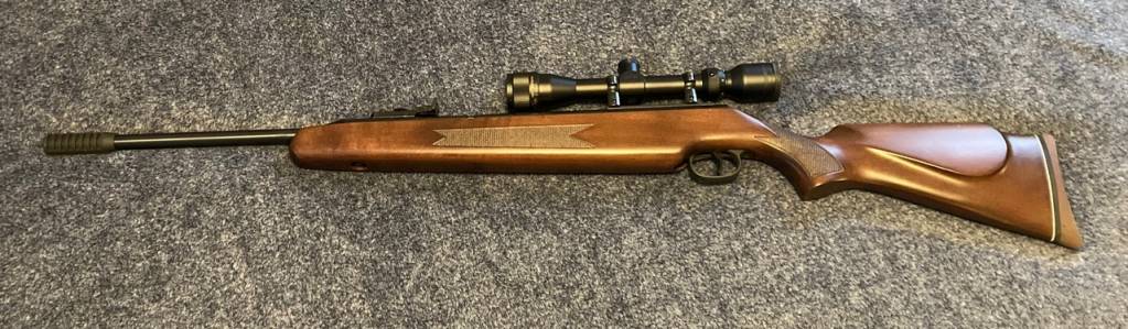

Bought this vintage 1990 Diana 52 this morning from the original owner. It's in immaculate condition except for a couple small dings on the cheek rest. Included the box, a tin of pellets and the original front sight. It came with a Tasco 2x7 AO air gun scope too. It was shot very little.
I got it all for $275, I think a decent price. It joins my 1973 Weihrauch HW35, a rifle I really enjoy shooting and recently rebuilt.
As soon as I got home I took it down to my basement and zeroed the scope @ 10m and tried a few different pellets just to get a idea as what I can expect.
This is by no means a extensive review or anything like that, Just my first impressions and I know it will shoot better groups, as I only tried a few brands of pellets and have 64 year old eyeballs ..
I also realize I may need to work on the scope mount if /when it starts shifting on me.

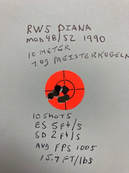

Here are the numbers from a 10 shot string. I think they are pretty good.
Meisterkugeln Pellets 7.0g
RWS Diana 52
Digital Link
Temperature: 66
Pressure: 29.3 in Hg
Bullet Weight: 7
Power Factor Average: 7
Power Factor Low: 7
Power Factor High: 7
Number of Shots: 10
Minimum: 1003
Maximum: 1008
Spread: 5
Average: 1005
Standard Deviation: 2
# Velocity Ft/lbs Power Factor Date
10 1006 15.73 7 1/5/22, 12:23 PM
9 1005 15.70 7 1/5/22, 12:23 PM
8 1004 15.67 7 1/5/22, 12:22 PM
7 1008 15.79 7 1/5/22, 12:21 PM
6 1003 15.64 7 1/5/22, 12:21 PM
5 1005 15.70 7 1/5/22, 12:20 PM
4 1007 15.76 7 1/5/22, 12:19 PM
3 1003 15.64 7 1/5/22, 12:19 PM
2 1005 15.70 7 1/5/22, 12:18 PM
1 1008 15.79 7 1/5/22, 12:17 PM
10 shoot group
