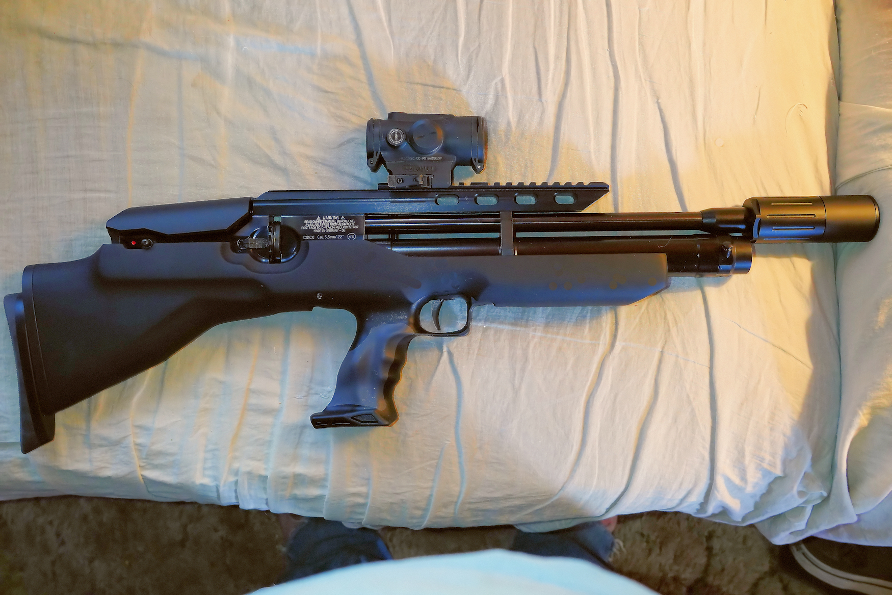

I just furnished shortening this two days ago. Still shoots great, and it's a LOT better looking that when it was 3ft ong. In my case, I did lose the choke that they are supposed to have, but many guns don't have a choke and shoot just fine. So far, this one's doing very good.
No one had the shorter Carbine in stock, so I bought the long version and began whittling. Only lost a few FPS, I ended up slowing down even further, so no big deal. It's got a longer air cylinder in the K version too. Overall, with the two section Huma, it's only about 1-1/4" longer than the shorter Carbine version, but...with more air.

I have a .177 short bullpup . Replaced the short barrel (sorry, don't remember length) with the 16.5"ish barrel. Added a longer Ratworks aluminum air cylinder and doubled my shot count and still reduced the overall weight slightly. Absolutely love it now. So much that when a used .22 came up on AoA website I bought it and did the same thing. Hadn't considered cutting off the lonnnnng .22 barrel. Think I might give that a go based on what Mike says. I'd really prefer the .22 with a barrel length in the 18-20" range, just figured I'd ruin the accuracy if I cut it down. BTW, changing out the barrels is super easy.

Outstanding transformation on that pup!
That rig has got to be like a surgical instrument on pest critters. Do you hit the woods for squirrel meat with it?

Not really, not and have room for the muffler !
Since I shortened the long barrel, I could have made it any length that I want. But with the air cylinder that's on the gun, and the Huma muffler, it's just about as short as I could make it.
Unless I don't run any sort of suppressor, but I can't do that. It needs something to keep it quiet.

No, I'm in the city, so all I hunt is little black dots on paper !
Not much room for any sort of shroud either. The barrel is .621" o.d., which is pretty large., The cylinder to barrel clamp is only about .12" thick, so there's really no room for any air gap, between the barrel, an the inside of a tube, without it hanging outside of the clamp.
I do plan on finding something to act as a shroud, but knowing it isn't going to do anything but make the barrel look a little larger in diameter !
