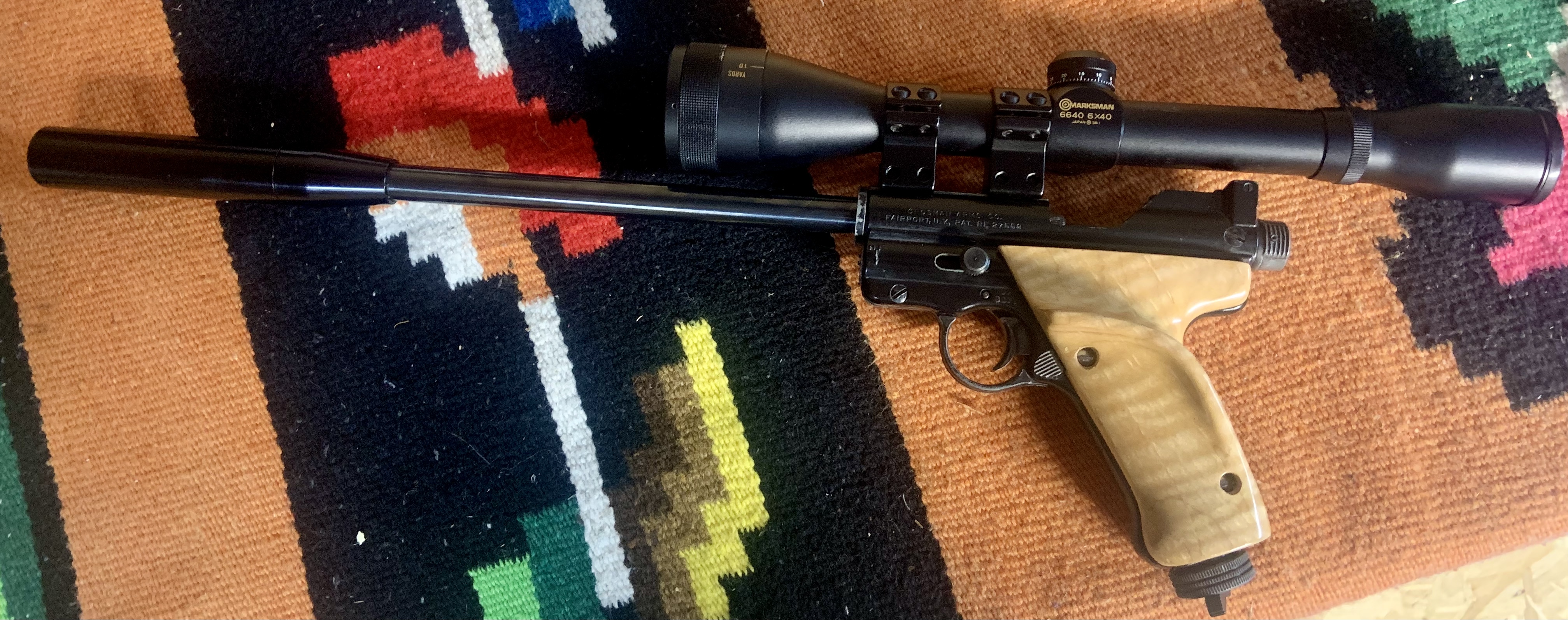

I picked this up in trade at the Midwest airgun show yesterday. I had one years ago, and let it go. I've been wanting one again for awhile and finally came across this one. I forgot how marvelous they are! It's running just shy of 10 ft. lbs. with 13.43 gr. JSB Jumbo RS pellets. Still;ll working on the accuracy department. The scope and rings aren't working out too well for me. I'm shooting about 10" high at 10 yards, even after placing a shim under the scope in the front ring. Anyone have recommendations for scope/ring combo for a "taco" hold?

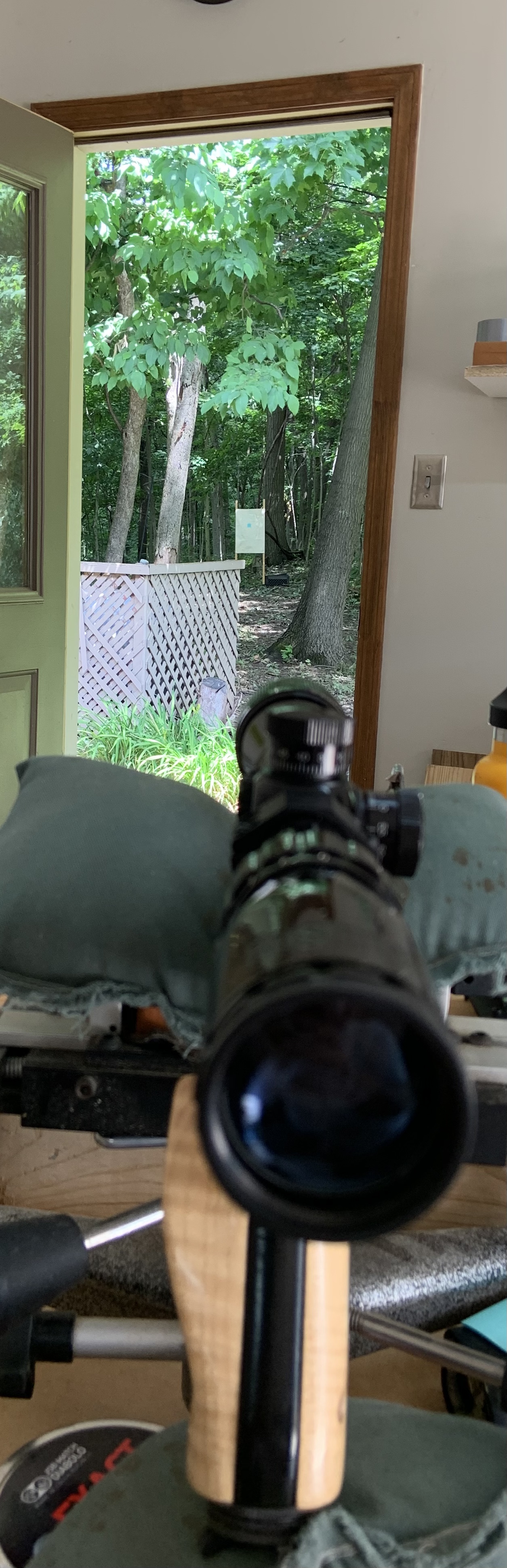

i have a bad habit of downloading picture and enlarging them, now in this case the rear ring seems to be much higher on the dovetail then the front one
and i don't think shimming the front ring is going to correct the 10 inches
put the front on the rear and retest or find some new rings
I think that's the pic angle, but I'll give it try tonight.

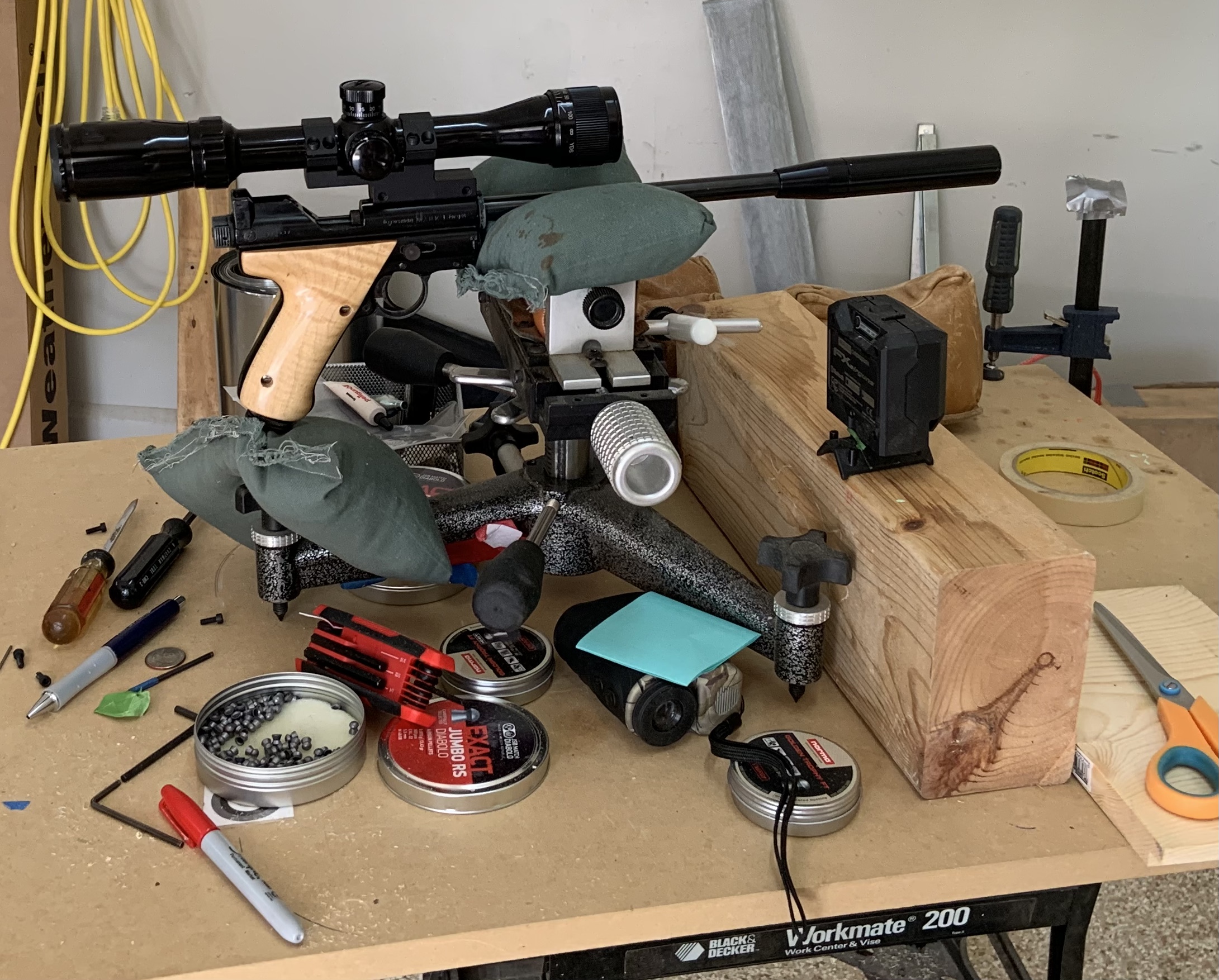

I chance to work with the LD today. I changed the scope mount out and scope (Bushnel Sportsman 3-9x32). I optically centered the scope and at 15 yards, I was 5.5" high. I placed a shim that I cut out of a pellet tin under the scope at the front ring. That brought it a little under an inch high. I mad some scope adjustments and then took it out to 25 yards (see target pics). It was a bit windy and the pellets aren't weighed or inspected, just shot right from the tin. I also had few shots where I only cocked into the low power setting by mistake, and had some low shots. I got about 25 full power shots, just under 10 ft. lbs and if I was a hunter, I wouldn't hesitate to use this on a squirrel out to 35 yards.
