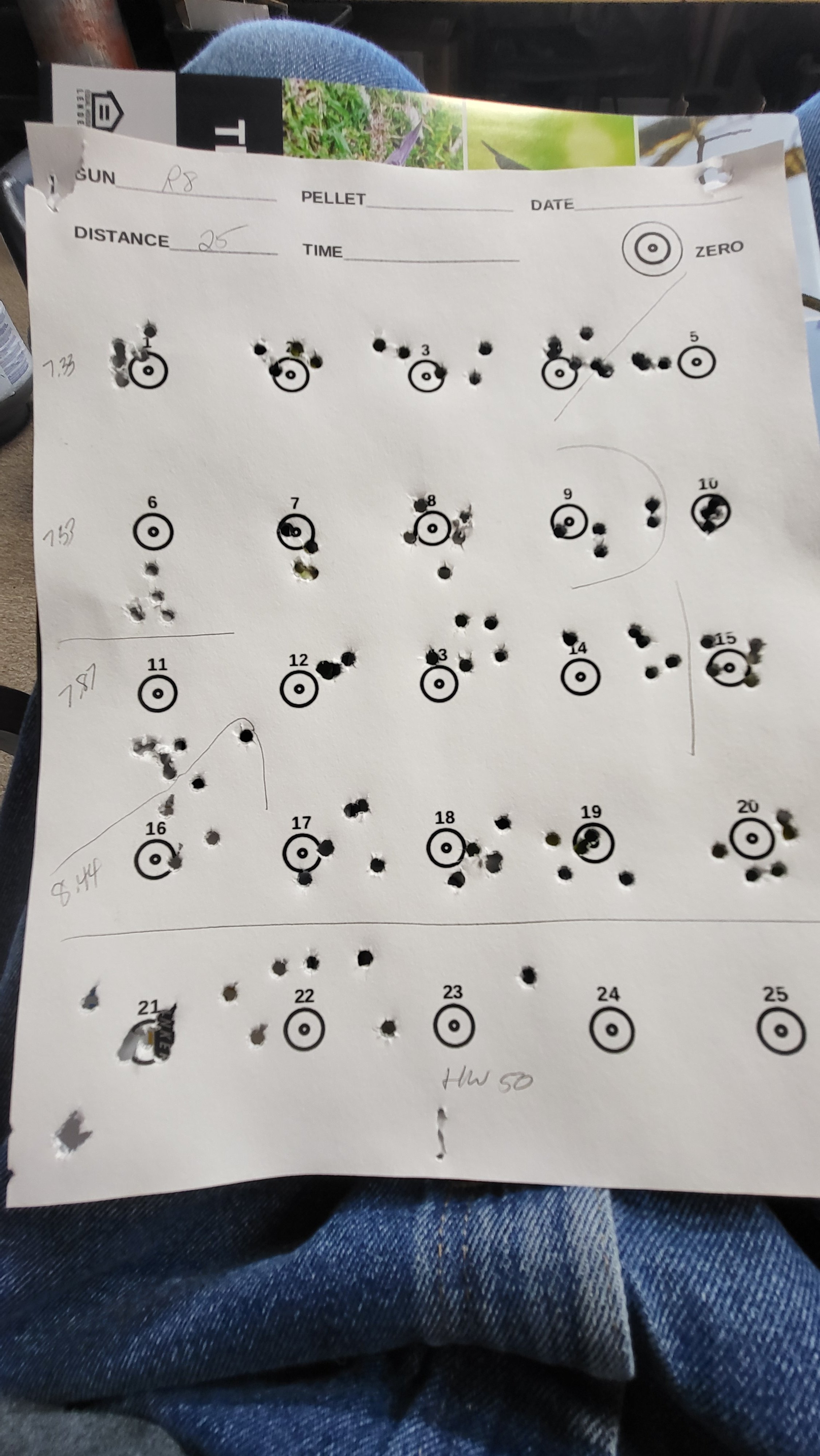

Back to the R8. I aligned the barrel within one dial rotation up at 25 yards and half a rotation left. I shot this target with a bit of a left to right quartering head wind. Still some really good groups in there for the conditions. The worst ones were from accidentally changing my hold.
I broke out my modern 50 and it didn't shoot as well out of the rack but I have to say I like the way it handles much better than the R8. I might be looking for a trade soon.
