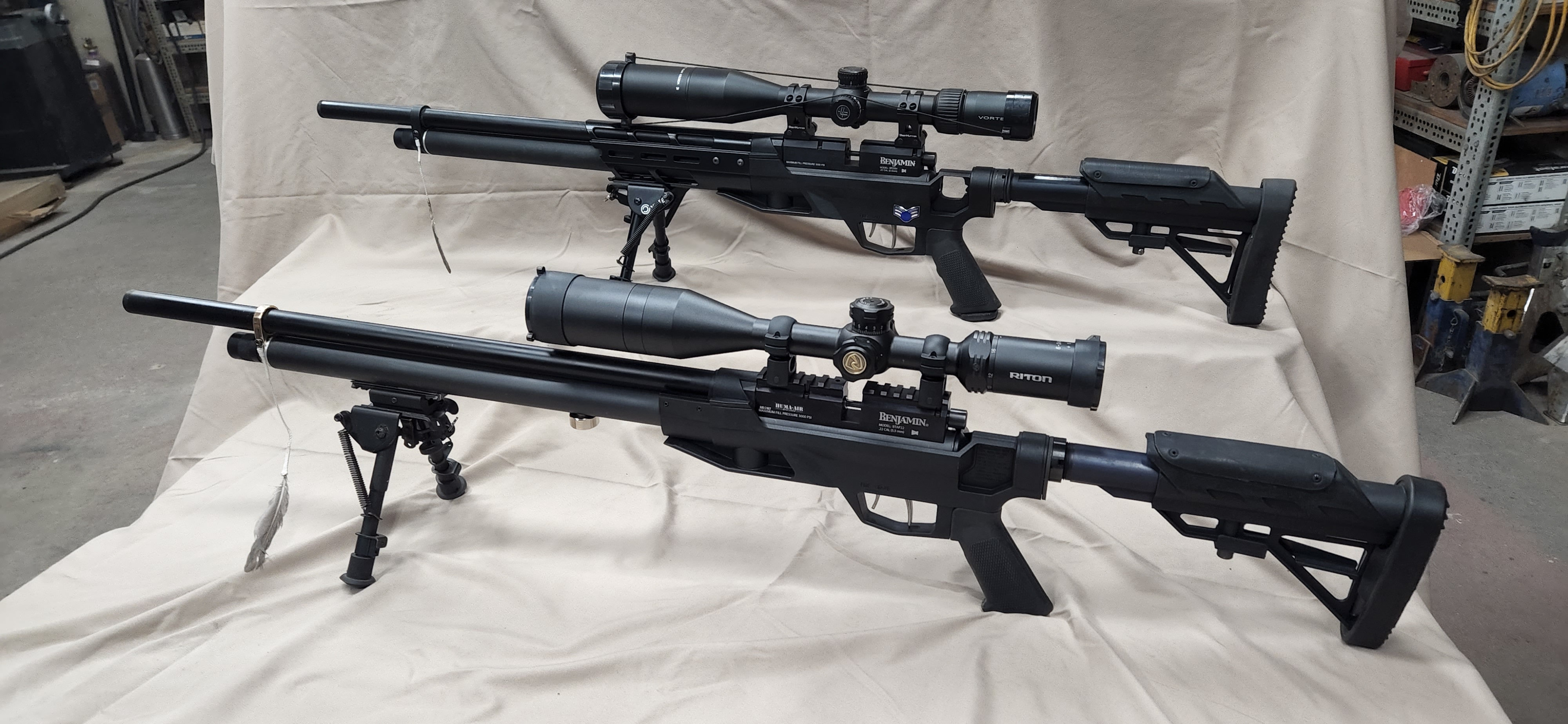

Hello Gaplinker, I just came across your post from April. I am am Armada owner as well. Don't see very many on here. Mine is pumped up for longer shooting matches, no hunting. Now I have a pair, one is actually stock Marauder. My Armada has 22 inch L/W barrel, Huma reg, and a bunxh of custom springs and personal touches.
