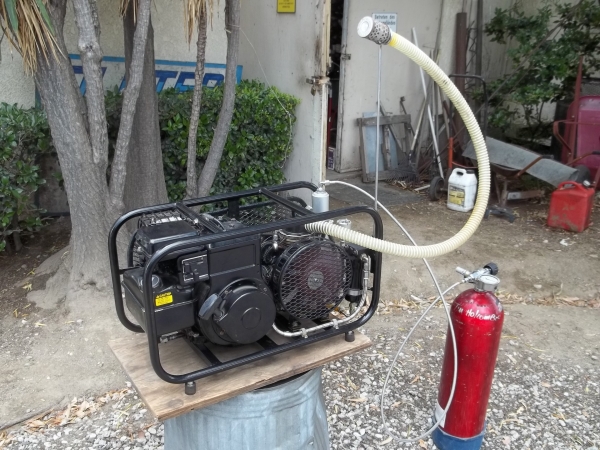

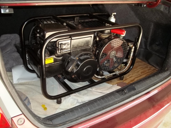

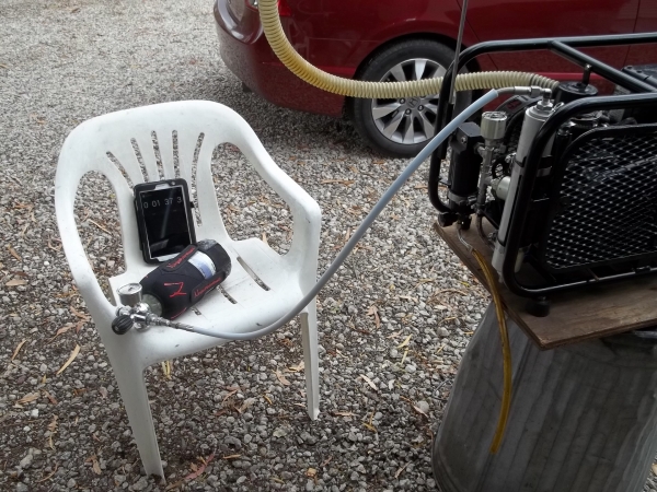

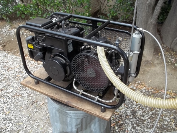

I've recently bought this used Walter Kidde 4.2 CFM @3000 psi ,and I'm really impressed with it .
We did fill a 80 cf aluminum scuba tank from 0 to 3000 psi in 20 minutes,and then,my Joe B. guppy tank, 120 ci from 2100 psi to 4500 psi in 3:30 minutes ! really fast and scary ,because of the mechanics of closing the tank valve and opening the the water separator drain to release the pressure on the hose(I spotted the gauge's niddle coming down from 5000 psi)

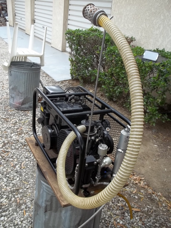

"Imold"That's one heck of a intake on that compressor.
Sure is! Me thinks the idea is to pickup air away from the heat of the engine. ??? Re. the AV compressor you're getting--please be sure and post back when you get it. What I've read sounds really good, especially at that price point. I'm sure you've pre-ordered one, right? I don't think there in stock anywhere. ???

I believe the intake extension is to prevent the exhaust from the gas engine from getting sucked into the intake of the compressor pump. This really isn't a problem if you're using the compressor to fill pcp tanks. It is a problem if you use the compressor to fill scuba tanks, then breath in the air while you're diving which might be mixed with carbon dioxide, which isn't good. I took the extension off my Honda powered Coltri compressor as I don't use it to fill scuba diving tanks.
