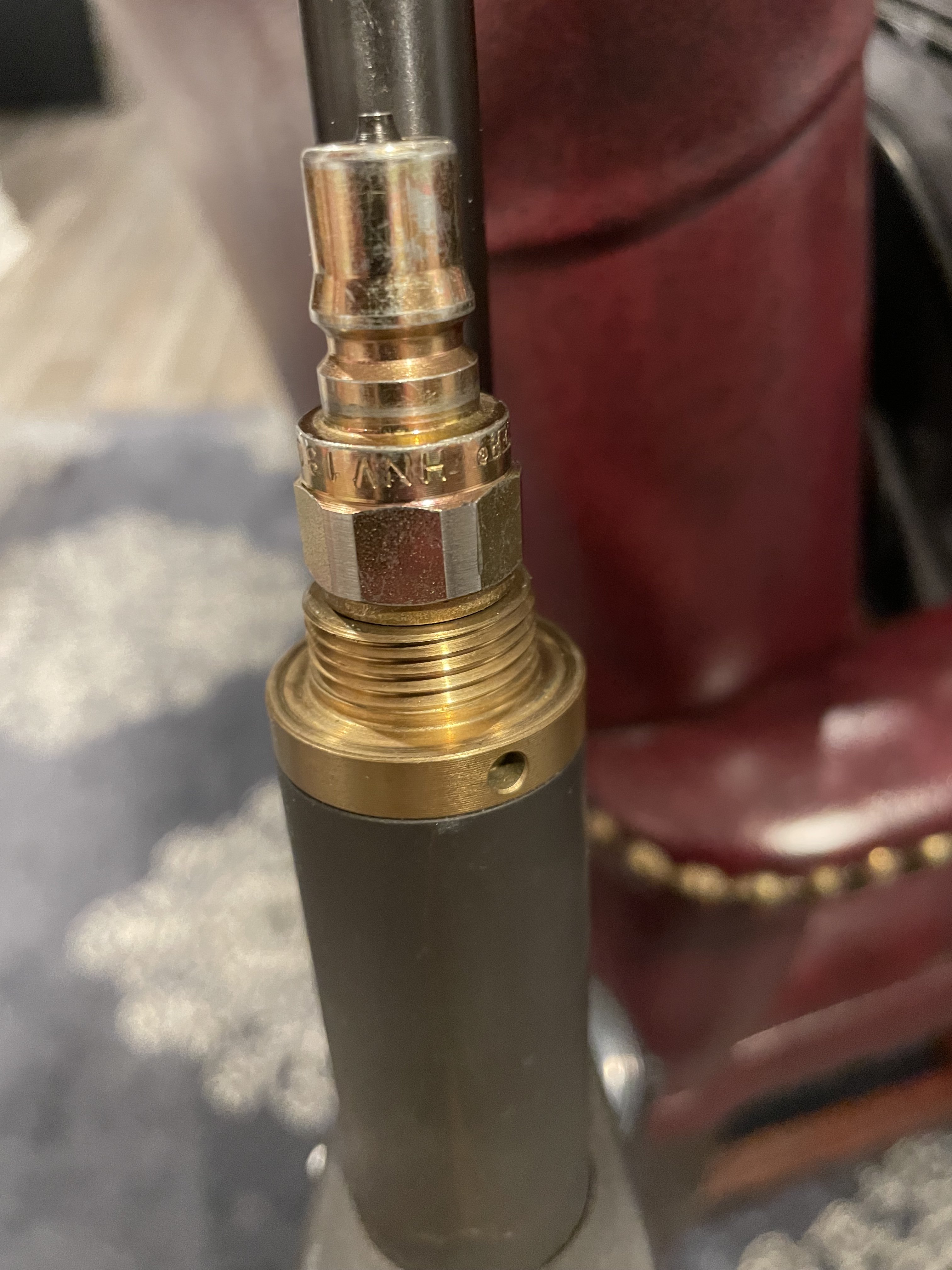

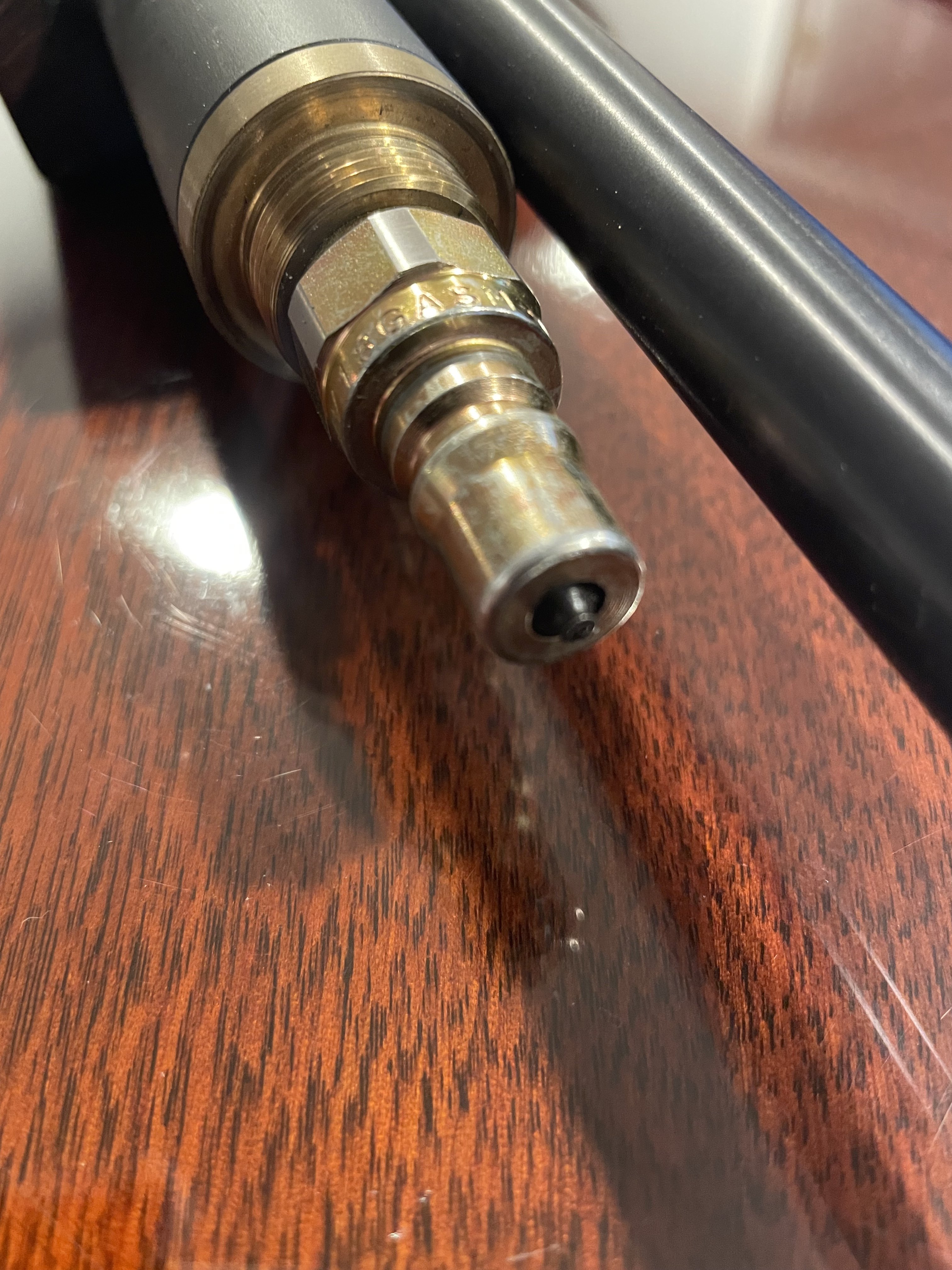

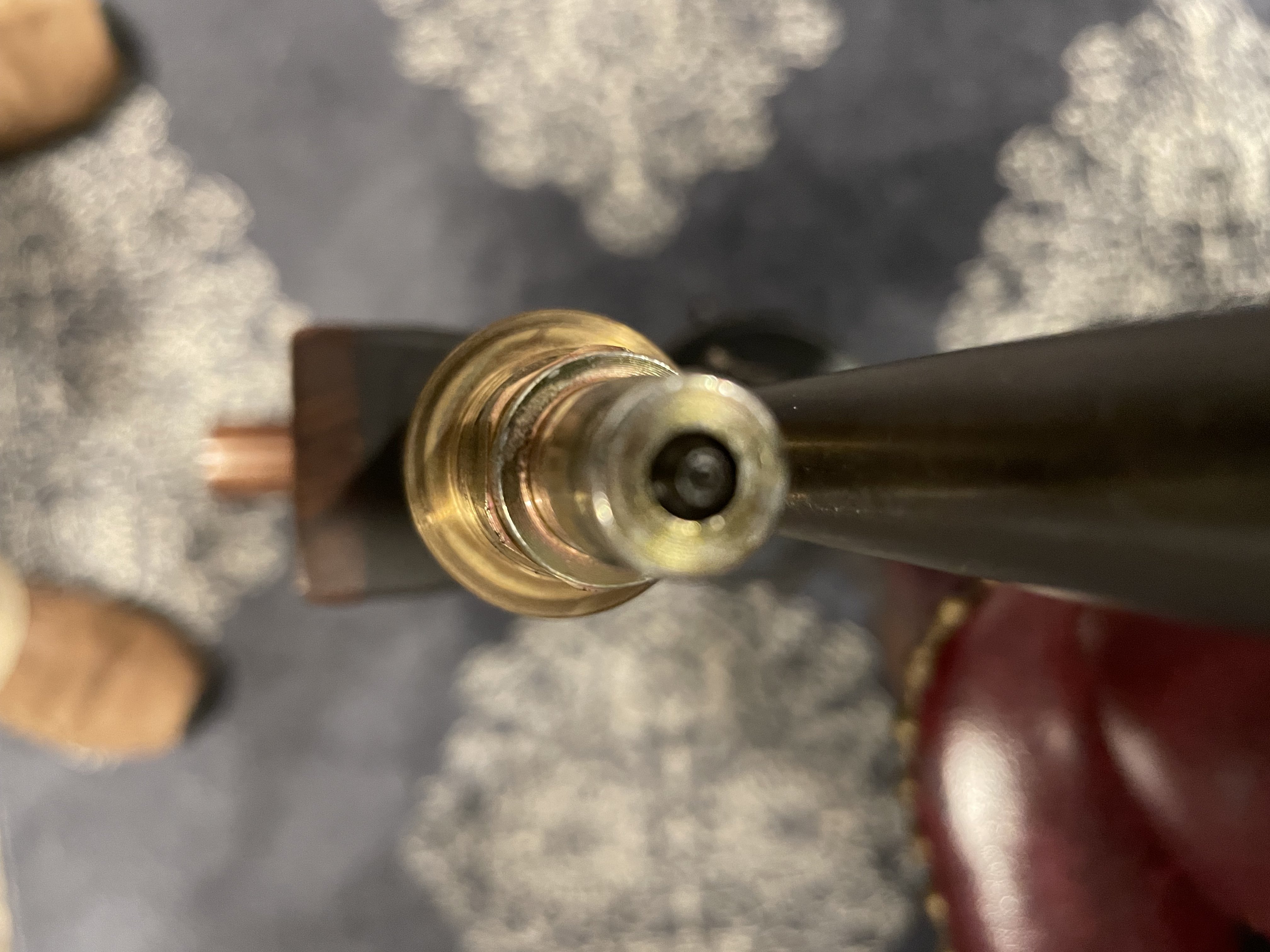

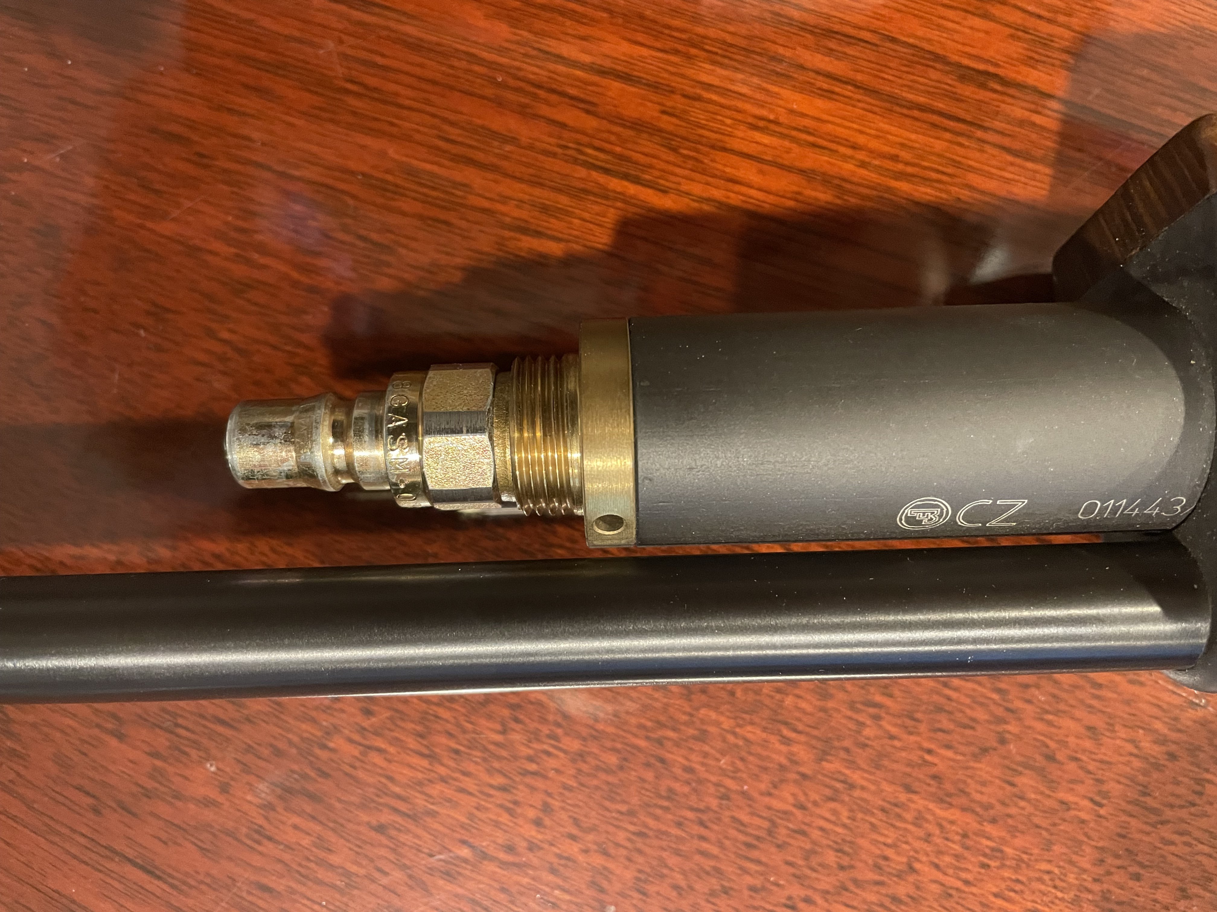

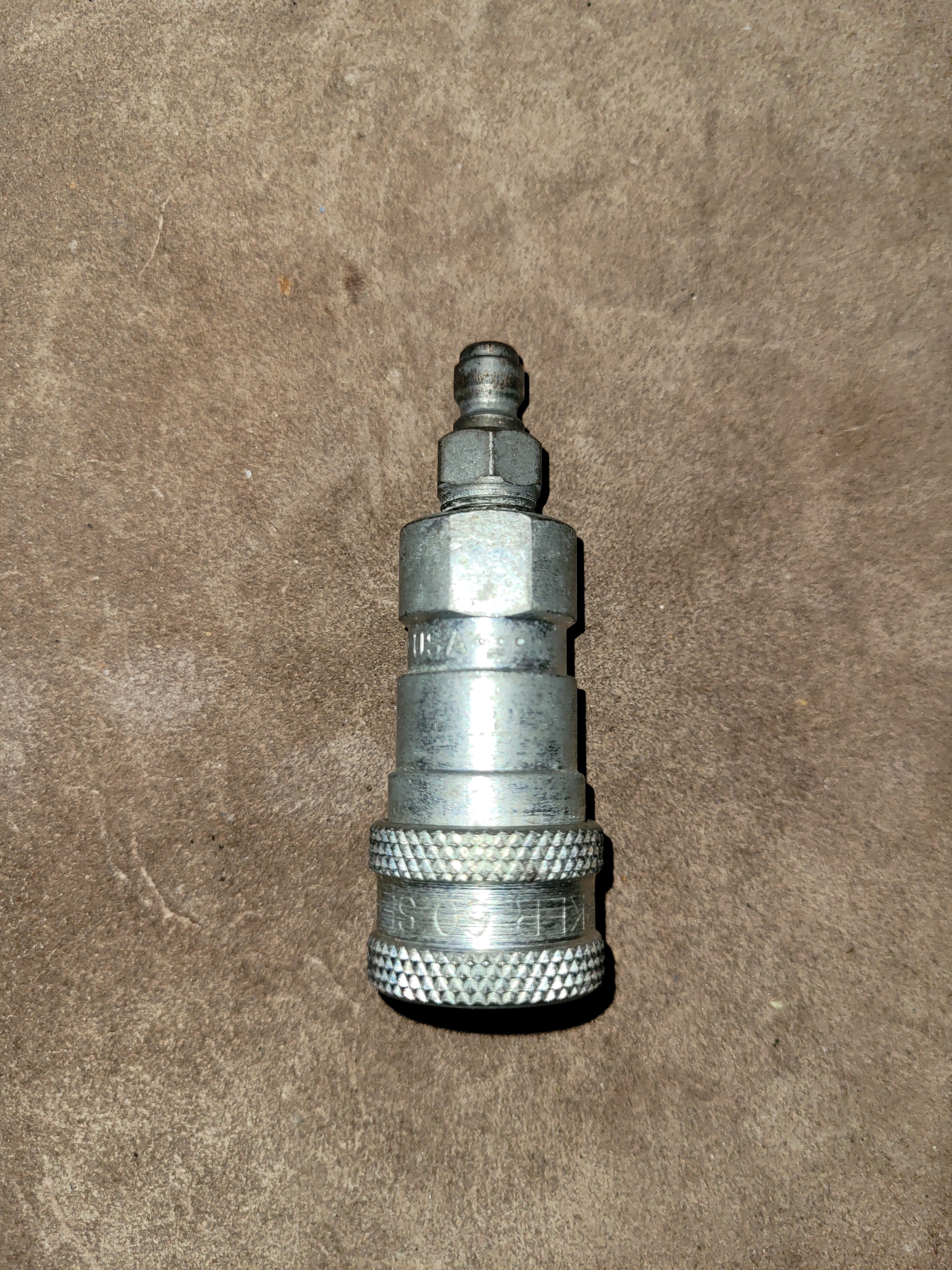

I recently ran across a CZ S200 at an auction and came home with it. It is the model with adjustable comb and butt plate. This is my first PCP and I need a bit of guidance. It came charged, so I know it holds air, but I have no clue what fitting I will need to recharge from either a tank or pump. The attached photos show the end of the air tank (removable if I am not mistaken) with the fitting under its black cap. I am hoping someone can give me some info as to what I have, what reciprocal fitting I will need to buy for the hose end of the air source etc.

I have no recharging equipment at present. I thought I would start with identifying what connection or fitting I have , and take it from there, whether that be a HPA pump or a tank. In looking at images on google and looking at videos I don’t see the fitting that is on the end of my air gun, so wanted to run past the air gun nation group for input as I am truly green on this aspect of airgunning.

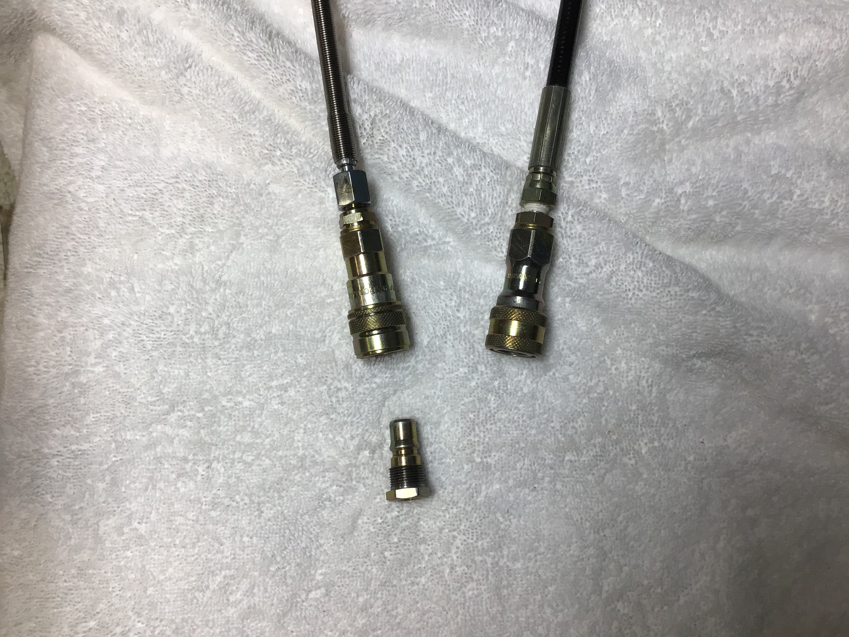

This is the adapter. $19 and probably be on sale friday.

Also check huma air. look under air arms s200 - they have add on regulators and a fitting to swap to a foster fill if you desire.

Shambozzie's connector advice is spot on.

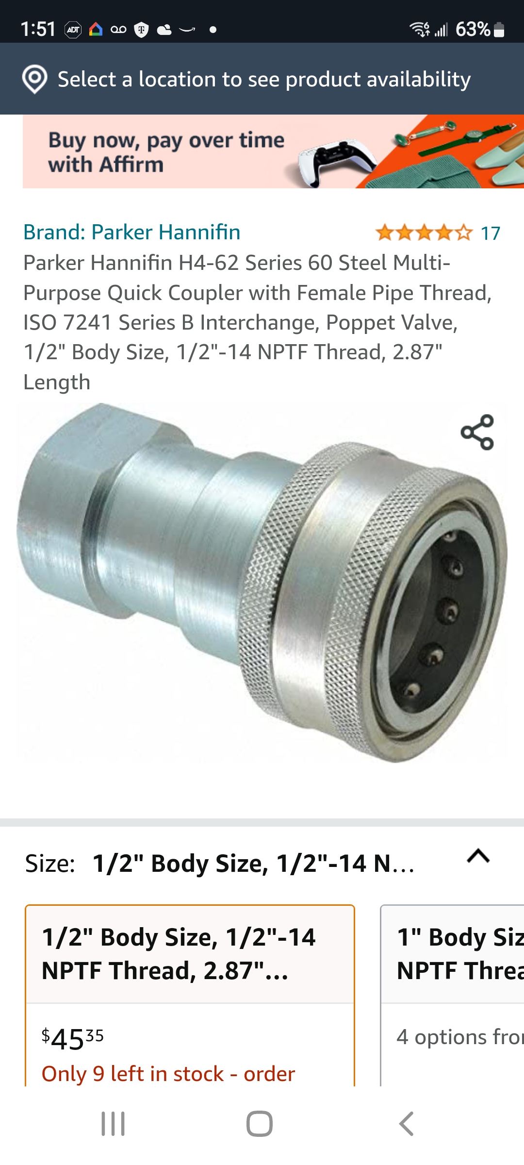

I have to ask though. In the string above Shambozzie and Heavyopp both recommended fittings. I am asking because I am learning….are these the same connection but different manufacturers? The PA link is less expensive but is marketed as an (older)AA fitting whereas the Amazon link is for a hydraulic type connection. These may be one in the same and as I am not yet versed in this, I‘m just trying to avoid purchasing the wrong item.
