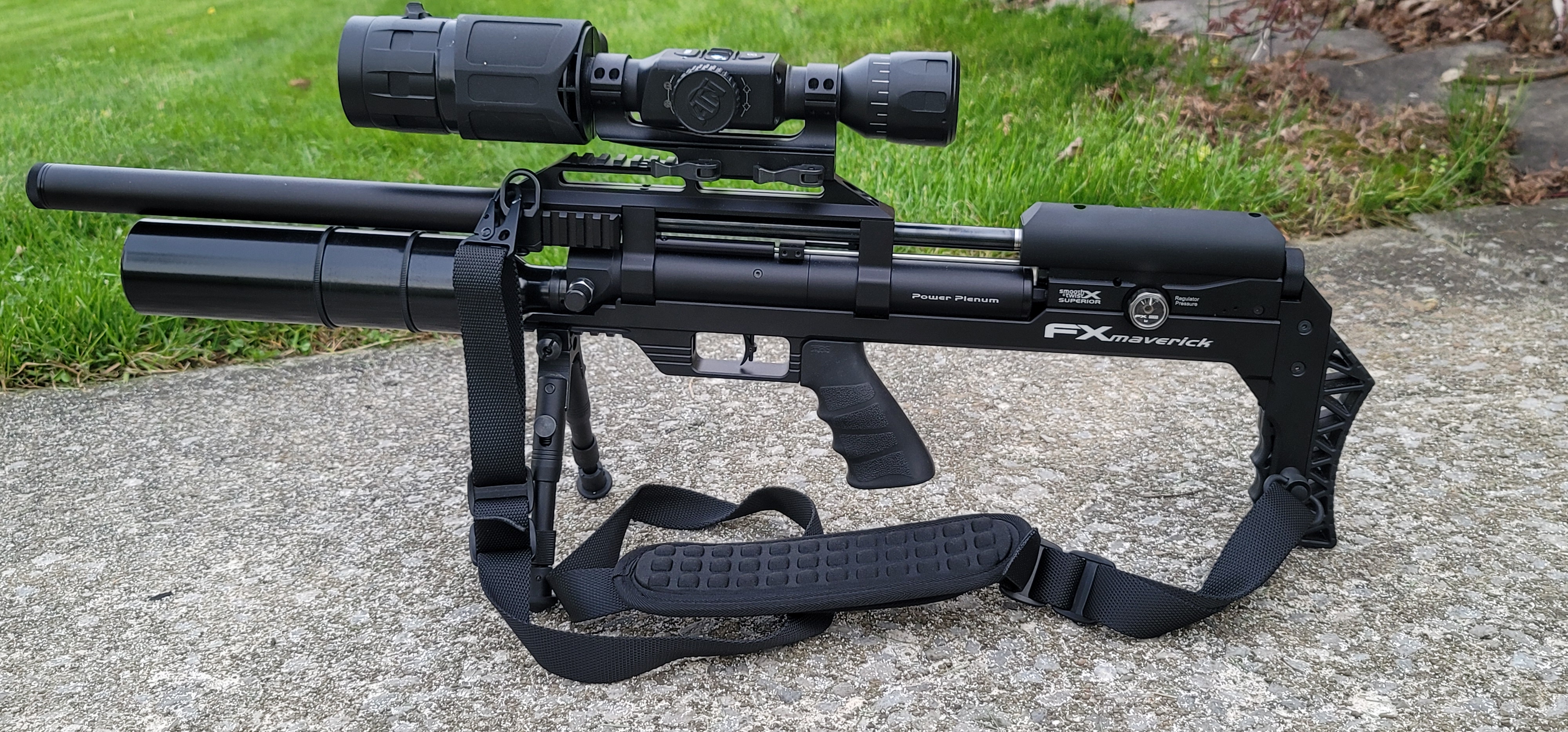

I have the Maverick VP in .30 cal, and I think it's an excellent mix of smaller size for hunting in the woodlands but still having plenty of power.
I did add a Magpul mount to allow me to have a 2 point sling in the low ready position. I have a DonnyFL Ronin suppressor attached which adds a bit to the length, but I have no issues shouldering it leaning against a tree.
View attachment 291269View attachment 291270
How'd you attach that rear sling mount? Sweet.
Thanks!
Originally, I had a hook clasp on the front pic rail, and I tried to repurpose the buttstock adjustment screw hole, but I wasn't confident enough in that implementation. So I ended up drilling a hole in the frame, and mounting a MagPul female connection point in place. It was just one screw and and one nut and some locktite red, and I was all set! I also added locktite red to the front MagPul pic rail adapter. I've walked at least 10 miles through woodlands on public lands over several days, and not be tired! It's so nice to have the gun in a position that I can just let hang in the low ready while I glass the trees and surroundings. I'm gonna make a separate post with the parts list so I don't hijack the OP's thread.

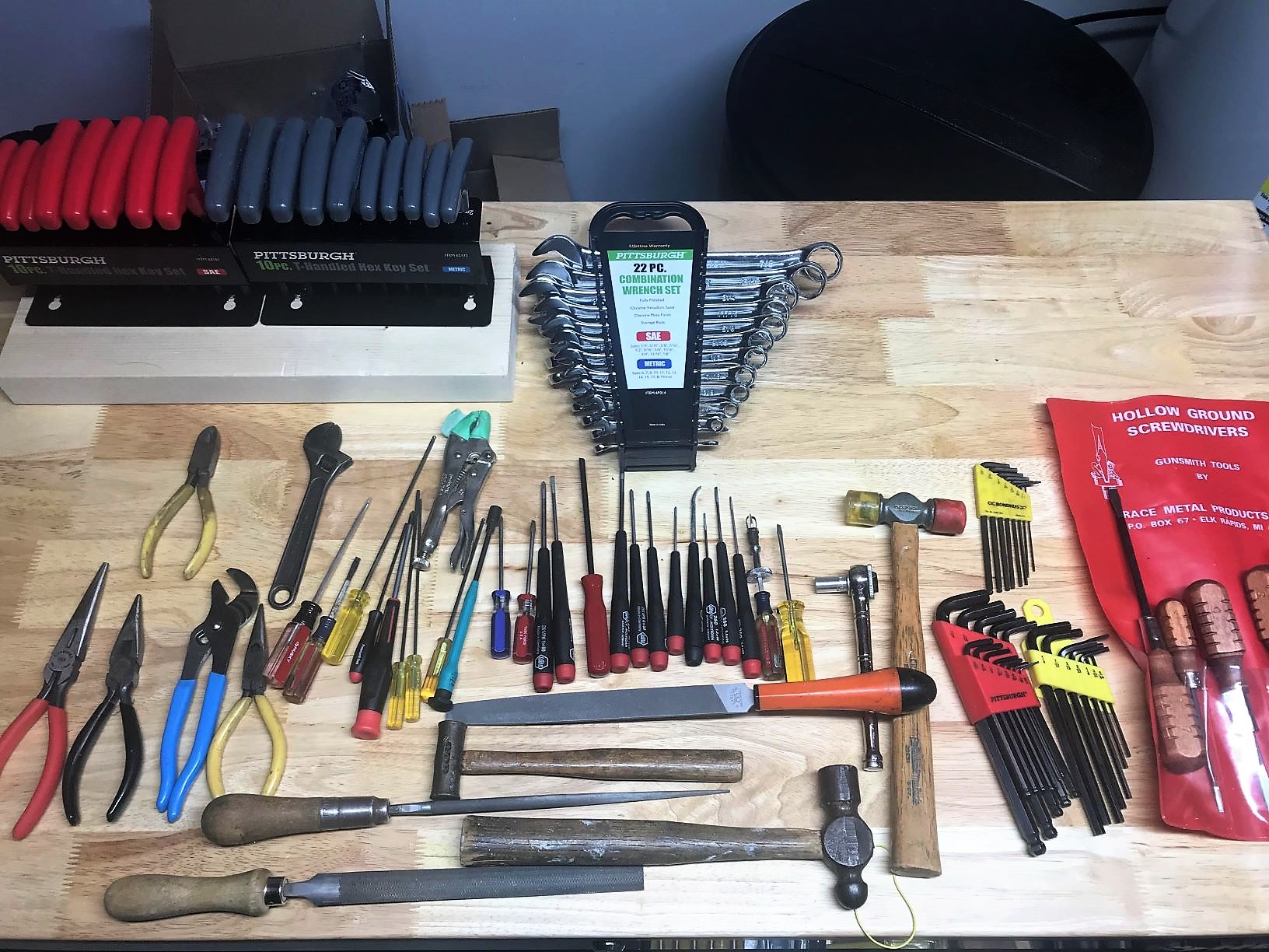

Decide which model gun you want and choose a reliable dealer. Ask him to set the gun up to what projectile you plan to use and what power level you want. Then leave it alone and shoot. Otherwise, your tinkering is at your own risk. Here's an FX tool kit for you.
View attachment 291382View attachment 291383
