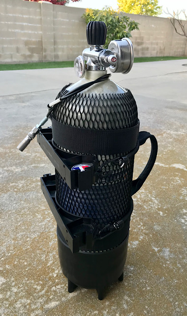

The larger volume tanks will have more fills per fill (A very good thing). Most importantly for me at least is one having dual gauges (one for tank one for fill pressure). I have a Joe Brancatto, TopGun-Aiguns/AirTanksforSale that has the dual gauges, slow fill valve and body armor, feet and carry handle plus a fill whip.
My fill set is from Joe B. I think he sells really good "stuff" but I don't choose to always pay that much for what I want. But if your budget allows, I would have full confidence in his bottles too.
