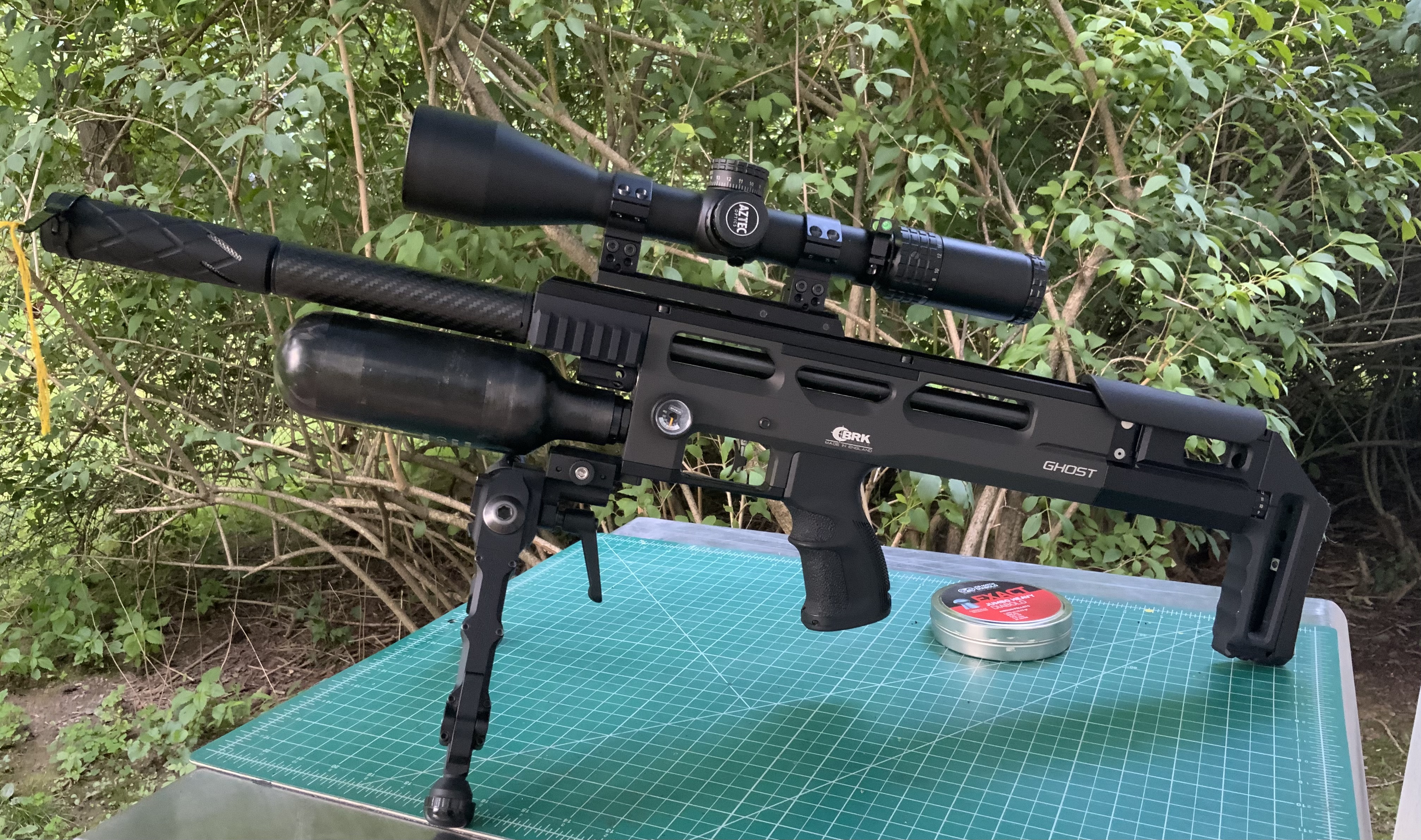

The other big thing to consider is length. A Ghost HP with a moderator stuck on the end of it gets pretty long. And if your planning on maxing out the fpe, you'll want a moderator in the end of the shroud.
My personal preference is my custom 18" .20 barrel in a full length HP shroud. All the extra room in the shroud makes it quiet enough to use without a moderator, when pushing 30-34fpe.
The closest commercial thing you're going to get to my custom .20 is a .22 Plus. That gets you a longer than Carbine shroud, and a 17inch barrel. With a modest tune, it should be quiet enough without an additional moderator.
The 17" barrel in Carbine form (shortest shroud) will require additional moderator at even 18-19fpe. The Carbines shroud is so short that it does next to nothing for sound reduction. So a Carbine + moderator ends up being Ghost Plus length anyways. In addition, you get a 480cc bottle with a Plus and only a 300cc bottle with a Carbine.
