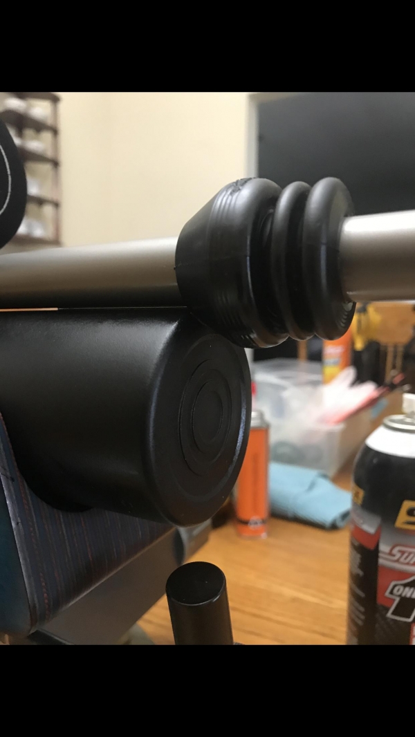

Been testing barrel damper placement too, with interesting results. I have a run of monsters that i could barely break 245's, so i been using the less desirable pellets for my damper testing. I shot this card placing the rubber damper against the bottle.
ill be testing/shooting more tomorrow...
oh this was shot in some decent 7-8 ring hold off wind.
