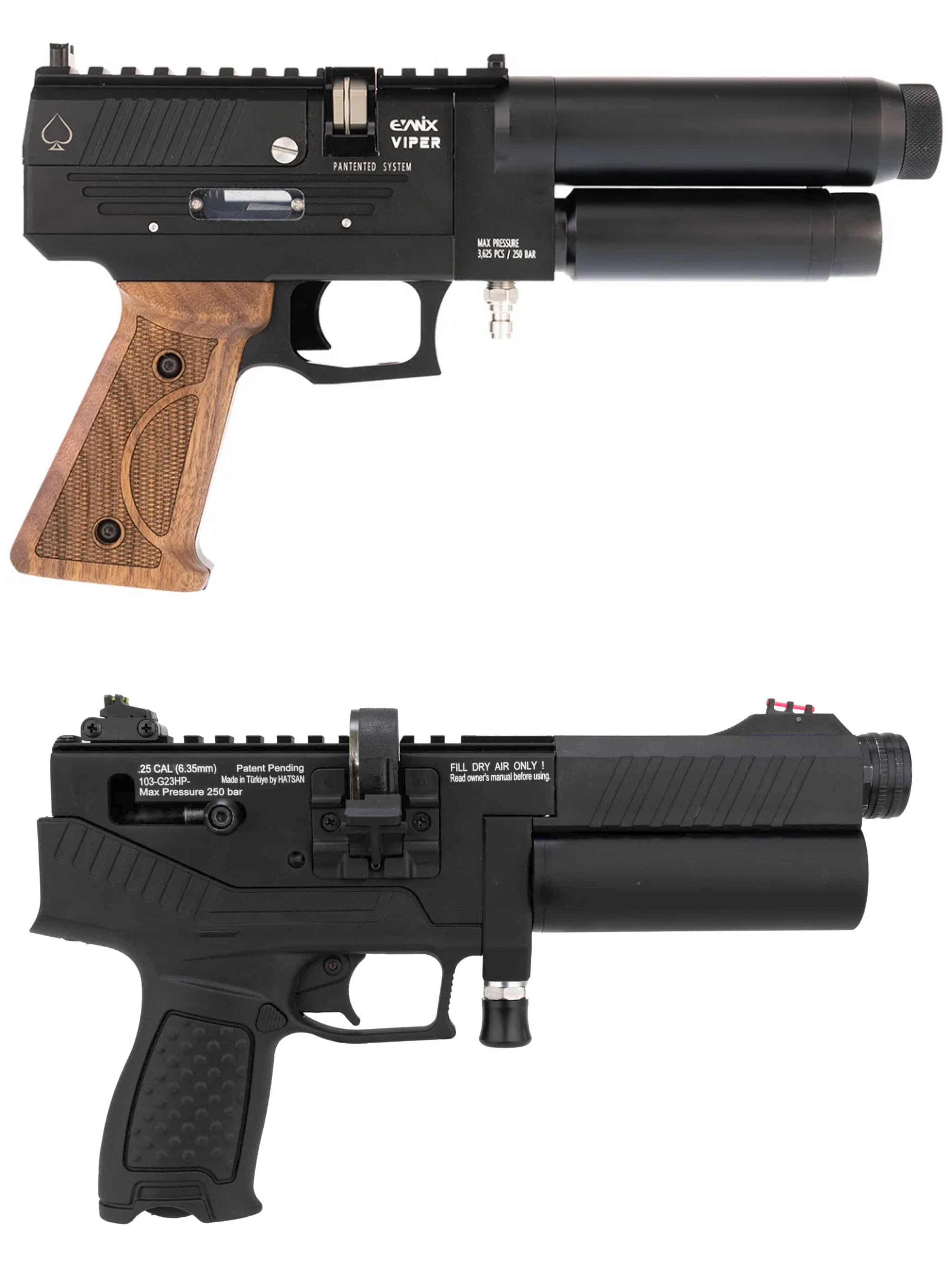

Here is a rundown on my experience.:
1) Magazine Covers too tight. Had to loosen both ...., a LOT to get them to work.
2) Magazines do not cycle reliably. Had to remove and reload several time each use before magazine was empty.
3) Cylinder #1 (came mounted) developed an air leak:
a. After shooting about 6 round at about560 to 580 fps there was a loud 'pop' and
the next shot was 212 fps. Was using 20.06 gr H&N pellets.
b. After reload and another five shots, cylinder 1 was low on pressure. I pumped the
cylinder up to 250 bar. When I released the air from the feed line, the
cylinder air went down to about 100 bar. I tried re-pressurizing several times more
with the same result. Cylinder 1 has an air leak.
4) I tried to swap out cylinder 1 to the spare cylinder 2. I could not remove the
cylinder by hand. It had been installed far to tightly at the factory. I had to use a towel in a vice too
grip the cylinder hard enough to remove it from the Velox. Small air rush on removal.
5) Installed cylinder #2 on the airgun. Pressurized to 250 bar. When I released the
pressure from the feed line, pressure in the cylinder dropped to about 225 bar, but
recovered pressure back up to 230 bar. It seemed to hold pressure so I began
shooting a fresh magazine with 25.39 grain JSB pellets. Several times in shooting
the mag would not cycle. Reloaded several times but got to 10 shots averaging about
530 fps.
6) Reloaded the magazine and pressurized to 250 bar and again and pressure dropped to
about 225 bar and came back up to about 230 bar after releasing the compressor
line pressure. After two shots the magazine jammed and I could not get it out of
the pistol. I returned the Velox with the magazine still jammed in the breach, after removing
both air cylinders.
I had the best experience in discussions with Utah Airguns. They apologized for the problems that I had and agreed readily to my returning the Velox for replacement or refimd and supplied a prepaid label for shipping. The Velox is in transit back to Utah as I type. Customer Service at Utah Airguns is exceptional and was the best part of my experience with this airgun. I asked for a refund and will wait to see if any fixes are in the offing from Hatsan. This airgun could be a winner with a little QC and possible engineering changes but until I see them in the future, I'll hold on and listen for other experiences from purchasers. I really was disappointed with the problems I saw. I have since read that some who bought this airgun were experiencing 'bounce back' of the hammer spring, causing multi-shot automatic firings with one trigger pull. I did not experience that kind of 'auto' condition with my Velox. Thank goodness.

I'm in the same boat, received my velox .25 last week from Utah Airguns as well. No leaky air cylinders on my end and kept pressure as it should........but... mags were tight, velocity jumped all over the place anywhere from 380-520-420 etc. worst of all it went to full auto 2-3 rounds at a time then jam, unjammed it and immediately back to full auto then jam, single shot then jam again. Tried h&n, Benjamin, and fx pellets all with same results. Maybe after pulling trigger a total of 6 times pressure dropped to 100 bar, guessing was from the freak full auto issue. After doing that with both filled cylinders and a 2 chips in my moderator.... Utah Airguns was good about sending me a return label and back it goes....I'll wait for the kinks to be fixed before i give it another whirl. I would have been fine to wait longer as long as the problems were addressed before putting the product out 🙄 for 400$ a semi auto, 2 mags, 2 cylinders as long as it works as it should is a good deal. After spending 1200$ for an ap16 just couldn't spend that again for a gk1. Good luck Hatsan 👍

Sorry to hear about your experience but not entirely surprised. The jams were pretty annoying because the magazines are a snug fit in the breach and there is no room to extract a stuck pellet. The door that flips down is in the way of leveraging the magazine out if a pellet is stuck between the mag and the barrel. I did not do enough shooting before determining that my Velox needed to go back so I did not look for tight groups, just hits within a reasonable area. My pistol also was an air hog, but I was shooting 20.06 and 25.39 grain pellets so I expected not a great figure for shots per fill. I don't think the current design can really expect better in .25 cal. I suspect our experiences with the Velox will be repeated a lot. Hope no one gets hurt from the tendency to go into the occastional auto mode. That one scares me. Thanks for reporting your experience.

Yes, I completely forgot to mention the pain it was to unjam the mag especially with that retention flap in the way. that from what i can see doesnt really serve a purpose except maybe for safety against the bolt action when no mag is in place to protect a slipped finger maybe. I will definitely try again when/if i see the fixes on the next run.
