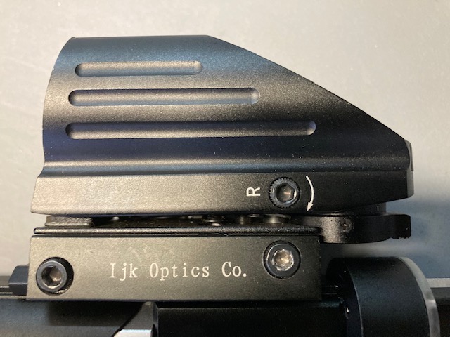

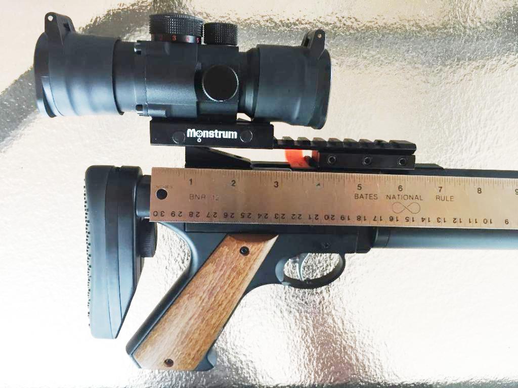

Starting with mounting the optics:
One technique you can use, if you don't have milling ability to cut new stop groves in the sliding steel bars, is to simply purchase an extended picatinny rail and mount it as far back as possible. The extended rail I had on hand has a 4" extension which turned out to work just fine with the handle fully extended.
The extended picatinny rail gives me about 9 1/2" from butt plate to my scope lens. For me personally this turned out to work just fine as I was now able to get a full picture from my scope without straining my neck or suffering from excessive length of pull. Your mileage may vary, if so, consider buying an extended picatinny rail with a longer/shorter extension to meet your personal needs.

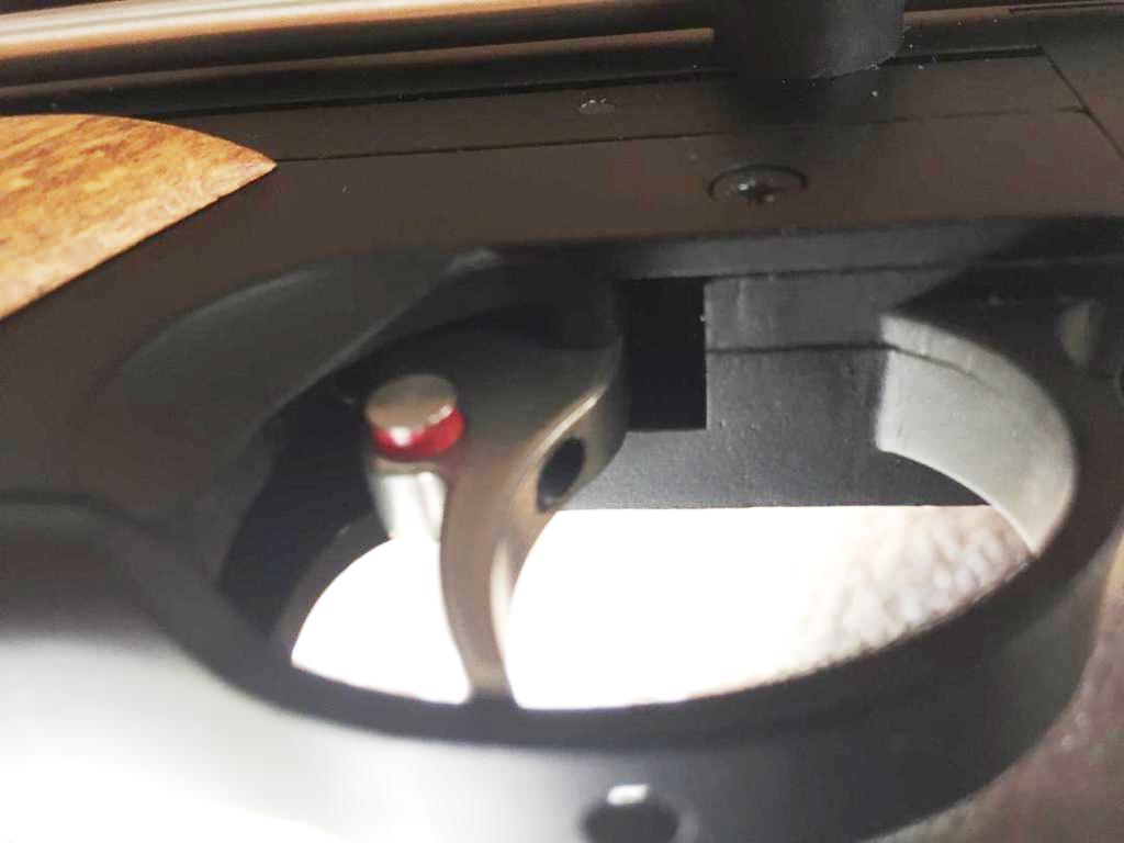

My next adjustment was to the trigger. Veradium Air did not adjust the trigger to ounces of pull. This would be dangerous for some shooters, but adjustment is simple. The front top of the trigger has a hole and a tiny hex screw that adjusts let-off pressure. (the hex wrench that fit measured 0.056mm) Personally, I didn't adjust mine too far because after a few hundred shots the trigger will smooth out and trigger pressure may get lighter. I did move it 1/16th", twice, and found a crisp release that I can live with until I get the gun broken in...then I may lighten up the trigger a bit more. After I made my adjustments, I cocked the gun and slapped it hard from all angles to see if it would discharge. It didn't, so I felt the safety factor involved was just fine.

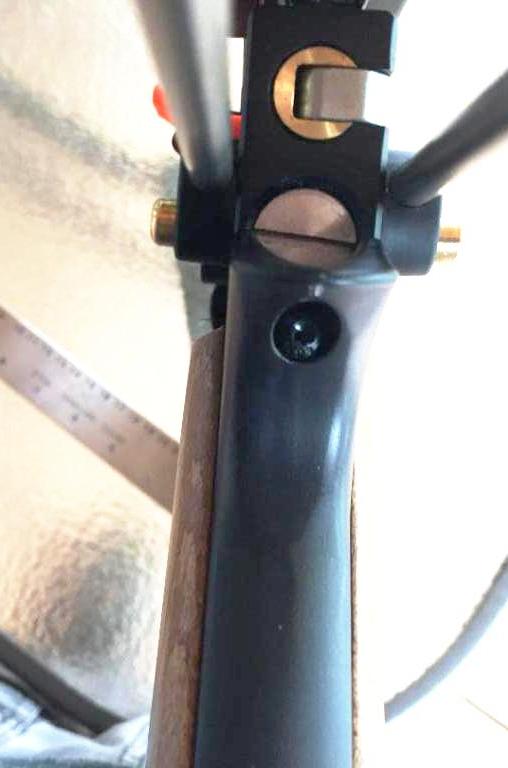

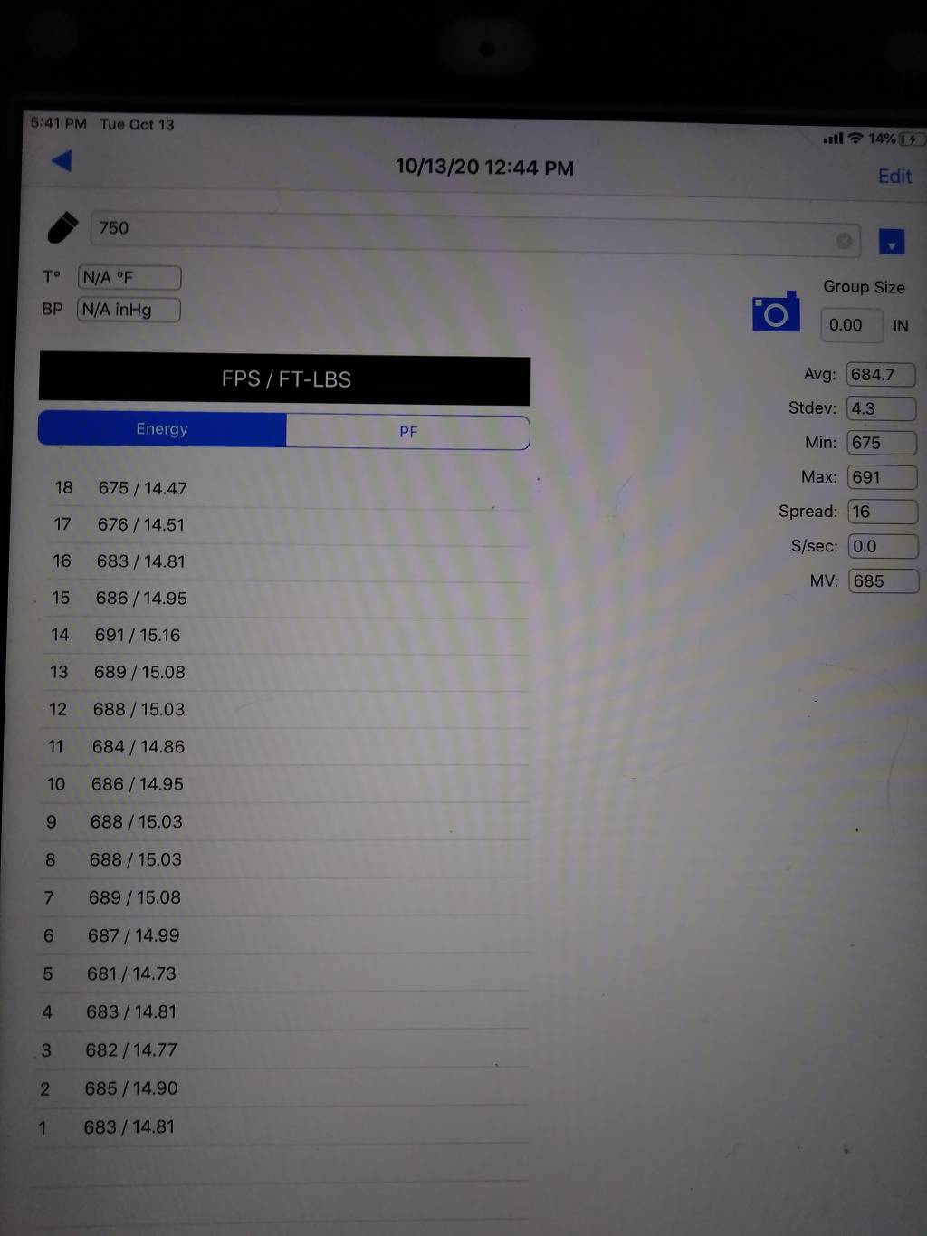

Next up was velocity. Mine was shooting in the mid 500 fps range with 14.5gr pellets. Too slow for my tastes. The hammer spring adjustment in the back is open access and all you need is a flat blade screw driver. Brian at Veradium Air advised me to go a couple of turns clockwise and use a chrono to measure when I hit max speed before it began to drop off. My gun needed a hair over two turns clock-wise to bring the fps up to 695 fps (15.5 fpe) Considering this gun has an eight inch barrel, you can probably squeeze some more out of it, but until I break it in I'm going to let it stay where it is. Brian advised that 700 fps is likely top end for this gun and I believe he is right, However, I'm happy to say it dropped a raccoon with a head shot at 20 yards later that evening. With a 3X fixed power scope, this is definitely a 25 to 30 yard gun for ground and tree vermin.

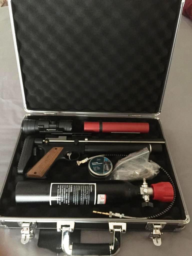

A note of caution I picked up from earlier posts. When you cock the gun, the cocking lever is sufficient for normal cocking pressure, but if you slam it back hard when cocking, you will end up bending/breaking the cocking lever. It's thin to fit flush with the breech. I found by putting my thumb on the rear of the lever, and using two fingers to grasp the far end of the lever, that I could ease it back smoothly (thanks Veradium Air) allowing it to cock and cycle quickly and with very little effort.

I also like the way you are laying out the hard case.

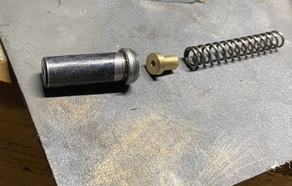

Adding a 3.5 brass slug into the hammer and setting reg to 2,180 PSI brought my .22 PP750 ( with porting as brian did) to 22 FPE (737 FPS with 18.13 grain) for 18 shots.
14.5 grain would be closer to 800 FPS.
I did not care for the shooting balance at this power, but it is easy to break 700 FPS and make 22 FPE.

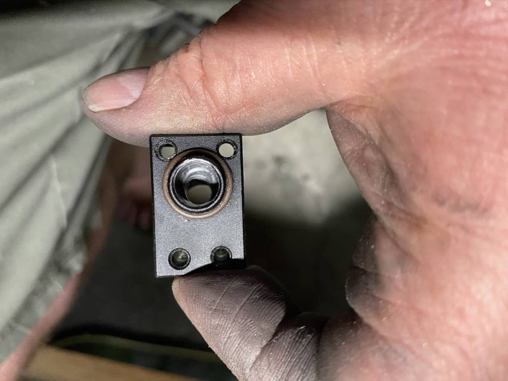

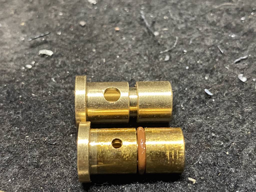

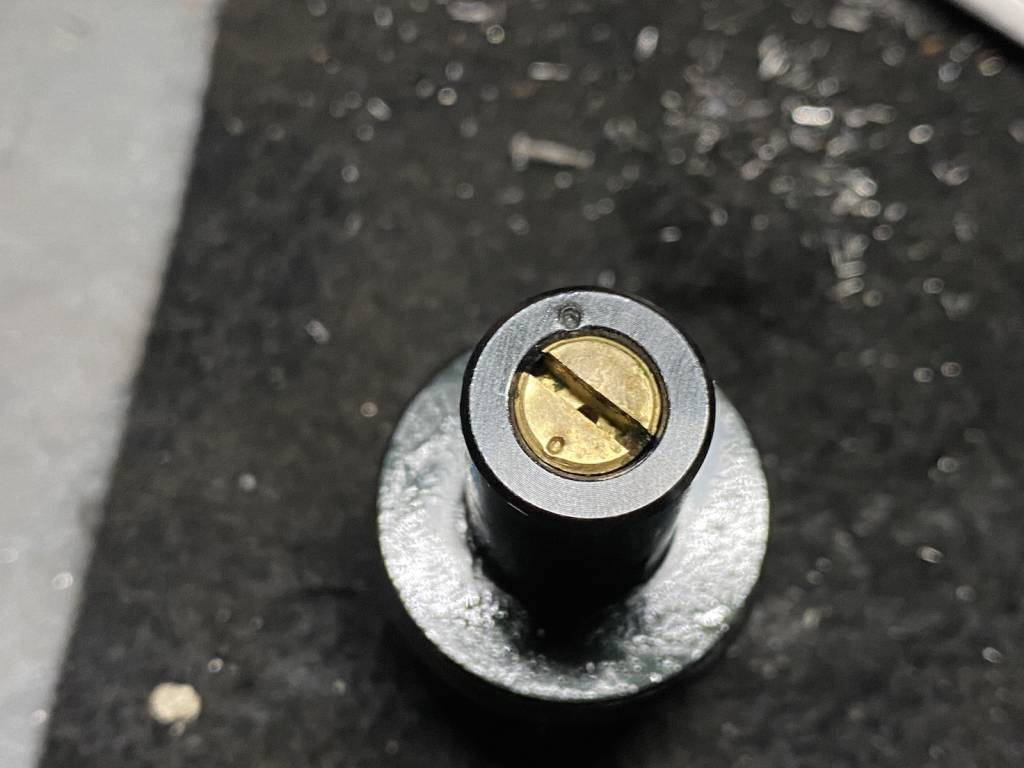

Brian, for Veridian tuned guns, already opened up the transfer port, see comparisons, and port between regulator and poppet which is the largest bottleneck. If not, 4mm is all that is needed photos show it opened up 5mm, without it regulator changes would net next to nothing. The spring really blocks this port
Reg setting is simple, air down by slowly unscrewing air gauge with tool provided in gun kit. Unscrew air tube to reveal brass slot head regulator adjustment. Mark it with punch on brass head and body to identify factory setting. Factory settings seem to be close to 1700 psi, at least on both of my PP750s. Counter Clockwise (CCW) increases pressure, Clockwise decreases pressure set point. 1/2 turn in either direction will take you past the regulator's range. I would start with a quarter turn CCW, close it up, relube airtube ring.
Two screws release handle assembly, keep an eye on the sear spring when removing handle, it won't shoot out, just small and loose fit in holes top and bottom. I turned a brass hammer plug on a lathe, but a brass bolt sized just loose to the interior of spring would work just as well. Cut to make 3.5 to 5.5 grams, keep head to rest spring against inside hammer, it will also act as a bit of a spacer increasing spring tension.
Test the spring range 1-5 turns, see where the velocity increase begins to fade and thats the peak.
