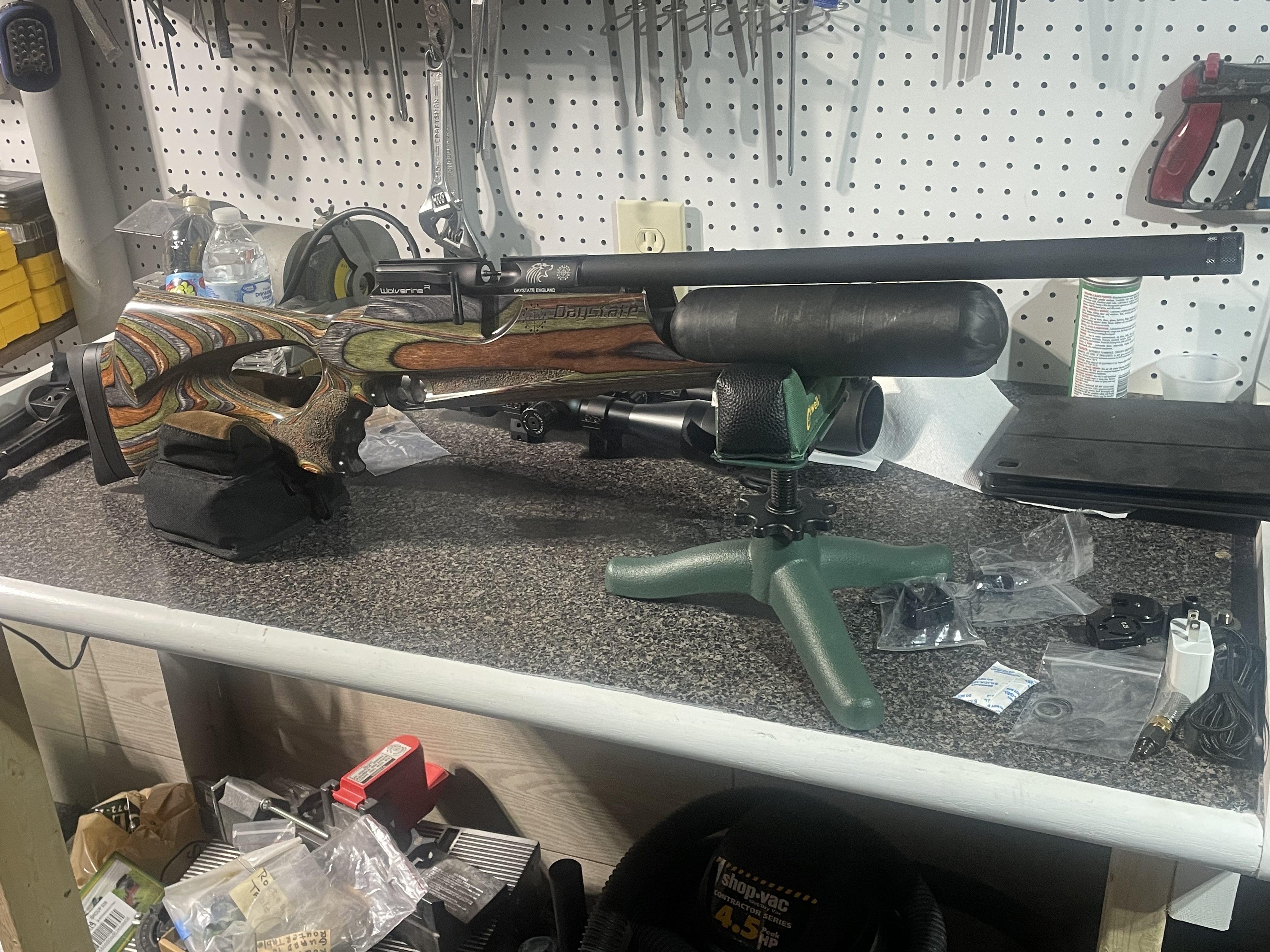

New Wolverine
Shot count: 50
Low: 965
Hi: 977
Avg: 970
Spread: 12
STD Dev: 2.8
Playing around in my basement range only have around 8 to 9 yards today. Chrony’d 50 shots CHP 7.9 gr straight out of tin. Not too bad for $6.99 pellets. Pretty sure they may not shoot as well at a longer range but works for trigger time in the basement.
