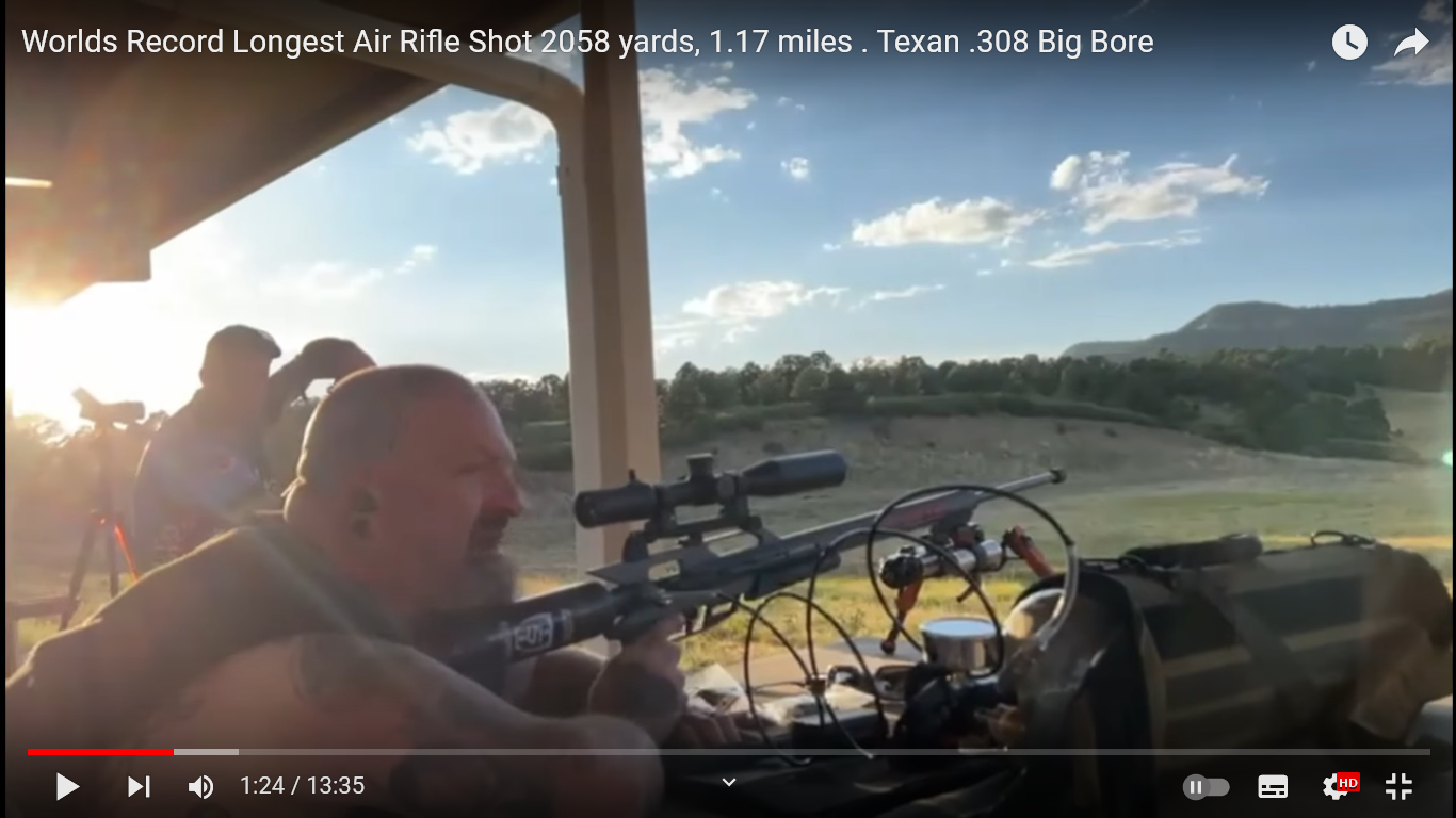

main video: Worlds Record Longest Air Rifle Shot 2058 yards, 1.17 miles . Texan .308
second video : Worlds longest Air Rifle Shot 2058 yards , 1.17 miles. Commentary Walkthrough

Too short flight time (between shot and impact) for 2058yr:
At 5:39 (main video) there is a shot at an alleged distance of 2058yr. The time from the shot to the observer speaking about the place of impact is around 5.7s
At 8:20 (main video) there is a shot at an alleged distance of 2058yr. The time from the shot to the observer speaking about the place of impact is again around 5.7s
At 10:14 (main video) there is a shot at an alleged distance of 2058yr. The time from the shot to the observer speaking about the place of impact is again around 5.6s
so the average time from the projectile flight video is 5.7s
Shooter states that the muzzle velocity in the second video at time 34:25 and that the maximum was MV:1000-1020fps
No one has measured the ballistic coefficient, but they estimate that it could be around G1 0.3
They report that the shooting took place at whittington center shooting range adress: 34025 US-64, Raton, NM 87740- therefore we used an altitude of 7215ft ( 2200m) above sea level and pressure we will estimate on 30.09 in = 1018HPa
From these data it is possible to calculate using a ballistics program that the flight duration for 2058yr, G1 0.3 and 1020fps should correspond to a time of about 8.9s.
So the difference between the physical reality and the measured time of the flight length of the bullet in the video is more than 3s !
Even if we used the super BC G1 0.479, which I have a 155gr Berger Target Hybrid .308 bullet for firearms and and used speed of 1300fps (400m/s significantly supersonic), the flight time will not be lower than 6.7s
conclusion: this is clear physical evidence provided directly from the video that there was no way one could have fired at the stated 2058yr, at most it was 1400yards, but we didn't account for observer lag (seeing the impact and the first reaction of the body ), so realistically it won't be more than 1300 yards.

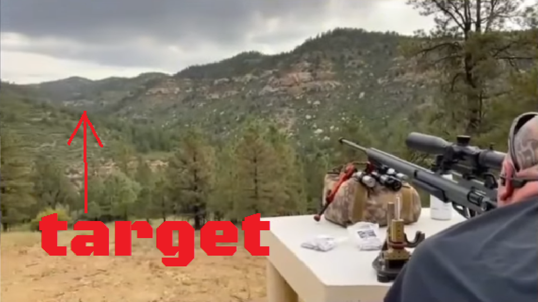

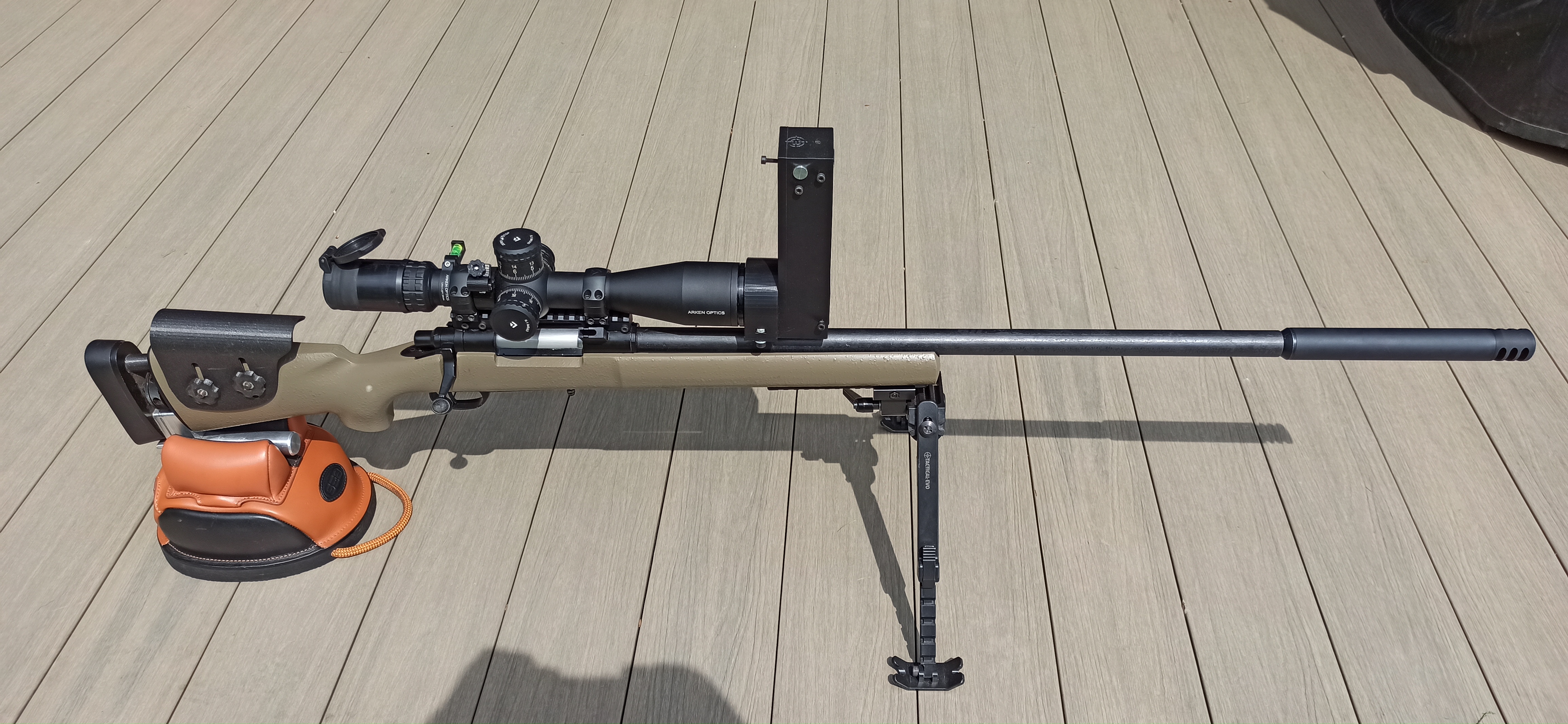

A small tilt of the barrel axis required for shooting at 2058 yr:
here in the photo you can see my barrel tilt when when I completed my new world record on 1 mile. This shooting required 230 mRad, which corresponds to a 13-degree tilt of the barrel axis to the target, and you can also measure this tilt in the photo.

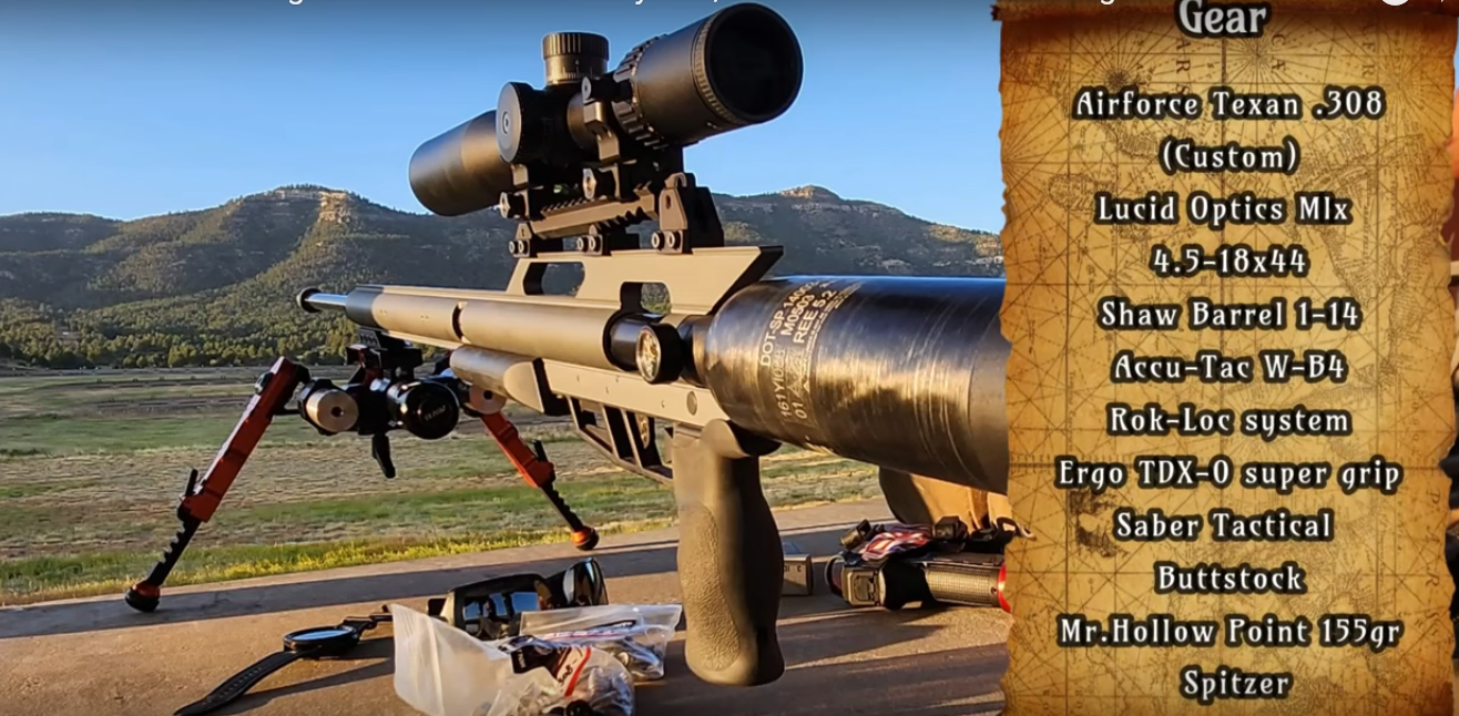

Here are pictures of the rifle tilt used in this scam video.
you can see how little barrel angle is used here.
In this photo, the position of the alleged target is marked, which is not on the same plane, but is on a hill, so it is necessary to increase the angle by the difference in the height of the target and the shooter.
in the first photo you can also see that a front bag was used under the bipod to raise the axis of the barrel a little. The increase itself is a maximum of one inch compared to if the rifle was mounted on a bipod.
But in these two photos, Mr. Ton Jones and his team state that he was shooting at 1050 yards. From the second photo you can see that in this case the target was only slightly higher than the position of the shooter, it was definitely not as high as in the alleged 2058yr.
3 zuby uvodni video se střelbou na 1050 yard  nebo tak něco – kopie-target.png
so, to change from 1050yr to 2058yr, the shooter raised the barrel by a maximum only of 1 inch, but according to the calculated ballistic data, the aim of the barrel needs to be increased by more than double!

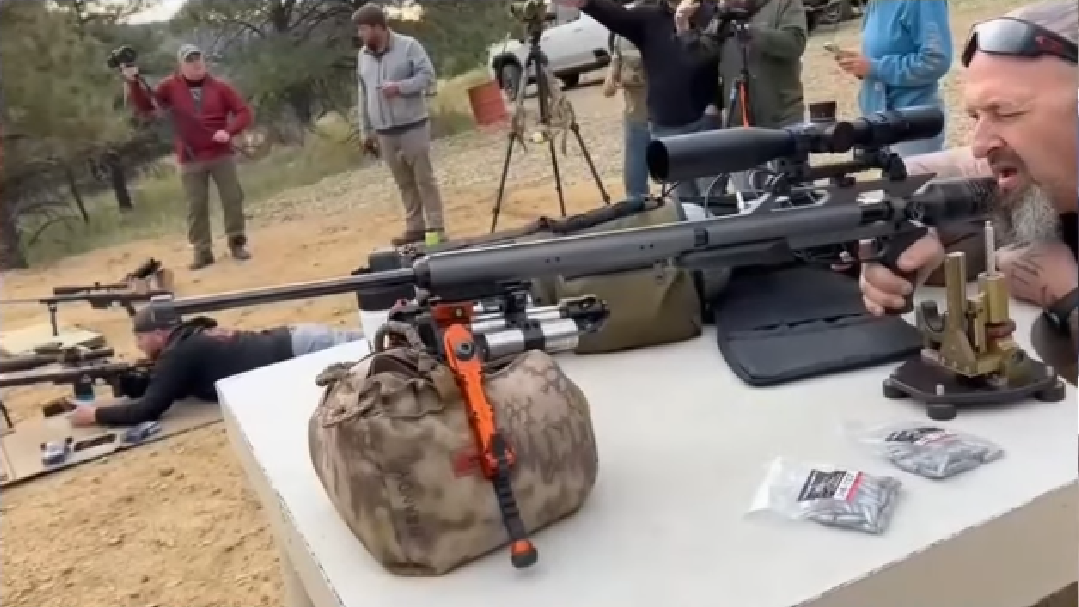

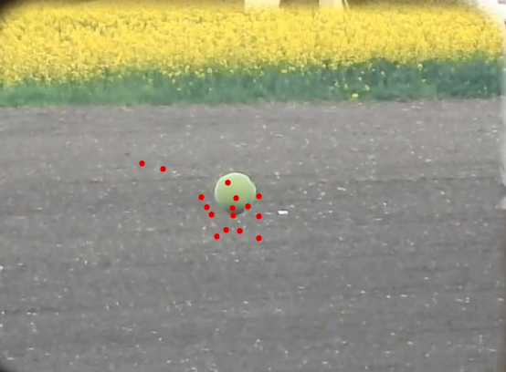

This is all 16 shots in a row from the record video. With 88% of impacts (14 shots from 16) having C-C spreads of 61 cm - 24 inches which is equivalent to 1.3 MOA (measured horizontally only ).
The two shots in the upper left corner I think they are caused by a change in the wind, as the wind was blowing almost from 9 o'clock and thus the decrease in wind force shifted the impact to the left but also higher. If, on the other hand, the wind was blowing more than the average, the shot would be to the right of the target and lower, since the direction and force of the wind changes the impact vertically as well, not only horizontally.
vertical dispersion cannot be accurately measured as the projectiles hit a relatively flat surface. A target on a steep hill would be needed for this measurement.
Even though these ATP Super King 66gr slugs had a BC G1 close to 0.3 (0.275), this BC is still too low for such a small spread given the wind that prevailed when shootingPersonally, I believe that this small variance was mainly due to the fact that a large part of the slug's flight took place at a height of 100m (330 feet) above the ground where the wind is already significantly more stable than a few meters near the ground where swirls are created and irregular flow.

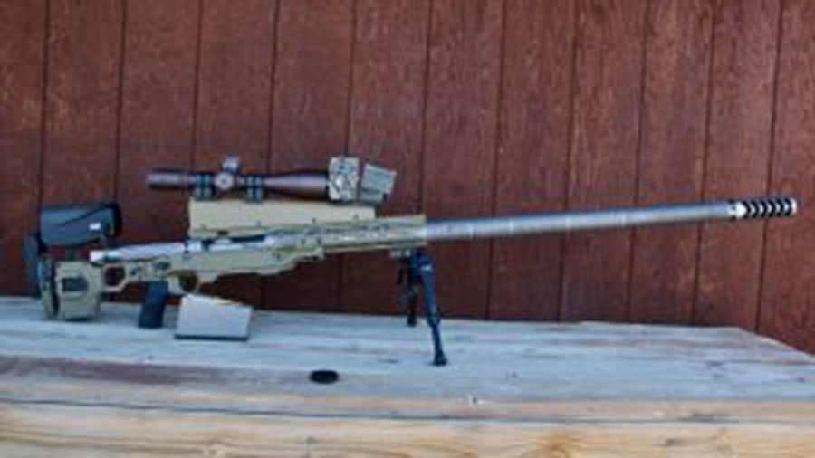

Pricnip is the same, periscopic design. Just in your photo, the Delta TARAC device is also used, which shifts the image to the side off the barrel axis. I preferred to solve it with a high periscopic device, which will do a similar job.
as for tilting the scope assembly in such a way, I find it very impractical, since such a rifle is then handled in a completely different way and cannot be used for anything else. It is enough for me to remove the periscope from the scope and I can immediately shoot using only the scope from 0m to almost 500m.
But I understand that probably the slope from Charlie Tarac was not enough and therefore they had to use the mounting slope as well.
