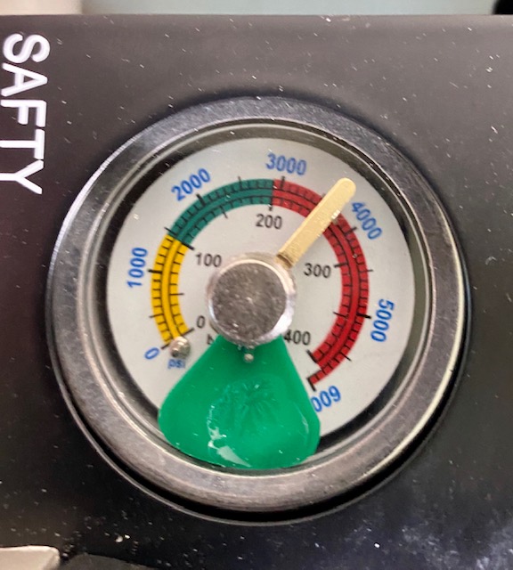

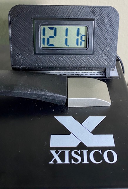

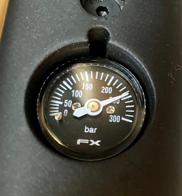

I gave it a pretty good run today, I filled my FX Crown from 150 bar to 250 bar. This air gun has a 580cc bottle on it, so it’s probably the most challenging air rifle I’ll ever fill with it. It is slow, but in a methodical sort of way! It took all of 15 minutes to top it off the Crown and the operating temperature maxed at 121F. I then filled my Royale from 150 bar to 250 bar after allowing the fans to run till the temp dropped to around 94F. The Royale has a 480cc bottle, so not quite the volume. The temp got to 126.5F, still relatively cool compared to other compressors! So, it’s no speed demon, but it is light, Compact, fairly quiet and get the job done!
These are the first run on the Crown, I didn't take pictures of the gauges after filling the Royale. It fills pretty quickly until it hits the current pressure in the tank, and it seems to sit for a while, possibly building enough pressure to overcome the opposing pressure in the tank, then it just slowly chugs along till it shuts itself off. Overall, I'm happy with it!

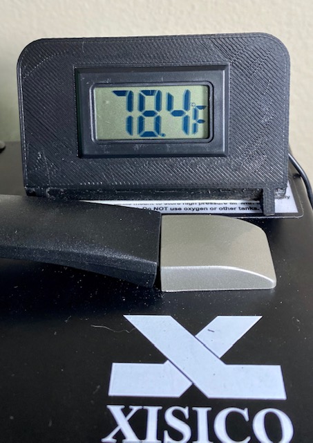

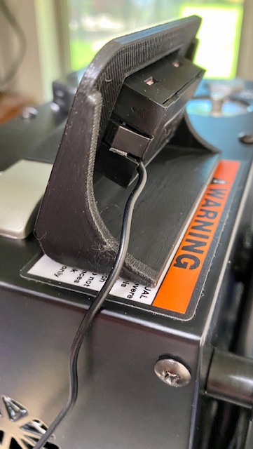

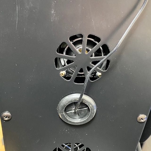

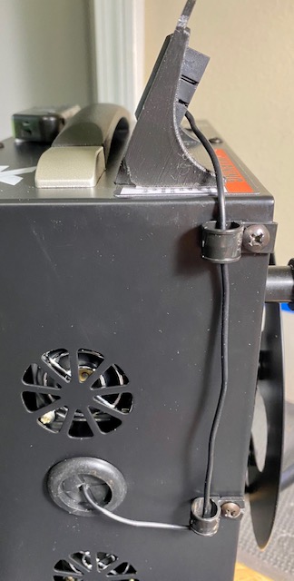

For anyone interested, here are some pictures of where I put the temp probe to monitor the temperature of this compressor.
I slid the probe in between the top fin and secured it in place with a tie strap to the top fan.
I ran the line out of the plastic plug between the two fans on the back of the compressor. You will have to cut a small slit in the cent of the plug to feed the probe through it.
I mounted the gauge in a small frame I 3D printed from a file I got from Thingiverse. It's attached to the compressor with double sided tape.
I added a couple guides to secure the probe cable so it doesn't get caught on anything.
This puts it a a very good angle to observe what's happening while it's operating.

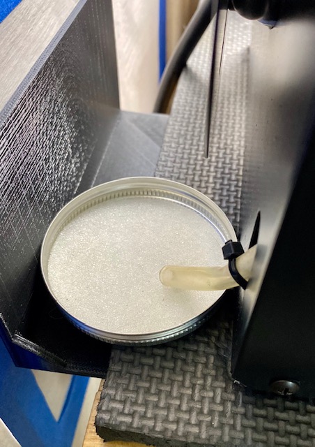

It sits on top of my workbench and the oil/water discharge is facing the wall. To prevent this from messing up the paint, I 3D printed a shield that slips under the dense foam pad and keeps it from splattering against the wall. I also put an old pellet tin half with a old foam ring under it to help catch the discharge and reduce the mess. I also used painter's tape to attach a piece of parchment paper directly to the wall to further protect it from any splatters. Hopefully, this works and my wife won't kill me for messing up the walls!
