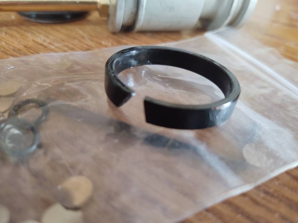

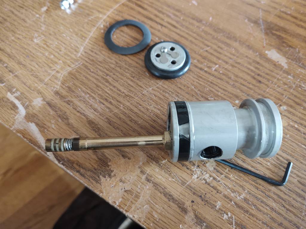

Spoke too soon 😥. The pump sounded like a bowling ball in the washing machine and began passing oil into the fill probe. I did some exploration/necropsy poking into the guts of the machine. Pulled the motor and pump clear out of the housing and fiddled around till I found the way to remove the piston. Here is what I found. The piston has a hard plastic ring that is broken. The piston has two slots that fit the ring, I suspect that there should be two of those in there. Not a hard R&R...just need to get the parts.
