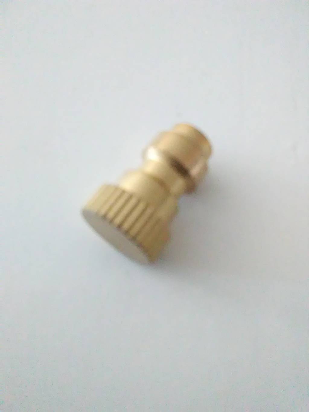

Airslave,
Check to see if one of these came with compressor. It's a tester, insert in end of fill hose, pressurize system, shut down and check for leaks. WM
Airslave,
The gauge is a weak point of the Yong Heng and it's never a bad idea to have a spare. Not that expensive or rare, so no big deal. In your shoes, if the gauge is leaking and can't be fixed, I'd try the gauge from the broken Vevor or even from a Chinese HPA handpump. It's all from China anyway, so who knows, might just work. Never force anything, though, and try to eyeball that they are similar. I'm not sure how the gauge is sealed to the compressor, might just be a small, white plastic "donut" seal at hole bottom, you'll have to investigate to see if the actual gauge is bad or how it is attached. WM
