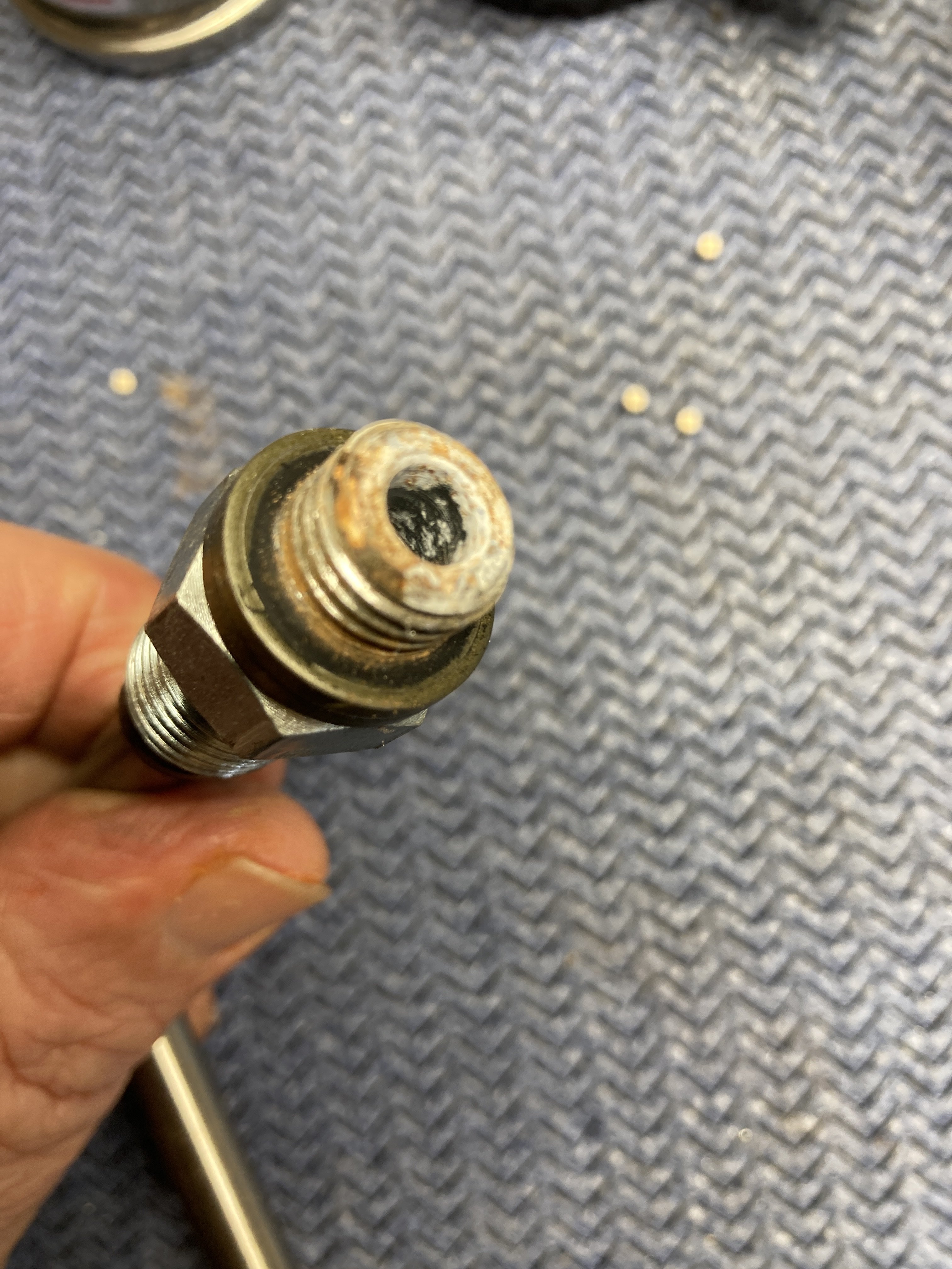

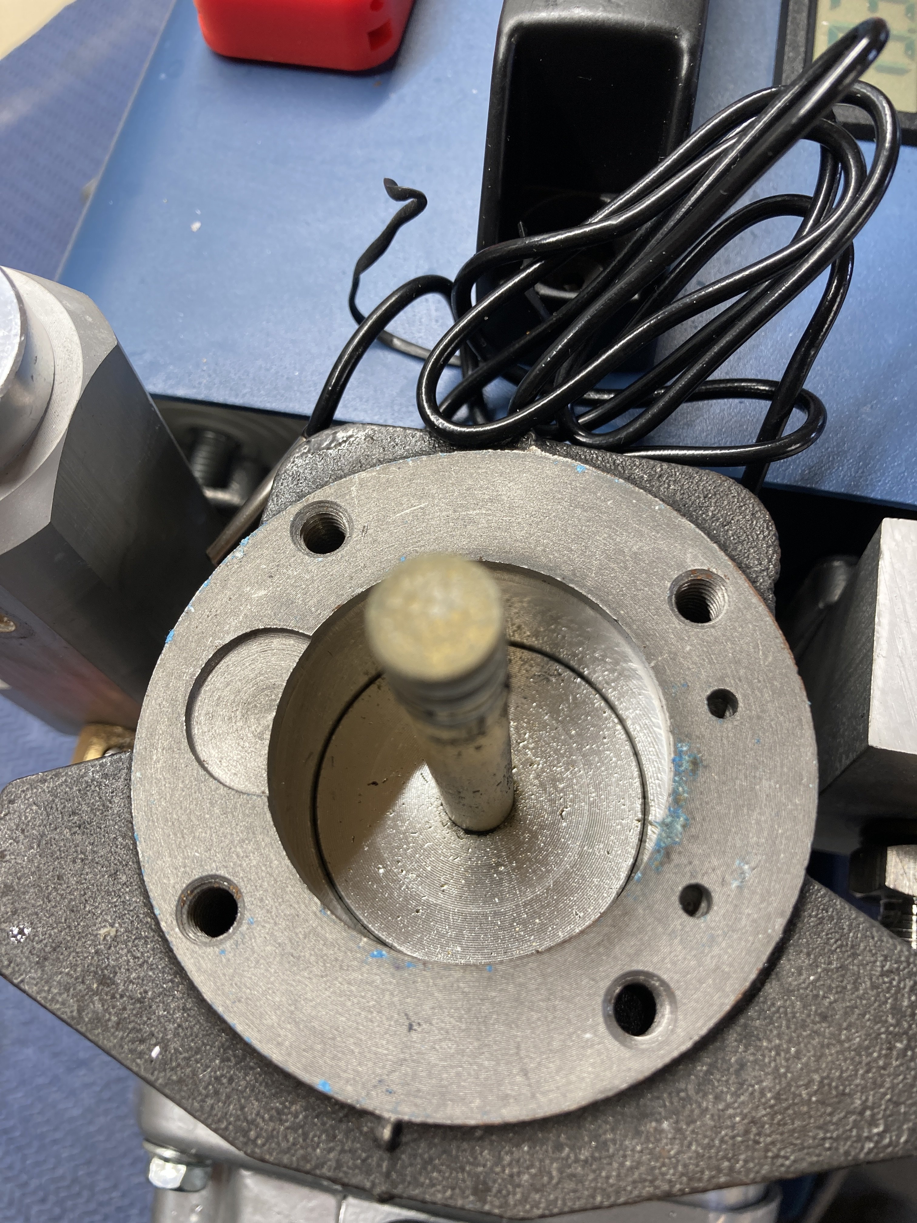

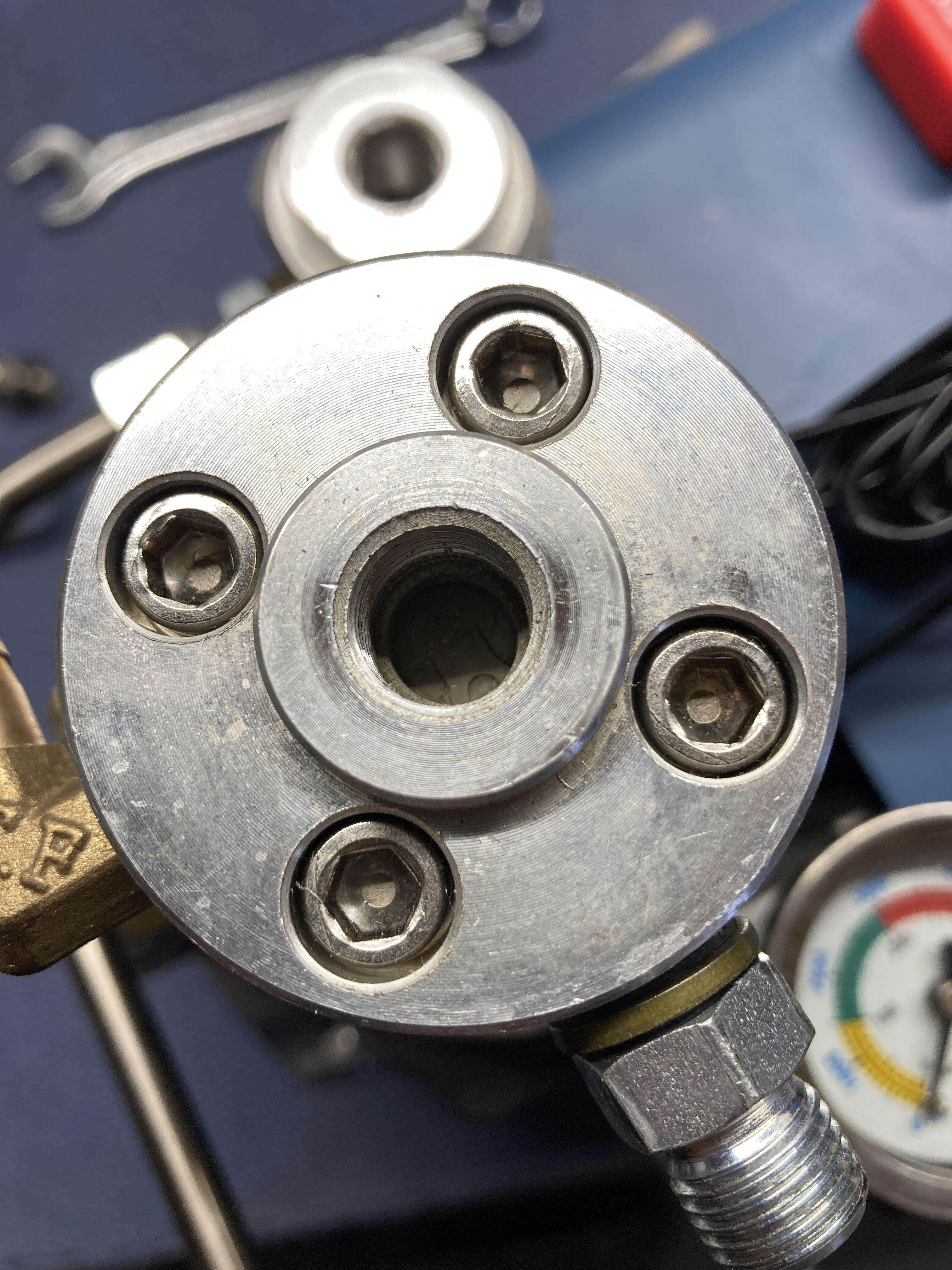

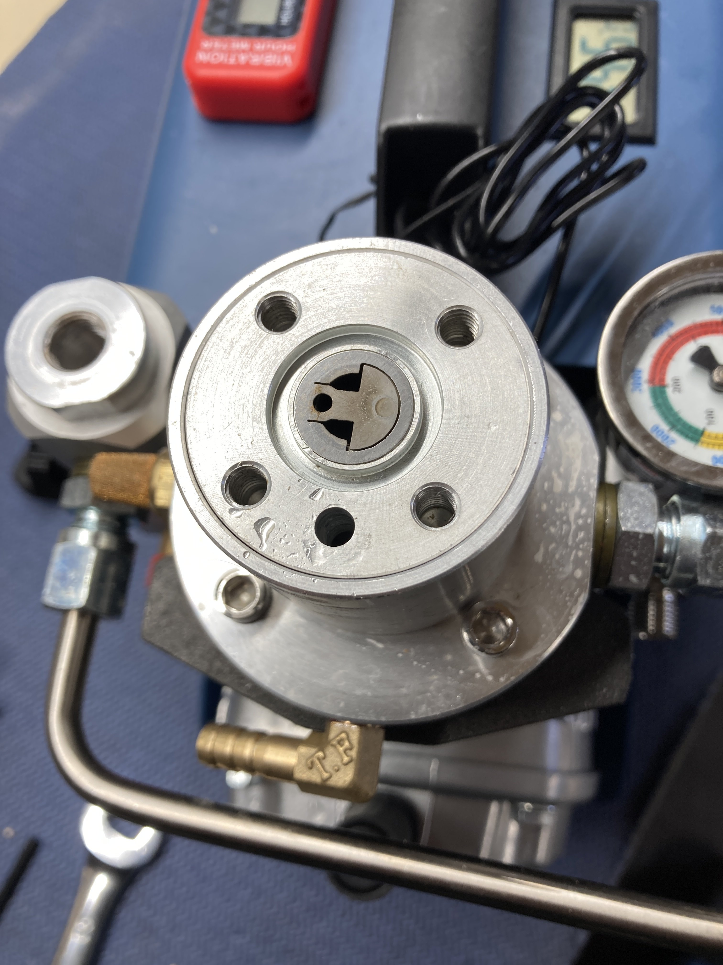

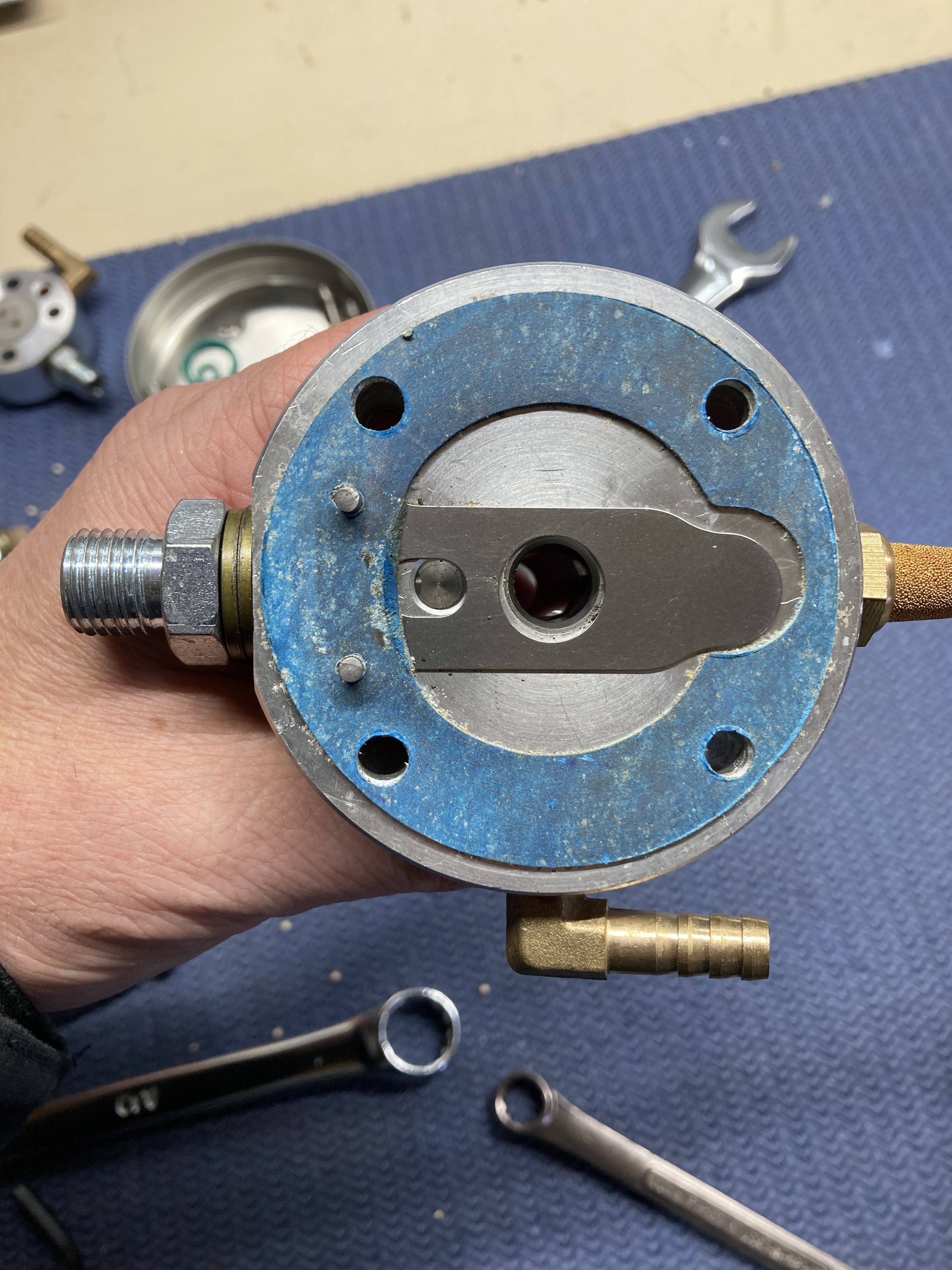

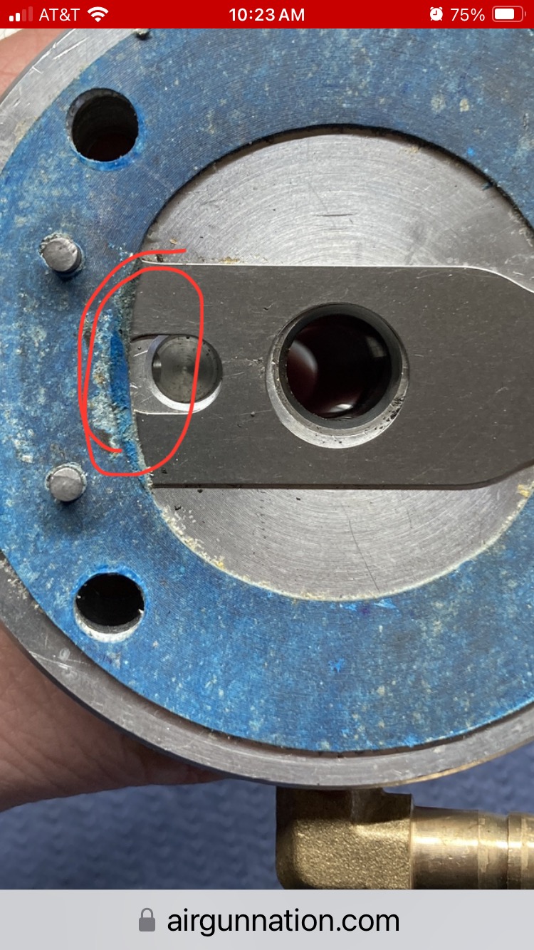

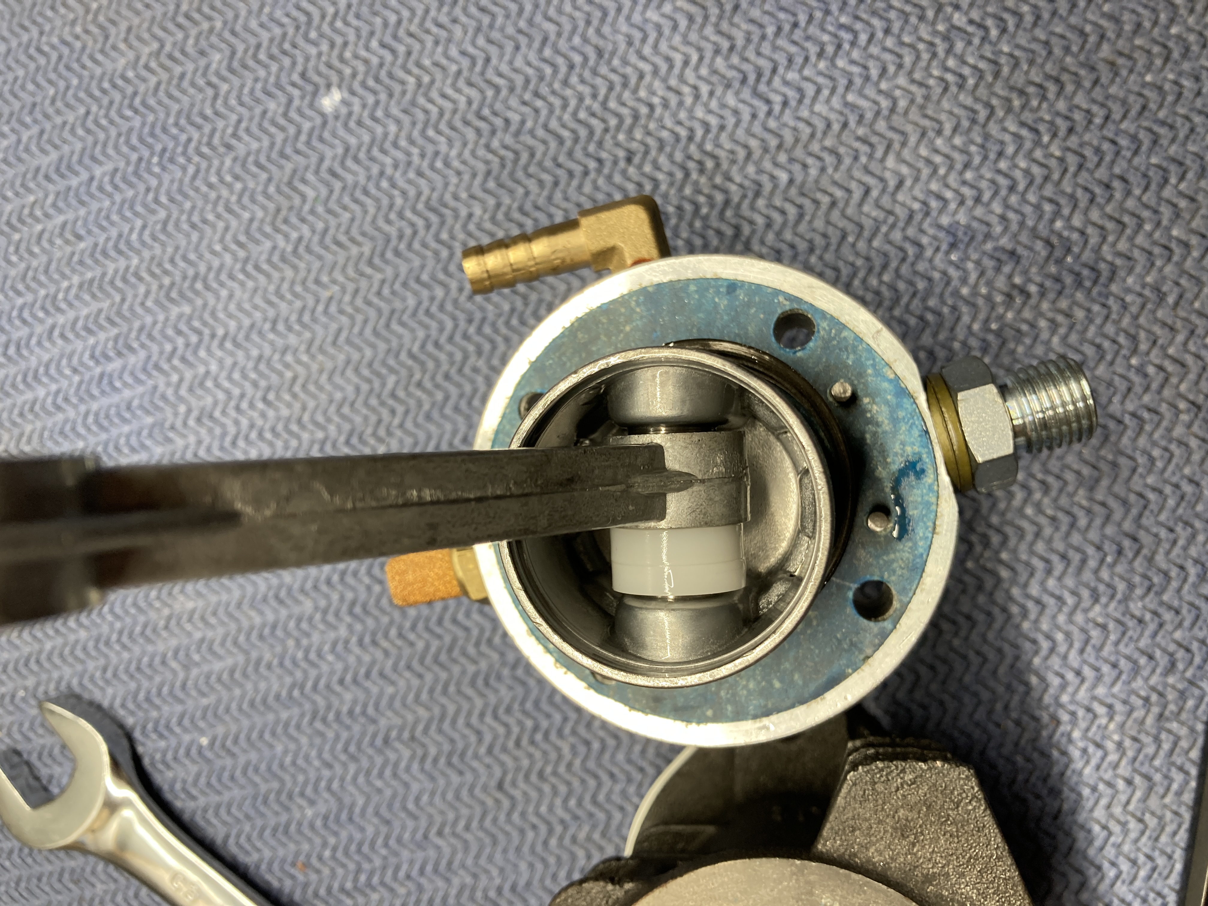

So I took apart the upper assembly this morning. I took some photos. Looks like this one sat somewhere for 2 years before I purchased by manufacture date. Maybe some one can tell me if they see any thing wrong. It didn’t seem tight as it turned over pretty easy.
