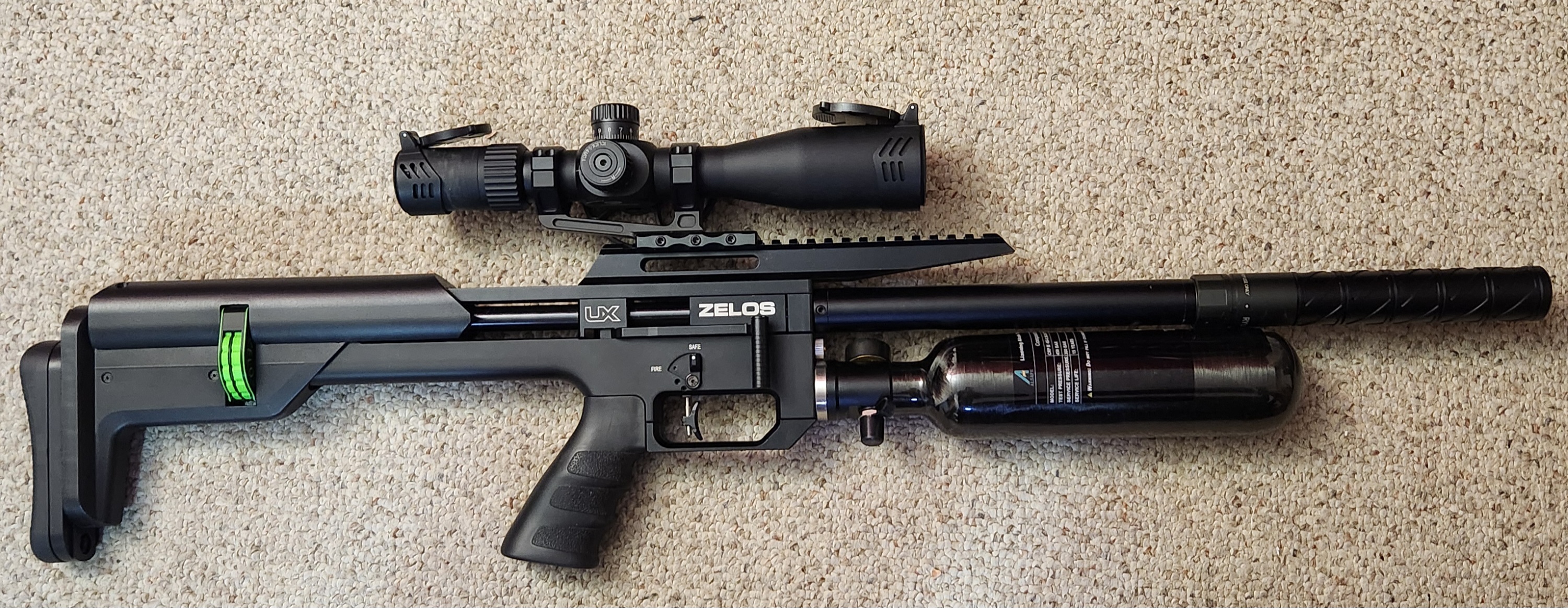

I tried it but I have a custom 500mm barrel with no baffles. The shroud basically ends at the threaded 1/2x20 adapter so there's no extra space for baffles. . While it Buck Rail's moderator did reduce the shot report significantly, I found it a bit quieter with the DonnyFL Ryu moderator with 2 addtional baffles that I added. It added 2 more inches to the OAL but that's ok with me since it's "only" at 34" now.
