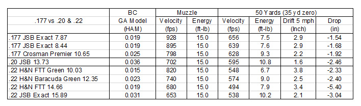

For pure accuracy, 177 is hard to beat in an HW97 class gun. The flat trajectory minimizes the effect of range estimation errors, and wind drift is also relatively low.
In truth, I try to set up all my field guns with the same trajectory to keep things simple. And that means a muzzle velocity of roughly 800 to 900 fps. So the 12-15 ft-lb springers are in 177, the 20 ft-lb PCP is in 20 caliber, and the 30 ft-lb PCP is in 22. Got to have a plan, right?
