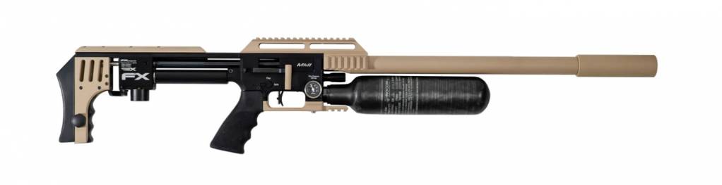

  • If I'm looking to coat a few parts like the shroud, cheek rest, scope rail, cocking lever, trigger guard and side plates (as shown in photo below) - how much should it typically cost?

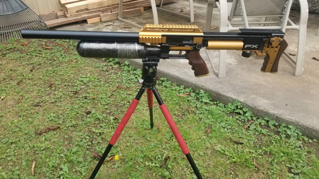

Please let us see some pictures when you’re done. Nathan’s gun should be your motivation! His Impact turned out sick. He had the balls to do it, picked cool colors and did a great job! One of the best looking Impacts out there!

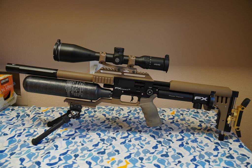

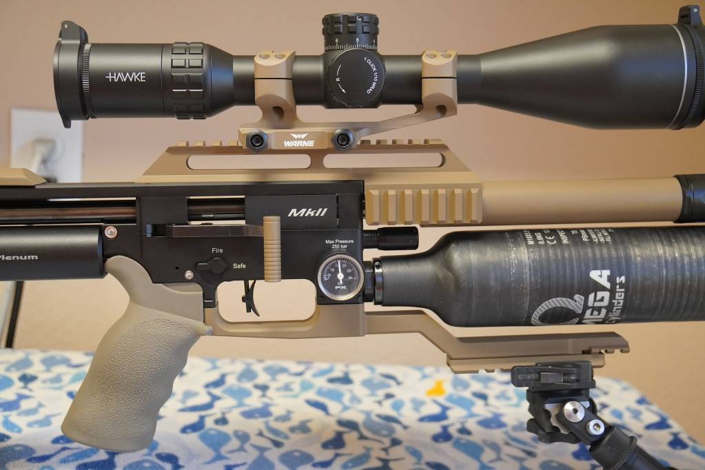

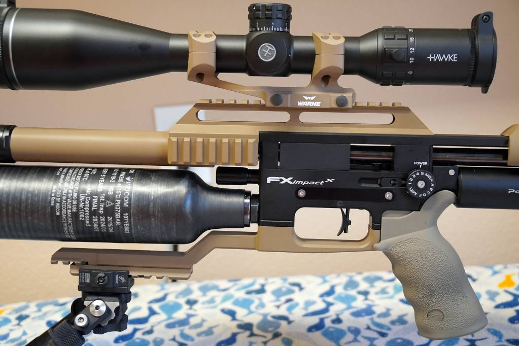

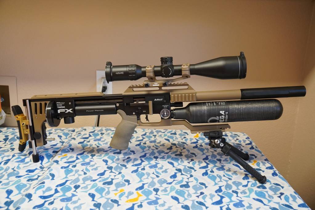

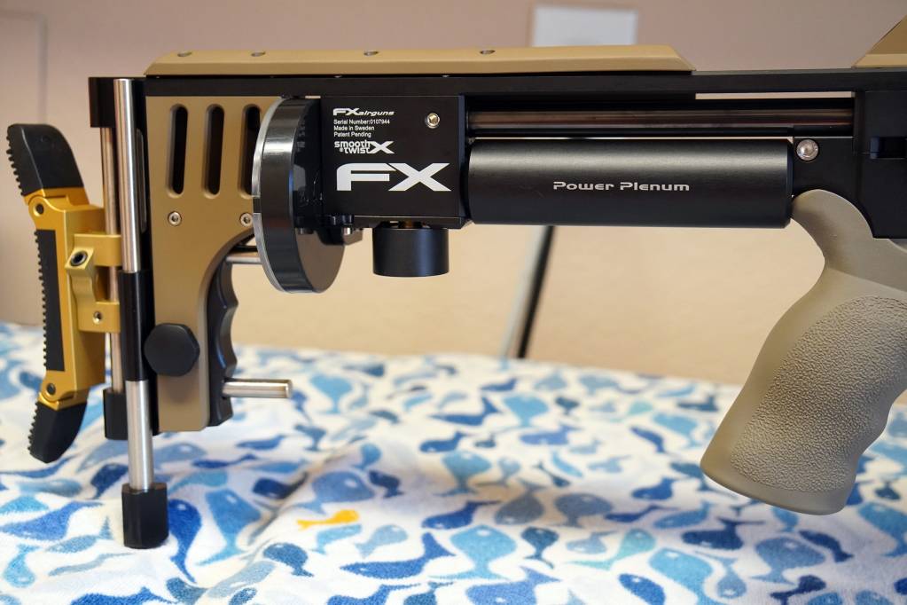

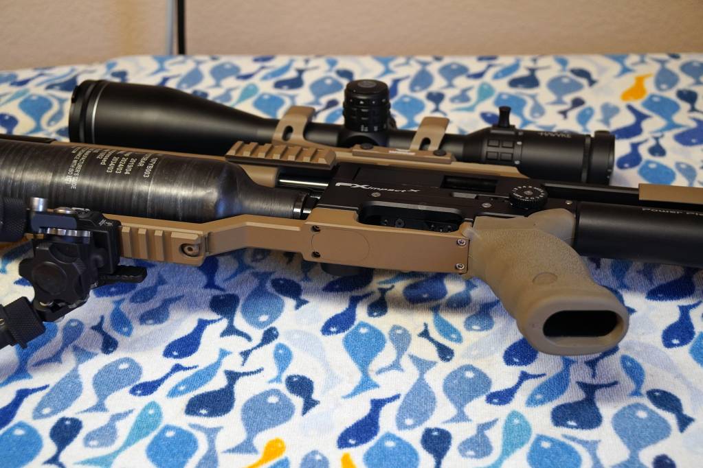

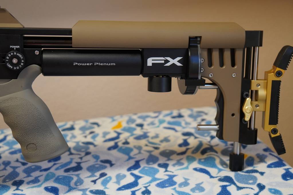

@Moog - you are absolutely right . . . I just picked up the parts from the shop and I could not be happier! It looks amazing (although, in hindsight, I should've cerakoted the moderator too)! The official Cerakote color we went with was "Magpul Flat Dark Earth" and it matched my Warne FDE mounts exactly. For all the parts shown below, he only charged me $75 but I gave him $100 b/c I would've likely spent that much buying the Duracoat kit to do it myself . . . and there's ZERO chance that I would've done as nice a job! It looks so nice that I'm going to do my other Impact in Sniper Grey next week!
The only gotcha on this first trial is that the resin cheek rest got fairly warped during the heating process and I had to break out the heat gun to slowly massage it back into shape so that it would fit back on the guide plate again! Here are the results (the gold K&L buttstock is new to me and will need to be cerakoted in FDE as well):
Wow yen nice job! Perfect match. Is Cerakote a bake on process? Look forward to your next Cerakote project.
Cheers
Thanks Houli...from what I understand, they sand blast it before applying the cerakote. Then it's heat cured so that the cerakote binds with the material, which is what makes it so durable. It was the heating process that warped the resin cheek rest piece pretty noticeably. It was so visibly curved that I didn't think I could straighten it out enough for the screw holes to line back up with the top guide plate but luckily it worked out with a heat gun and some patience.

Thanks, Moog . . . when I drop off the next batch of items, I'm going to have to get one of my moderators (most likely the DonnyFL Koi) and the gold parts of the K&L buttstock cerakoted in FDE as well. I wasn't sure I wanted to cerakote one of my mods because I tend to switch them out a lot but an FDE mod would look a lot better. I also just got the gold K&L buttstock last week and was hoping it would go OK with the FDE but it clearly does not IMO. Getting those last remaining pieces in FDE will finish out the look I think.
I'm excited to do the sniper grey Impact next!
