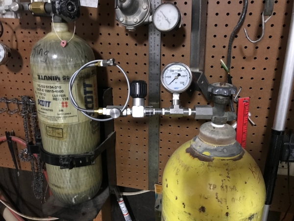

Lamar, kind of a cluttered photo but you can see the valve I use furthest downstream. I actually use this valve to do the filling instead of the cylinders valve. Nuvair.com has some small valves.
Jimmy
If that's the only gauge on your set up I would put one on after that last valve so you can see and regulate what's going into the Airgun and it's a good way to make sure the gauge on the gun is right....Right now I take it you are just watching the gauge on your Airgun when you fill being it looks like that big gauge is only giving you your main tank pressure reading between valves...I would take and move the black handled valve next to your main valve and then put a gauge by your pressure release knob, you can use a dead head in the hose end to check tank pressure if you need to see how much pressure is left in your tank.....it keeps the valves close to the tank so there is less chance of bumping and breaking off that long pipe set up......JMO.....

Imold, I misspoke earlier. Most of the time I use the cylinder valve to fill the gun and I do watch the gauge while filling. When the gun is full I close both valves and just bleed off the hose up to the last black handled valve. This leaves the gauge pressured up for several days if I don't use it but eventually the pressure leaks down a little. I've tested this gauge against my Crystal digital test gauge and it's almost right on. I can also just leave the end valve shut, crack the cylinder valve to check the cylinder pressure.
Jimmy
