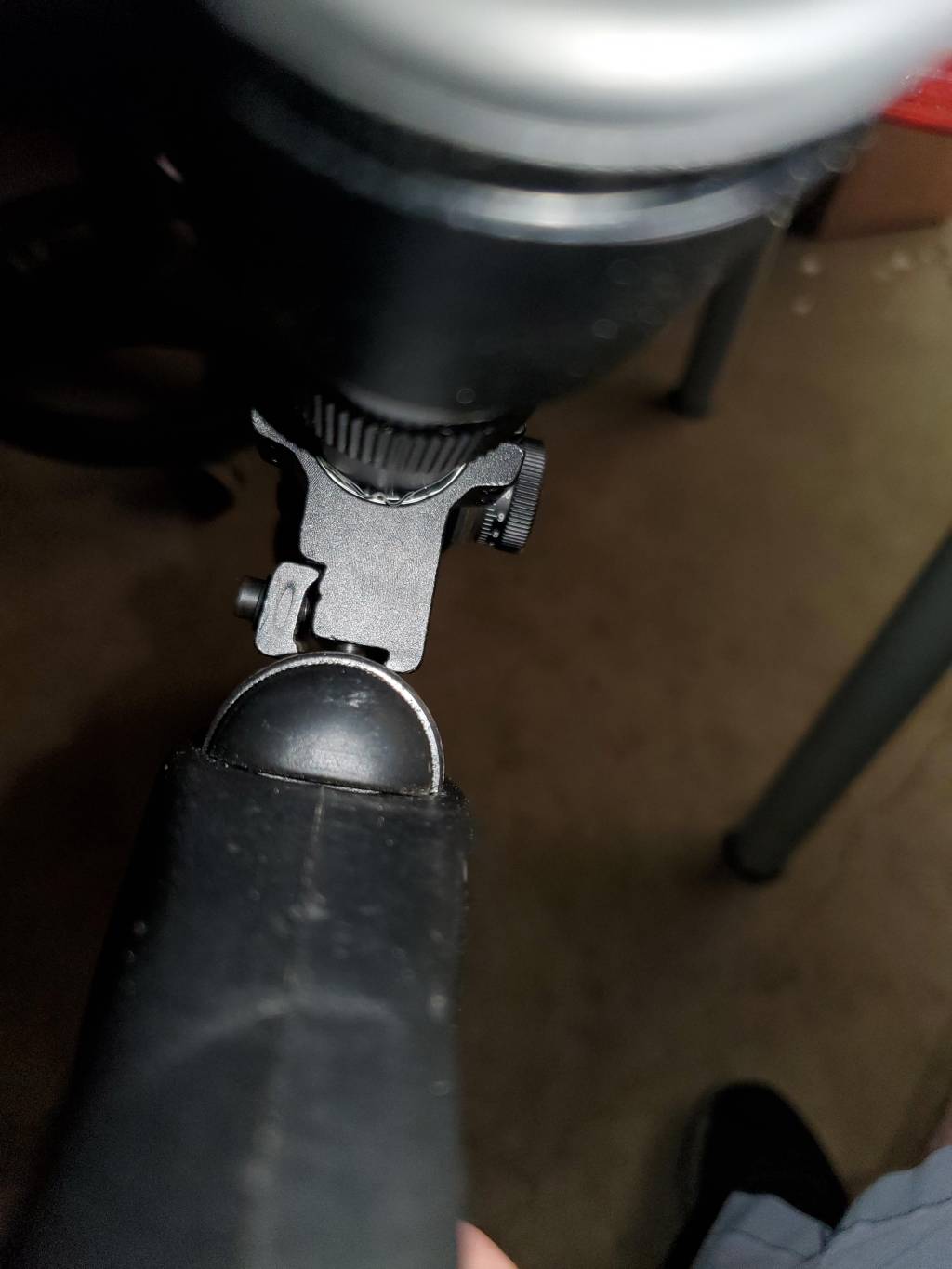

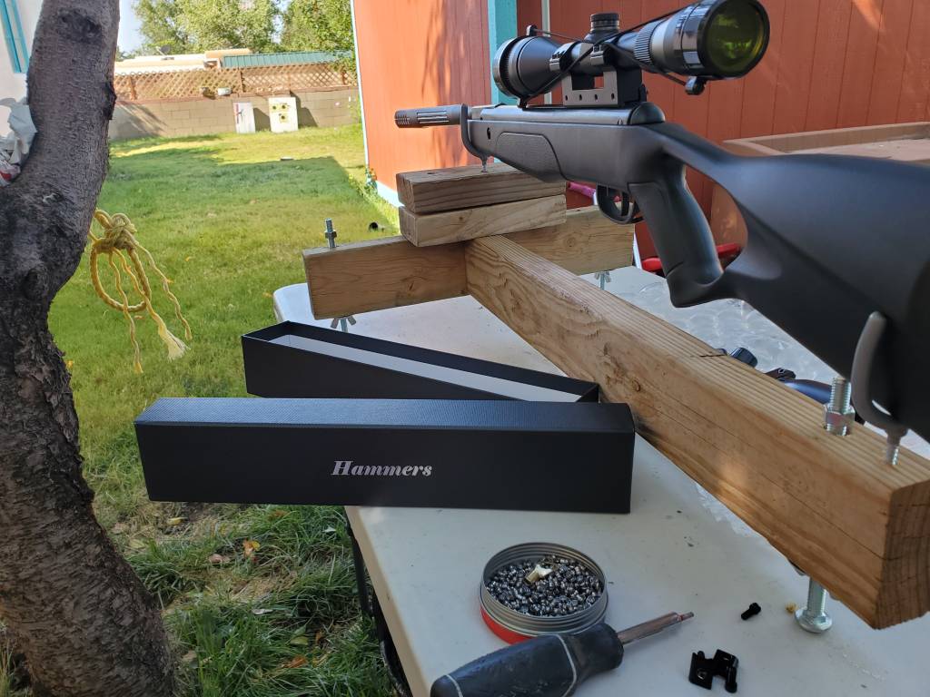

Hey guys, reading some threads I read some people recommending the hammer 4 as a budget and good optics scope piece, I have a crossman f4 nitro piston break barrel and I wanted to replace the scope that came with the gun (center point)
so I did and got THis Hammers 4-12X40AO for 80$$ it looks good and the clarity is way much better than the center point BUT.... cant zero it, crosshairs needs to go down like 7+ inches and it got not enough clicks, so I started reading the amazon reviews and looks like this is a common issue with this hammers. people are returning these
Do you know how to fix it or is it better to get a different one? which one?

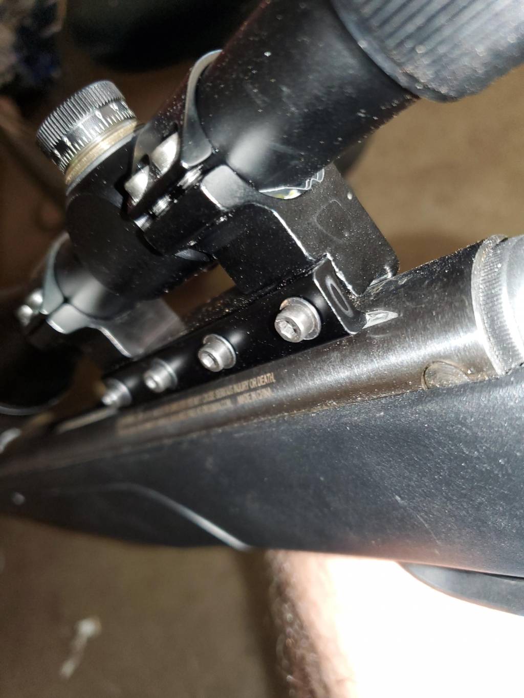

It may just be me...but from the angle of your photo,it looks like that rifle is exhibiting some significant barrel droop.
Might want to try some adjustable scope mounts or a UTG droop compensating mount before writing that scope off. Hopefully no damage was incurred by maxing out the elevation turret.
Another option would be to actually bend your barrel. (No... I'm not nuts. There are tutorials on how to accomplish this.)
Hope this helps you.
Mike
It looks the same on my benji np regal, barrel sits proud like that when locked up. I business card shimmed mine, worked well enough. We aren’t talking about fine optics here (no offense intended), as long as you’re not too ham fisted, should be fine. That said, I do have a dovetail to picatinny drooper adapter, just never installed it.

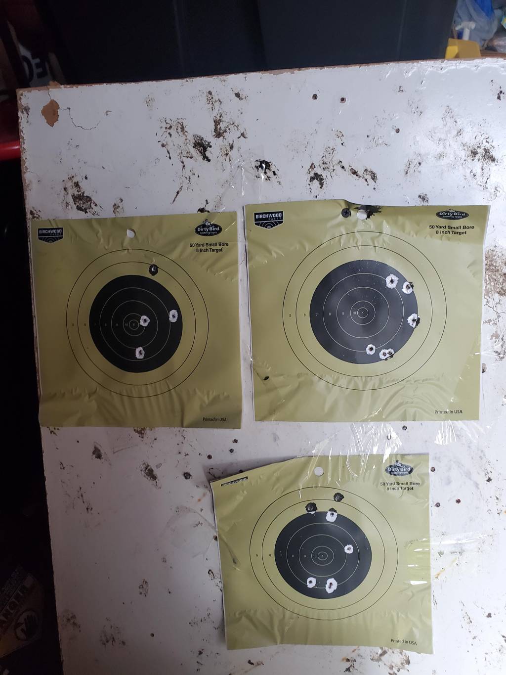

I removed the Hammer and went back to the original center point and I managed to get this...
not that bad, so why Hammer is shooting 10"+ down at 20 yd? maybe like Moog recommended "use a lower mount". So I tried the center point mount rings and the hammer... no luck, the hammer diameter is way to big it rest on the barrel instead of the rings.
Now that MScottLeeman and Scotty1 said droop barrel I took a look at it and yes, it looks down, the barrel is not completely straight
Remember I'm a newbie and I thought it was kind of normal hahahah so when MScottLeeman and Scotty1 said droop barre l did a research but didn't find why or how to fix it, but I did find a possible fix (Not a professional one)
I reinstalled the Hammer and max out the lever screw (don't know if thats the right name) on the back of the hammer mount, cut a couple of aluminum cans strips, folded in half and lined with electrical tape, I place those two shims on the back Hammer mount. it kind of worked.
I just took the pictures and realized how bad the shims looks haha. I didnt finish zeroing the scope, had to go pick up the wife.

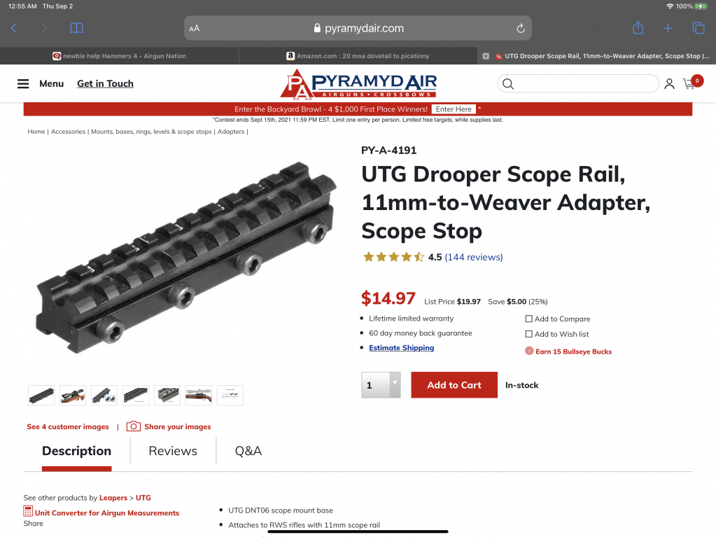

Hey Scotty1, no offense taken, I just started, I know my equipment isnt the best, by know Im trying to keep secret to my wife that this not so good scope was 80$ plus the rifle, pellets, and now I suppose I should get a dovetail to picatinny, that is to adjust the back of the scope right?
I have a Hammers 3-9x40 that's been on 4 rifles now and so far no issues at least 4 me although I know shooters who've had theirs. Poke around for what you can find on barrel bending. Never done one myself but by the side view of your rifle, that barrel has a downward bend in it.
Definitely NOT the right way but I know a guy who does it the redneck way. Sticks the barrel in the fork of a tree and yanks on it a couple times, takes a few shots, then does it again til he gets it where he wants it. Definitely not a way I'd recommend but search the forum for barrel bending on a springer, very carefully do it and your problem should resolve itself and you wn't need those shims.

I had the same problem at first. After watching you tube videos I found that almost every securement screw was very loose. After tightening them I was able to zero it perfectly. Not saying that's your issue but it did fix mine
