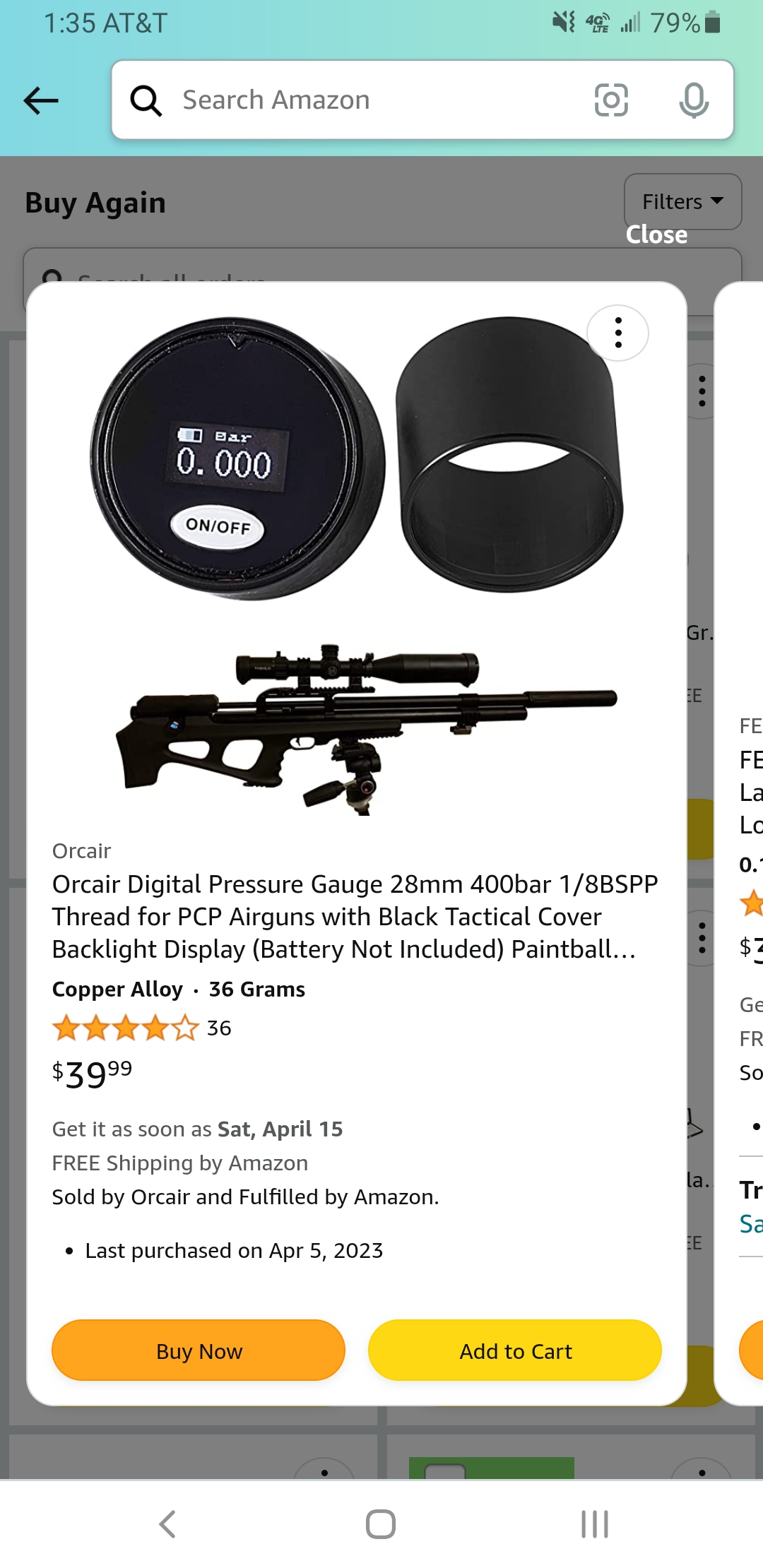

Yep, they are all the same, same price on Amazon and overnight delivery for me. They do fail, but they are 'cheap' enough to have a spare. No reason to have one on your Bottle. These suckers DO chew up batteries, I buy they by the dozen, batteries that is, but I've got several Mavericks.
