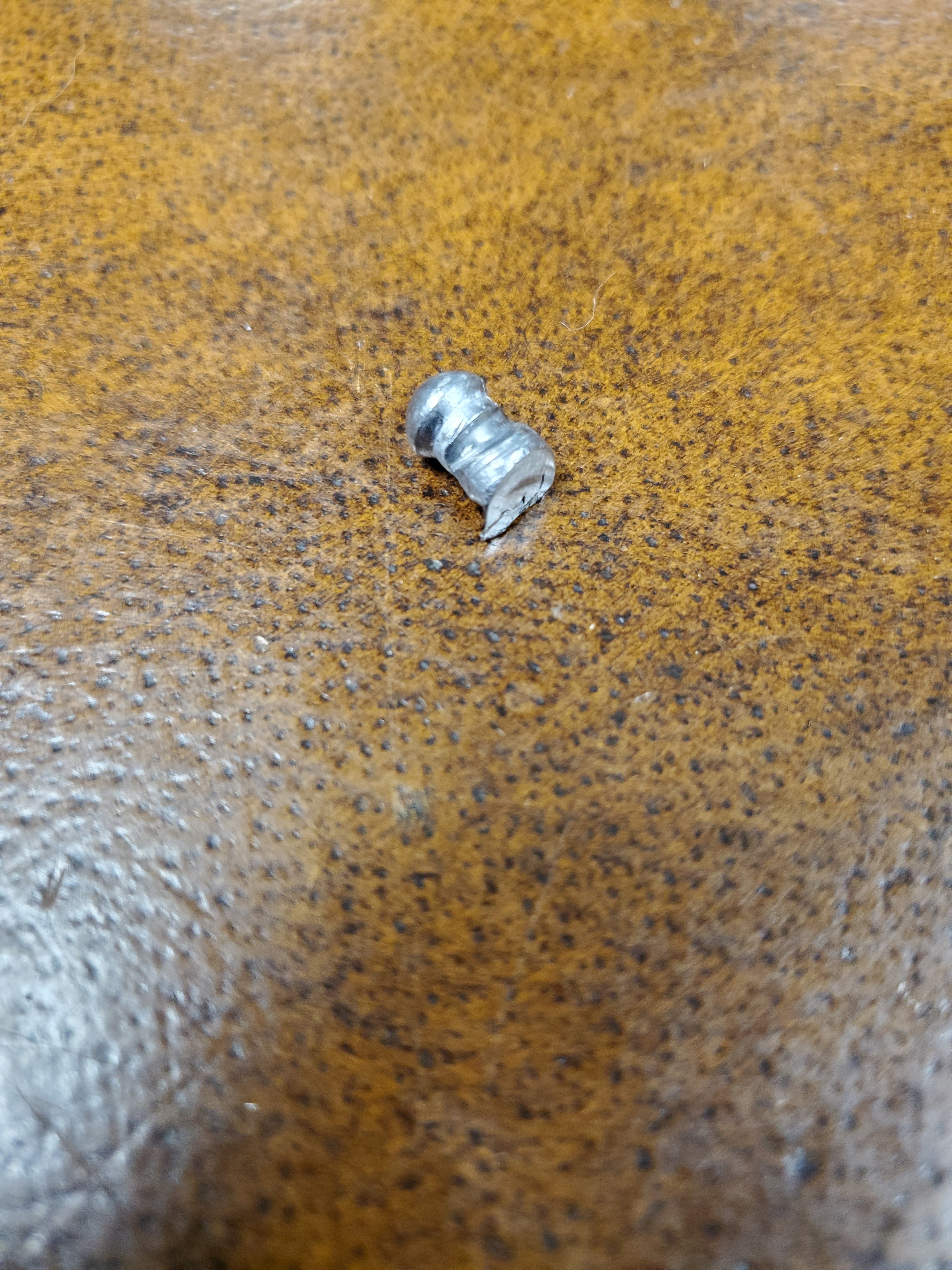

Success!
Kudos to Jacob @ AOA.
I thought I'd share this fix in the event another member encounters this problem.
Jacob said that since the magazine is steel and the pellet of course being lead, tap the side of the mag with a short dowel and hammer.
I did just that, and the pellet sheared. The mag then came out, allowing me to push out the second pellet with a dowel.
