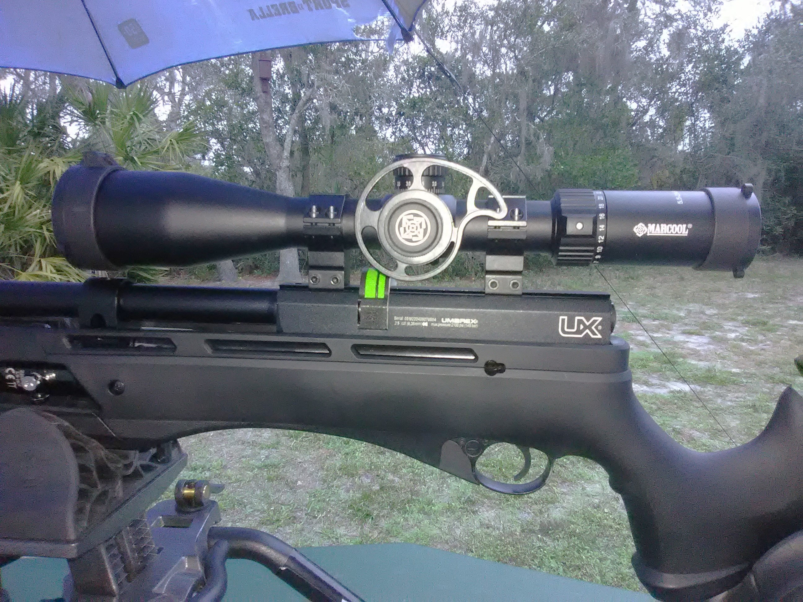

Budget for scope? Benjamin Trail NP XL .22 came with CenterPoint (Crosman's scope brand) 3-9x40AO, very impressed with quality/function for a bargain priced scope. Marcool 5.5-25x50, slightly more, but clarity blows me away. $250 plus range is Vector Veyron, own 7, need I say more? WM

Budget for scope? Benjamin Trail NP XL .22 came with CenterPoint (Crosman's scope brand) 3-9x40AO, very impressed with quality/function for a bargain priced scope. Marcool 5.5-25x50, slightly more, but clarity blows me away. $250 plus range is Vector Veyron, own 7, need I say more? WMView attachment 515495View attachment 515497

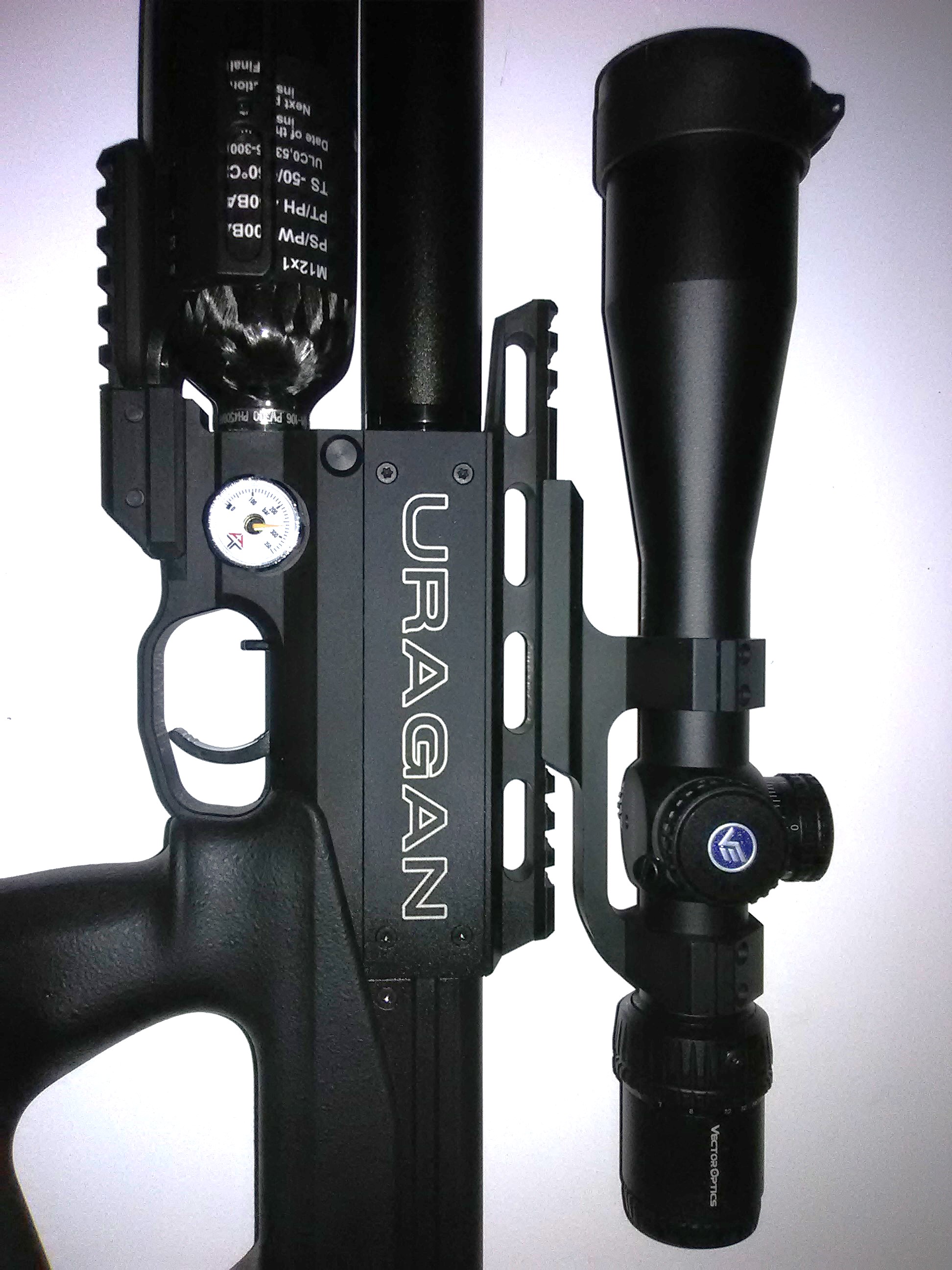

No, that's the only model not liked. Started with a 3-12x44 (30mm 1/10MIL) for $120 (Dvor closeout.) Shoot dime-size circles @ 50 yards and 12-power didn't cut it. Remaining six models, in FFP and SFP, are 6-24x44 (30mm 1/10MIL), as pictured on Uragan. Super sub-compact and lightweight, clarity and smooth functioning are unbelievable. Last few were from Krale (Netherlands) Optic Department. SFP 6-24x44 with IR (six red shade center dot) for $185, $211 to-my-door. Here's original 3-12x44 on latest PCP, Snowpeak M60B .35, with cantilever one-piece Marcool mount since super-subcompact size can affect proper eye distance. WM
I hate buying Chinese, but the Vector Veyron is an excellent scope, especially for the price.
