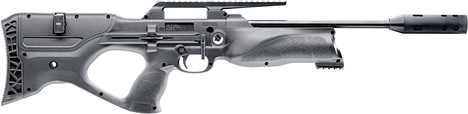

So here's my question: The rifle was pictured on the Krale site with a Picatinny rail. All the photos showed it with that rail and the description clearly stated the same. When I opened it, I noticed it had an 11mm dovetail rail on it I've got an email into Krale to find out what the deal is with that, but I'm wondering if I shouldn't make a big deal out of this. The only accessories I planned on buying for the rail are a set of scope rings and maybe a tactical flashlight mount (if it will fit). I plan to put a bipod on the underside Pic mount. All my centerfire and rimfire rifles have dovetail scope mounts, and in fact, I only have one scope on any of those, so it's not like I'm committed to a pic rail other than for the more tactical look, which isn't really that important. So it's not that big a deal if the Walther has a Pic rail or a dovetail, but I'm just wondering if there's something else I should be aware of. The Reign certainly isn't powerful enough to worry about scope movement from recoil, so other than possibly more flexibility with scope positioning with a dovetail rail, does one rail style have an advantage over another? I don't know what Krale will say, and I know I can buy an inexpensive dovetail to pic rail adapter if need be. What do you more experienced PCP shooters think?

Does the gun you received have an elevated rail like the one in this photo, but it is an 11mm dovetail rather than Picatinny? Does that rail connect to an 11mm dovetail on the gun?
If it is a separate part that can be added on I bet they will send one. Also you can buy an adapter that is picatiny on the top and dovetail on the bottom. Such adapter will basically convert it to picatiny. Finally the reign is not regulated. You really should invest in a chrono if you haven’t already so you can more easily find the sweet spot in the fill pressure. I’ve seen some videos and if I remember correctly you will be best off only filling the reign to like 2800-3000 psi and shooting 2-3 mags and refilling back to 3k
Correct - the one I received has the elevated rail but with an 11mm dovetail. It looks like either a long or short pic rail would screw onto the dovetail rail.

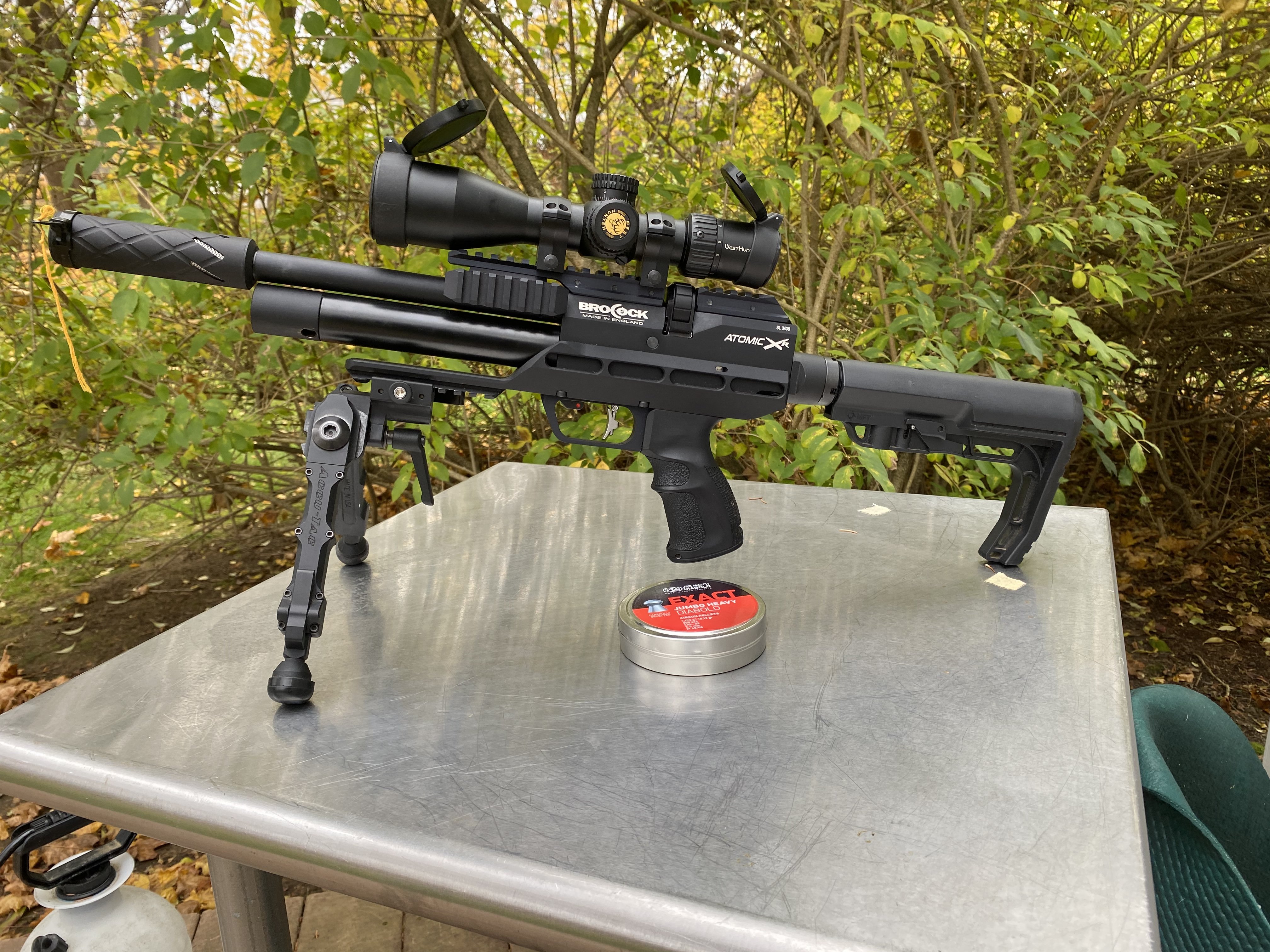

Yep, at the very least I'd like to know why I didn't get what was pictured and described. If there's nothing they can do, I won't push it. Like you say, the dovetail is fine. Thanks! NICE Brocok! Maybe someday... ;-)
