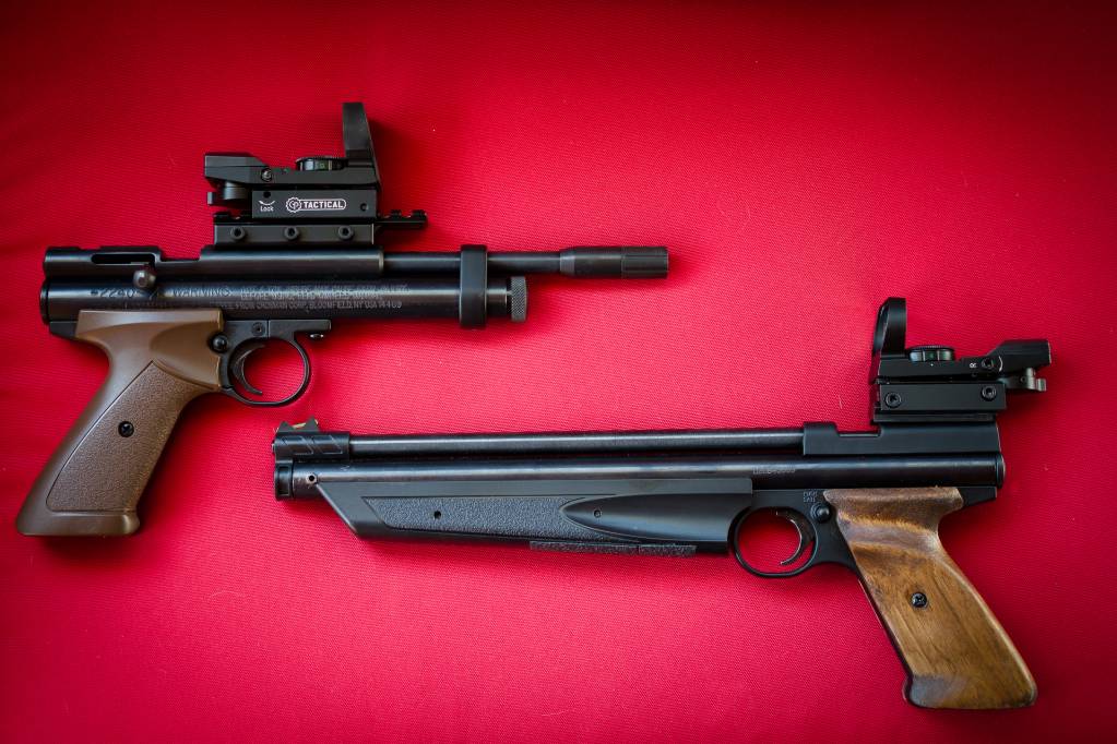

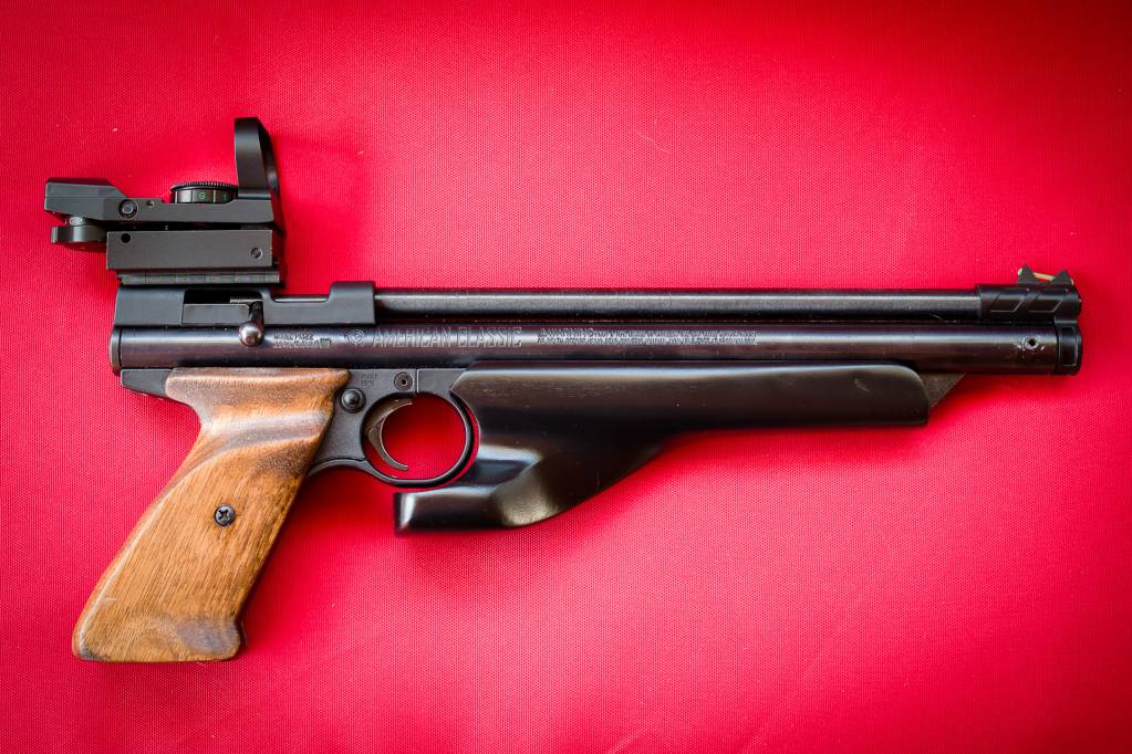

Jsaras, nice pistols. Thanks for your feedback. What is the bottom pistol, the one with the unusual pump arm? Have you ever notice that your point of aim changed with the 1322 when the pistol starts to get hot from the sun, say 95° or hotter. I've been told that temperature affects the 2240 which makes sense due to the Co2 cartridge, but I'm curious about the multi-pump Crosman like the 1377 and 1322 .. Thanks again !
