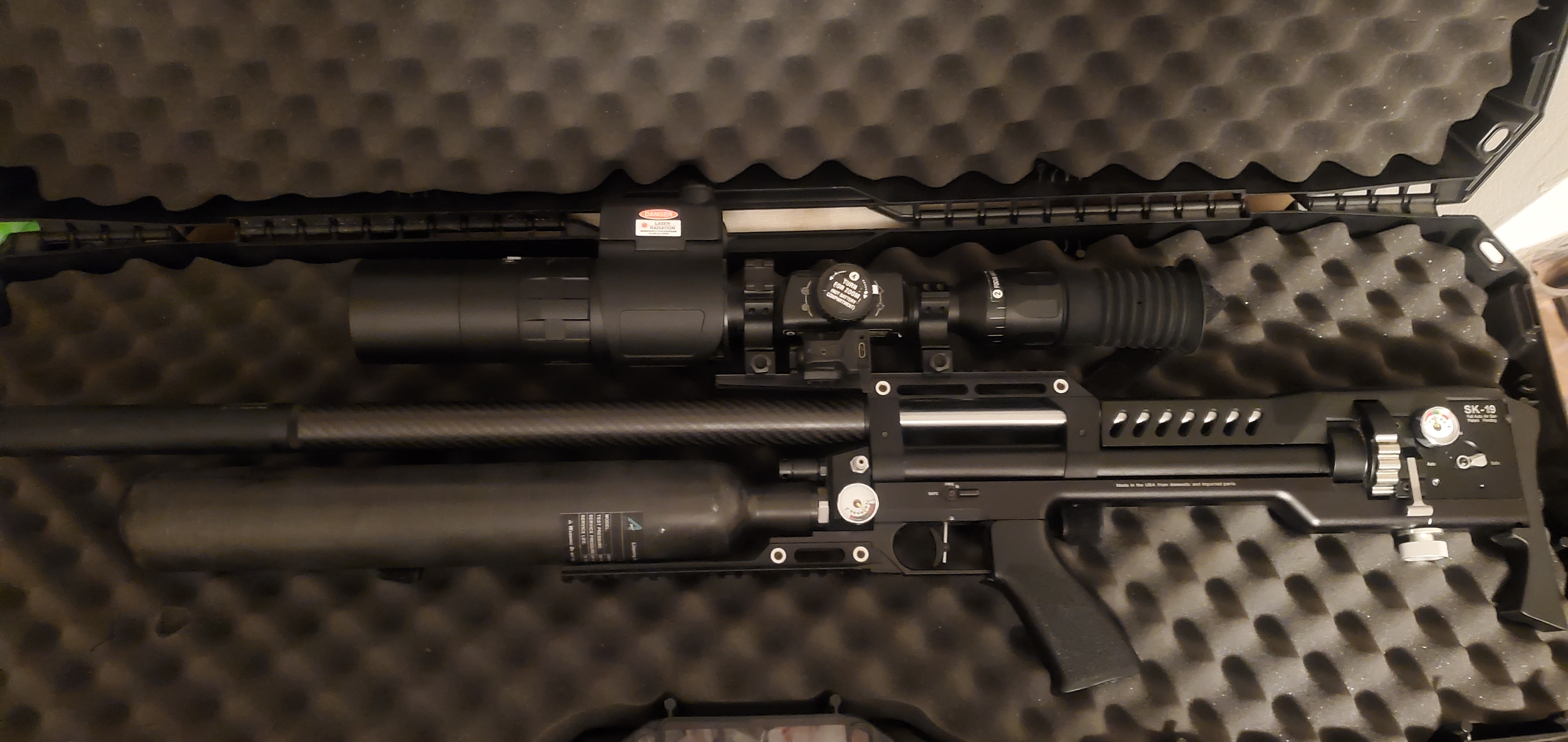

Does my sk19 looks similar to the rattler?
Does the bottle make my butt look big? 🤔
