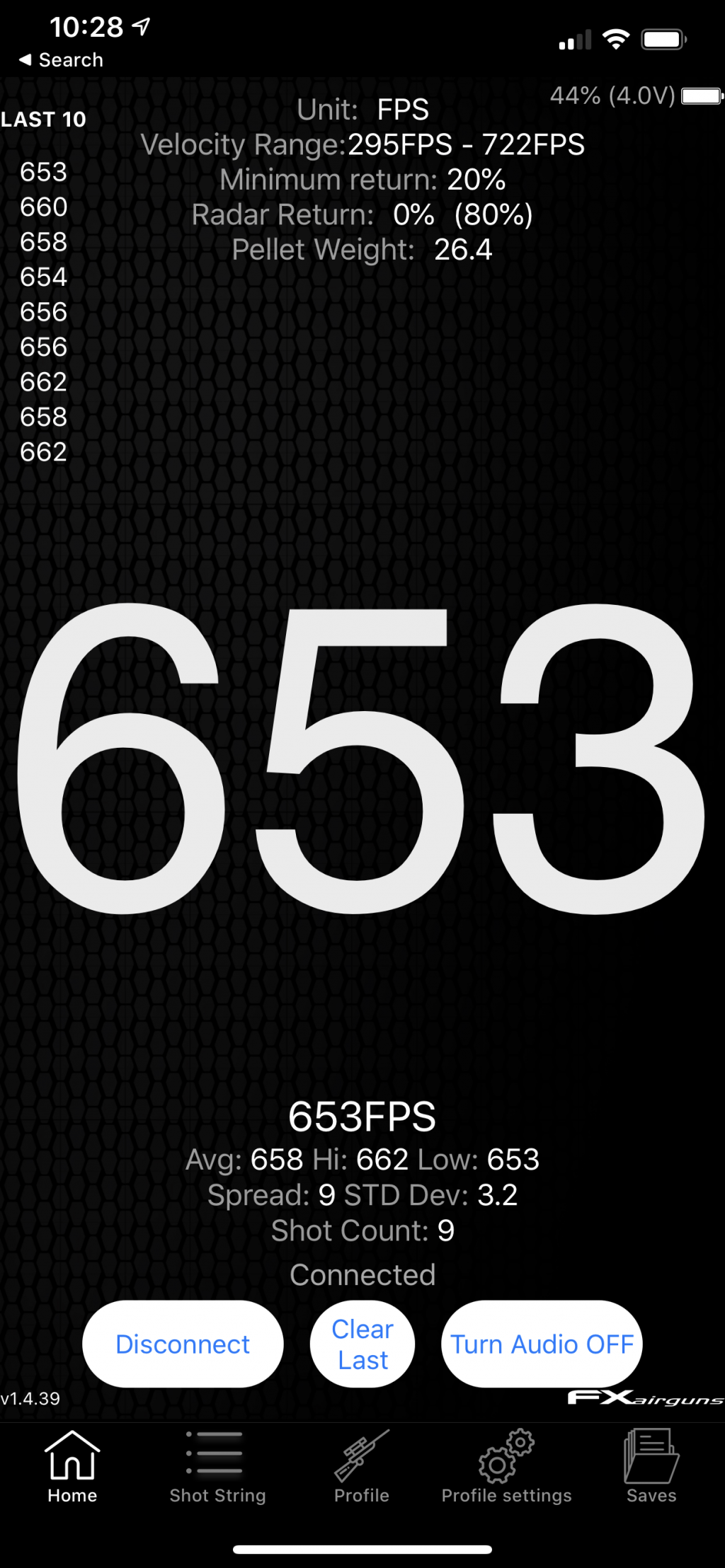

Think I found another way to lower deviation! I was retuning for lower power again, and getting frustrated again! Then I notice something, if i shoot quickly my deviation goes up! I also hear the regulator working filling the plenum. So I paused and thought about it then count at least 10 between the shots and BAM! Spread of 9 and deviation of 3.9 and I didn’t change a damn thing! DOH!!!! This could if saved me hundreds of pellets and frustration!!!!!
moral of the story is be patient and give it some time between the shots so the regulator can do its thing, think this is more important at lower power range. Hopefully other find this helpful and save someone some frustrations.
